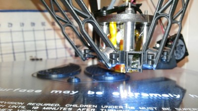

The new hot end bracket has these short metal rods that attach everything together. One of mine is slipping, the other 2 seem stationary or to have a tendancy to slip toward the fan which blocks them from moving. I first noticed it after it had come apart. I was able to push it back in with my fingers and am now monitoring it.
I had been running the machine at 275% for at least a few hours before i noticed this.
Other than running the machine slower, anyone got an idea about this?

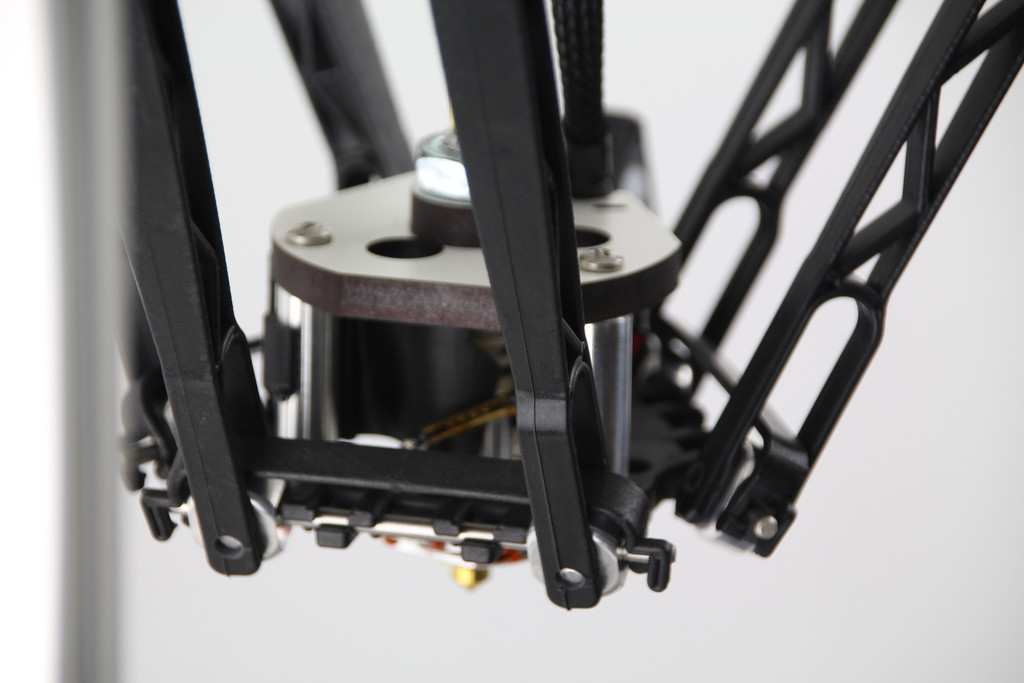

others are having same issue with the v2 platform axles walking out, see this thread...
http://forum.seemecnc.com/viewtopic.php?f=60&t=4944
my suggestion to fix issue was...
I think you could drive some short #4 self taping screws in at an angle between the little tabs that grab axle and the axle itself to prevent axle from walking out...
I have not tried this, but it is how we fasten our CF arms to the v2 platform.
Look at this picture to understand what I am talking about.
http://www.tricklaser.com/Carbon-Fiber- ... M-CFTX.htm
(the second picture on product page shows install information)
let us know if this works, I have heard others are having same problem with new v2 platform.
the screws are 1/4" long
we use these
http://www.mcmaster.com/#93406a106/=rihwng

Hi All,
Just confirming the same issue here - I've been manually re-seating the metal rods on the hotend as they slipped with the massive amount of printing I've been doing lately (see - lightsabers!)

I had that same issue on my V1 Rostock MAX, I just printed up some little corner brackets to keep the rods from moving out, and also hold LED's.
Re: Stock Hotend bracket rod slipping
If the rods were moving in the v1 platform assembly, that just means the screws holding the halves together weren't tightened or the u-joints are frozen to the steel shafts.

I did reach out to support, this is what they said:
Quote Guanu:
we are working on a new platform design but for the time being, we suggest a drop of super glue gel (thick superglue not the thin stuff) on the inside clips of the platform (the clips the ujoints press against, but not on the ujoint side if that makes sense, you want the glue on the inside so it doesnt reach the ujoints)
So it sounds like they're aware of the problem and making progress on a long term solution. I also appreciate the specific instruction on gluing.

Posted on a different thread:
http://forum.seemecnc.com/viewtopic.php ... =10#p39155
I applied a bit of white lithium grease to the outsides of the bearings on the metal shaft (including where they contact the effector), and the slipping has completely stopped. So far nearly a month since my "fix", and they haven't moved a bit.
Dave

dgriff wrote:Posted on a different thread:
Dave
This works!
I used this "grease" http://www.amazon.com/gp/product/B001JT8ELS/. (its a powder in a squeeze tube... wtf?)
I noticed in applying the grease that the one axle that was not slipping was already held in place by a screw, Gaunu why'd you place a screw in just the 1?
