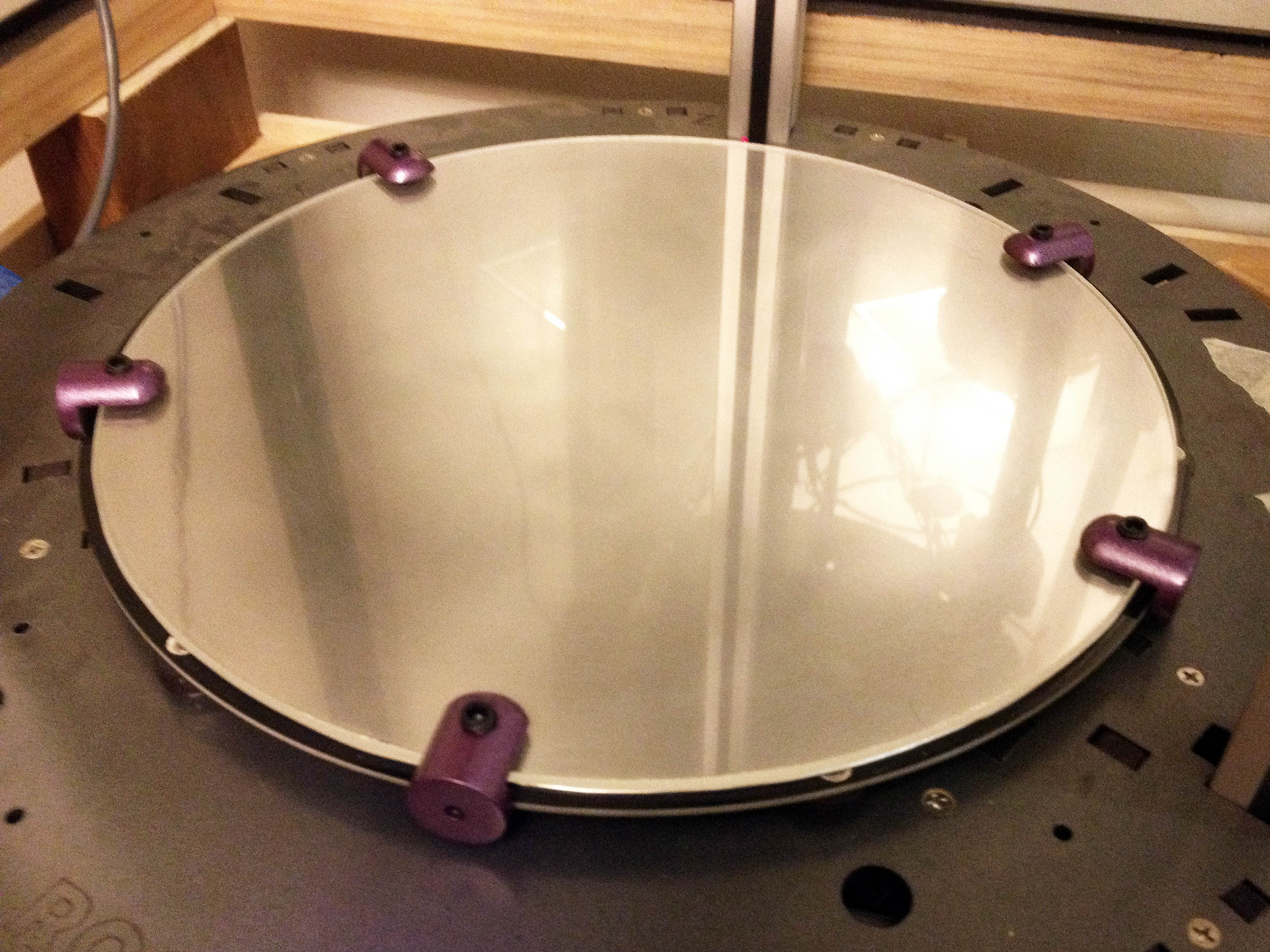

It seems to me that they didn't belong, giving a non-professional look. So yesterday I finally upgrade it

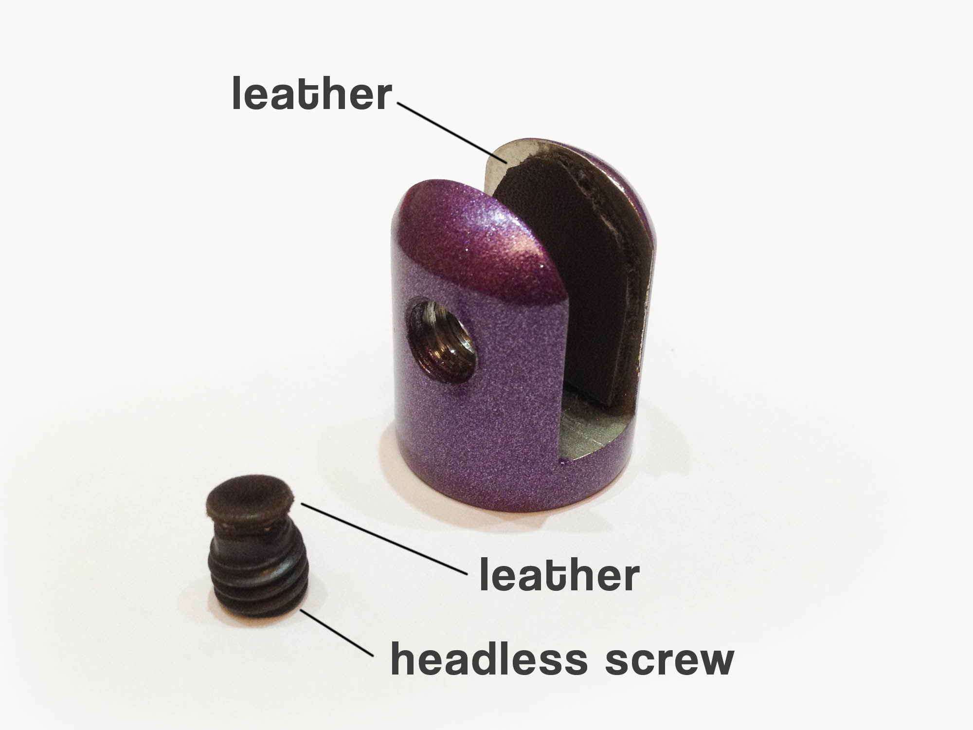

Materials:
x5 glass holder (?) don't know the word in english
x1 primer
x1 random spray paint color

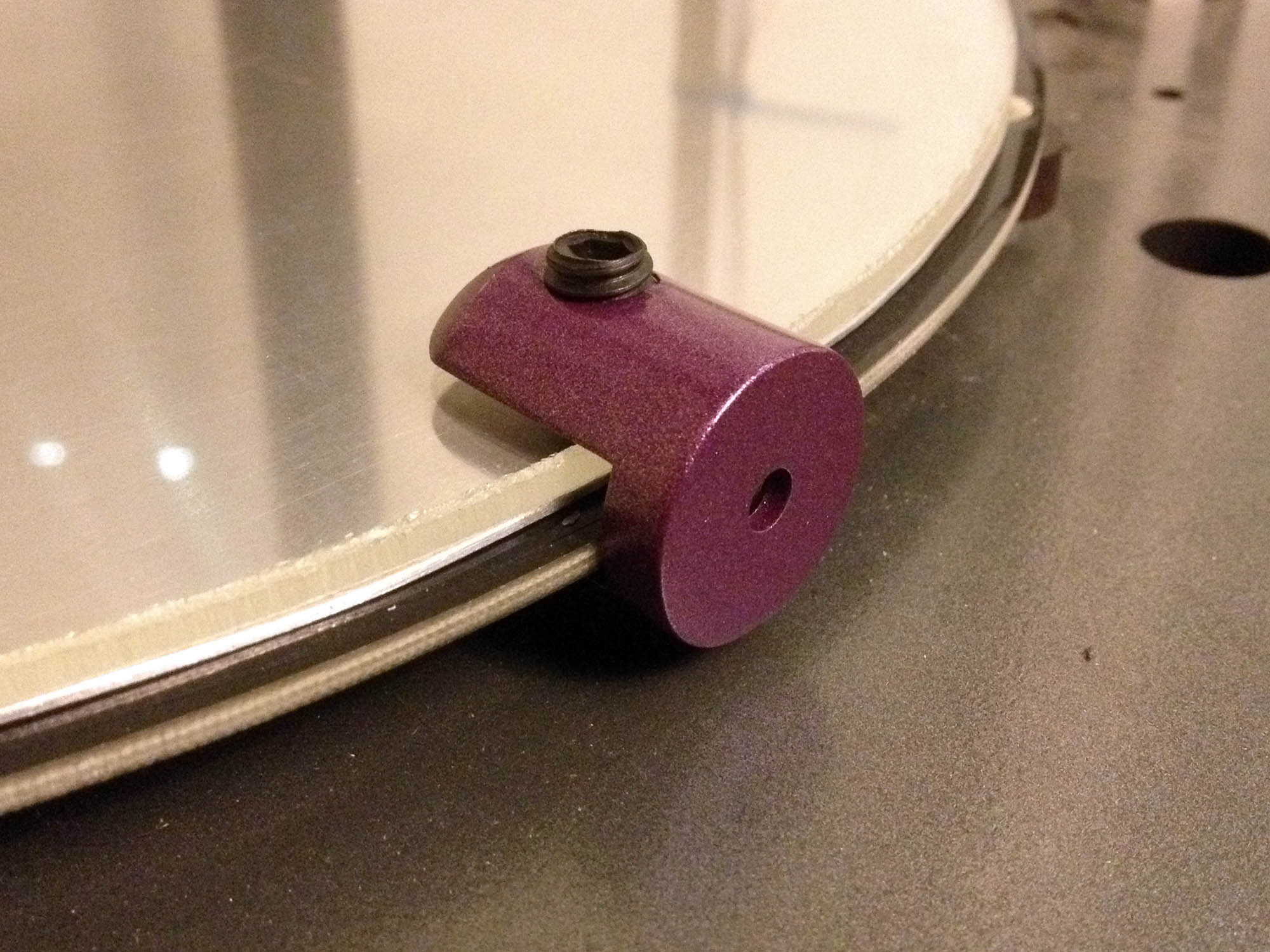

I've used 2 pieces of leather to avoid the screw doing too much pressure to the boro glass.
The tiny leather over the screw was cutted using a paper puncher.
Hope u like it.
