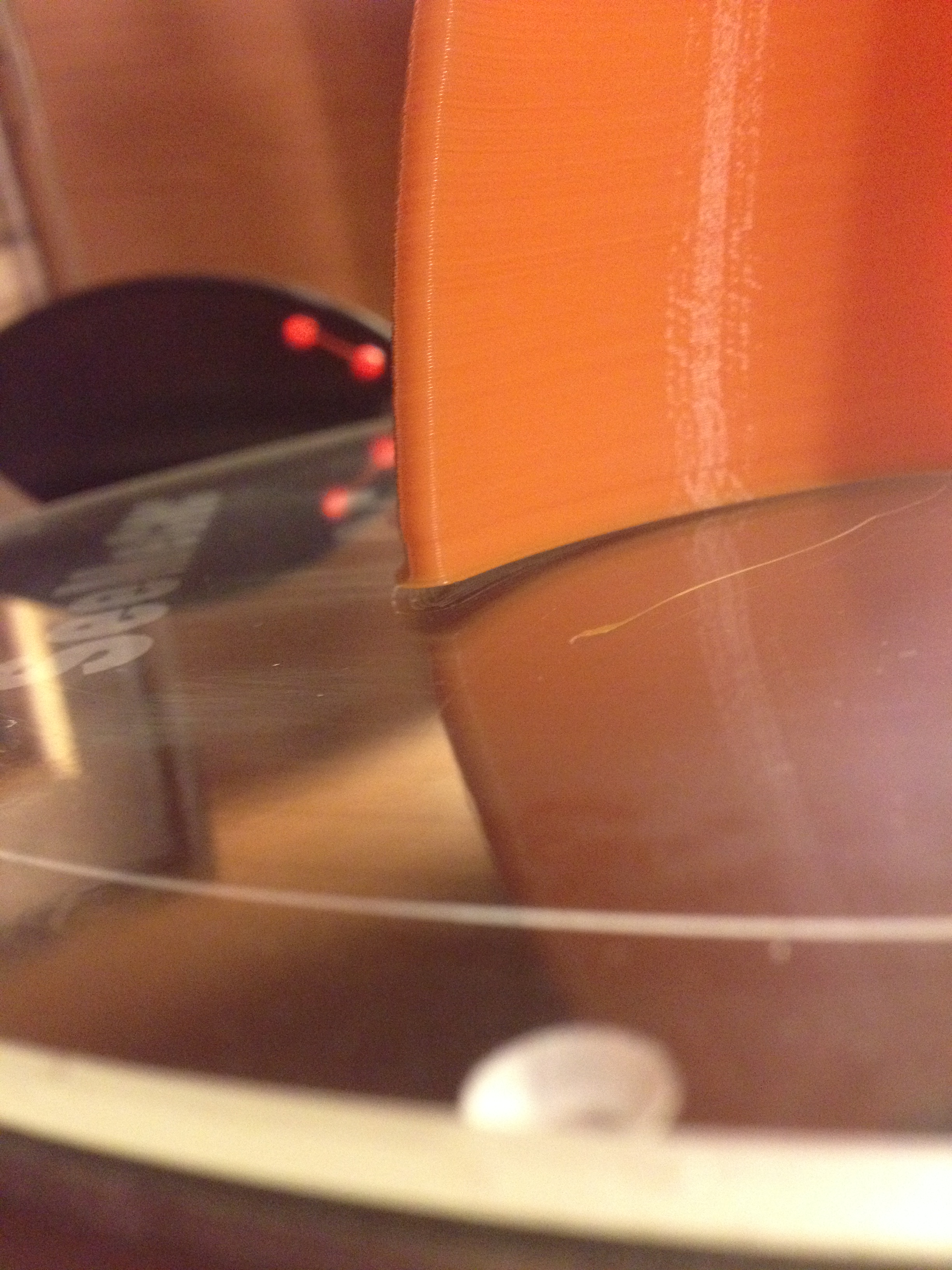

I have the narrow ends of my PLA part curling up from the bed after somewhere around 16 hours of printing using BED HEAT. The part takes 24 hours to print, so I want to get the procedure straight in my head.626Pilot wrote:If using glue, apply when the bed is cold and then warm it. If using hairspray, apply when the bed is warm. In either case, you have to wait a little bit for the moisture in the adhesive to evaporate. Touch the bed to make sure it isn't still moist. Otherwise, it acts like grease instead of adhesive.
Make sure you did your Z=0 calibration with both the heated bed AND hot end heated up all the way to operating temperature. Both the hot end and bed will expand at operating temperature, so if you calibrate with either turned off, you'll get a bad calibration.
For PLA, DON'T USE BED HEAT! It doesn't help. In fact, plenty of "PLA-only" printers are sold WITHOUT bed heat. If you're printing something with fine features and/or overhangs, bed heat will just cause uneven curling and the print will come out looking gross. This is why the Orion has a part cooling fan! If I ever used bed heat with PLA, it was at about 40C, and only so that the glue/hairspray would dry quicker. I'd turn it off after the first layer was down, because I knew it would hurt print quality.
I like hairspray best, so with the Z=0 Calibration done with both BED and Hot End heat on, start at 40C BED heat and turn it off after layer one...correct? (This seems like the best thing to do to ensure better material lay-down as the bed cools)
Also, how much hairspray do you think best?
I don't know what the gap between the nozzle and bed glass is cool, but I do know it is between 2 and 4 folds of paper. That being said, will the first layer apply nicely on a BED without heat turned on, without adjusting Z=0 distance?
Momma told me "You need to work on your Printing"

I don't believe it makes any sense to take measurements while the hot end and bed are cold, so all of my calibration and adjustments were done at operating temperature. I calibrated so that I could barely get a sheet of paper to slide under the nozzle, and there was a bit of drag on the paper if I moved it around under the nozzle. Enough drag so I could easily tell by feel that all 3 positions under each tower were the same friction as the center position. With all that the same I could be sure my z=0 was good and the build surface was parallel to the extruder and the curve was calibrated properly.
With all that done< I can see my first layer is adhering well and is the same thickness across the build surface.

Re: WITS END
Well...only 12 hours in and results are much worse than WITH heat.
Like the first, the first 15 layers are filled, the rest are only 3mm thick wall to the top (around 700 layers).
Started with fan off, then on at layer 15.
Started with bed heat @ 50C then off at layer 5.
Any suggestions?
Any suggestions?

Sharp corners like that on large pieces can be a bear, the usual two fixes (in addition to some sort of adhesive) are Micky mouse ears, put a round tab about 2 layers thick at the base of the corner in the modeling package, or use a "brim" this precludes using kissSlicer.
On heat, you should print the first layer 10 to 20 degrees hotter with no cooling fan on, on subsequent layers set the temp to normal and run the fan, leave the bed at 60 for the whole print.
You can also increase the extrusion width for the first layer if your slicer allows, I've always found Cura to have bad adhesion on the first layer because it uses a very narrow extrusion width.
As to setting Z=0 I do it with a 0.1mm feeler gauge instead of a piece of paper, then add that 0.1mm back on to the final Z Height, with lower layer heights it really needs to be very close to perfect.
