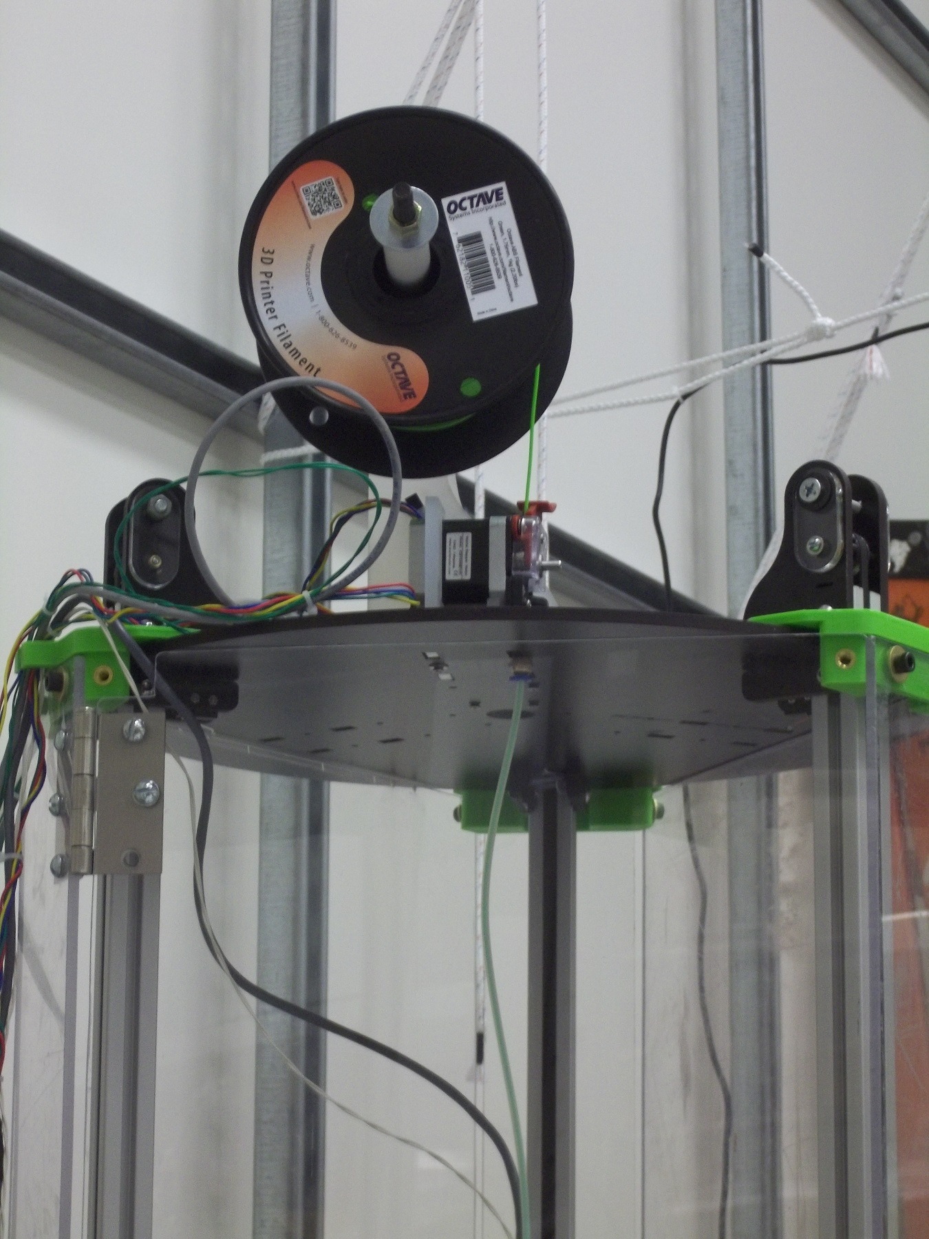

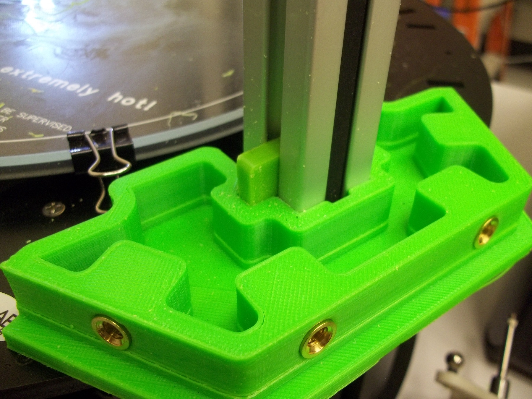

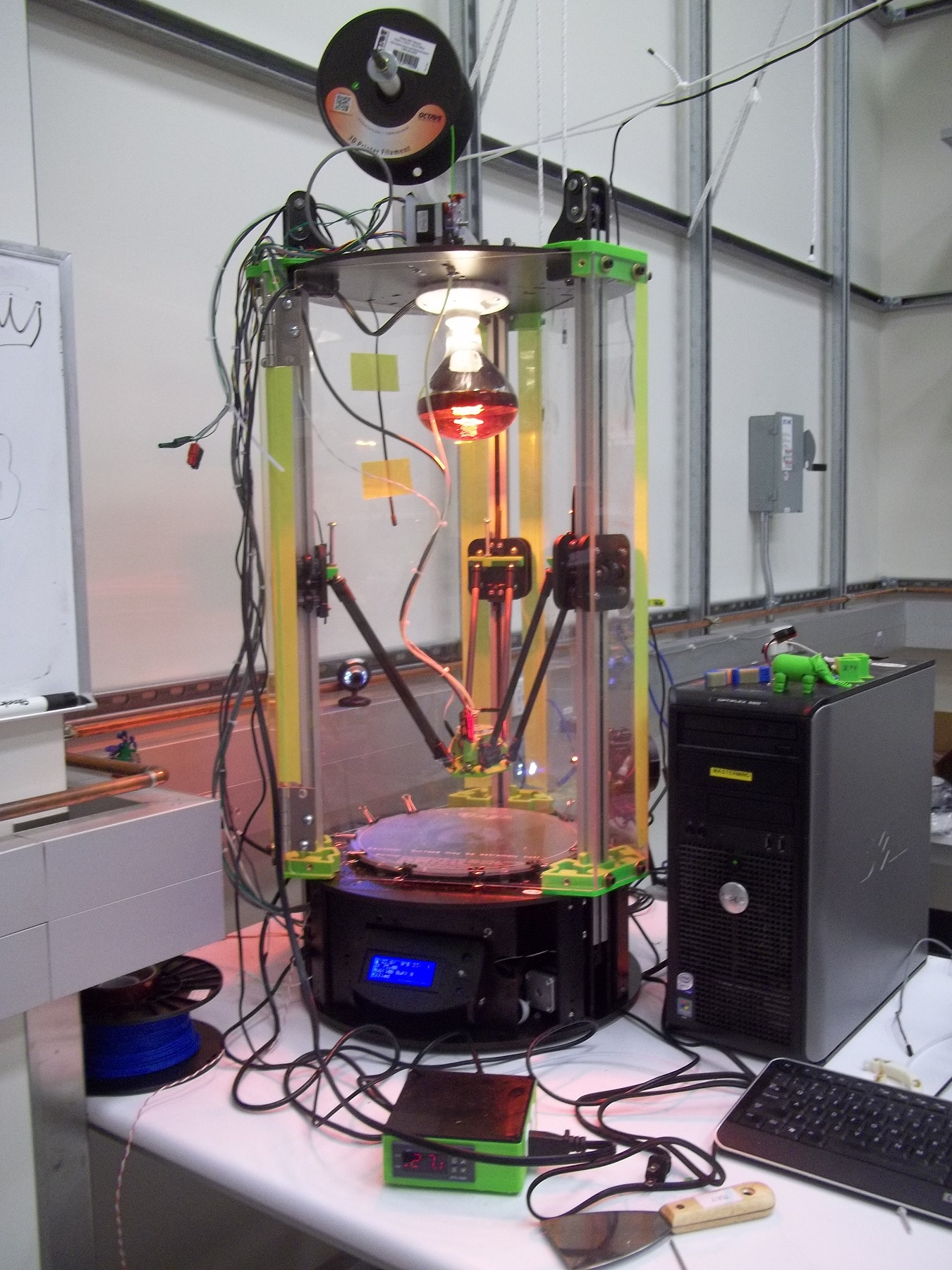

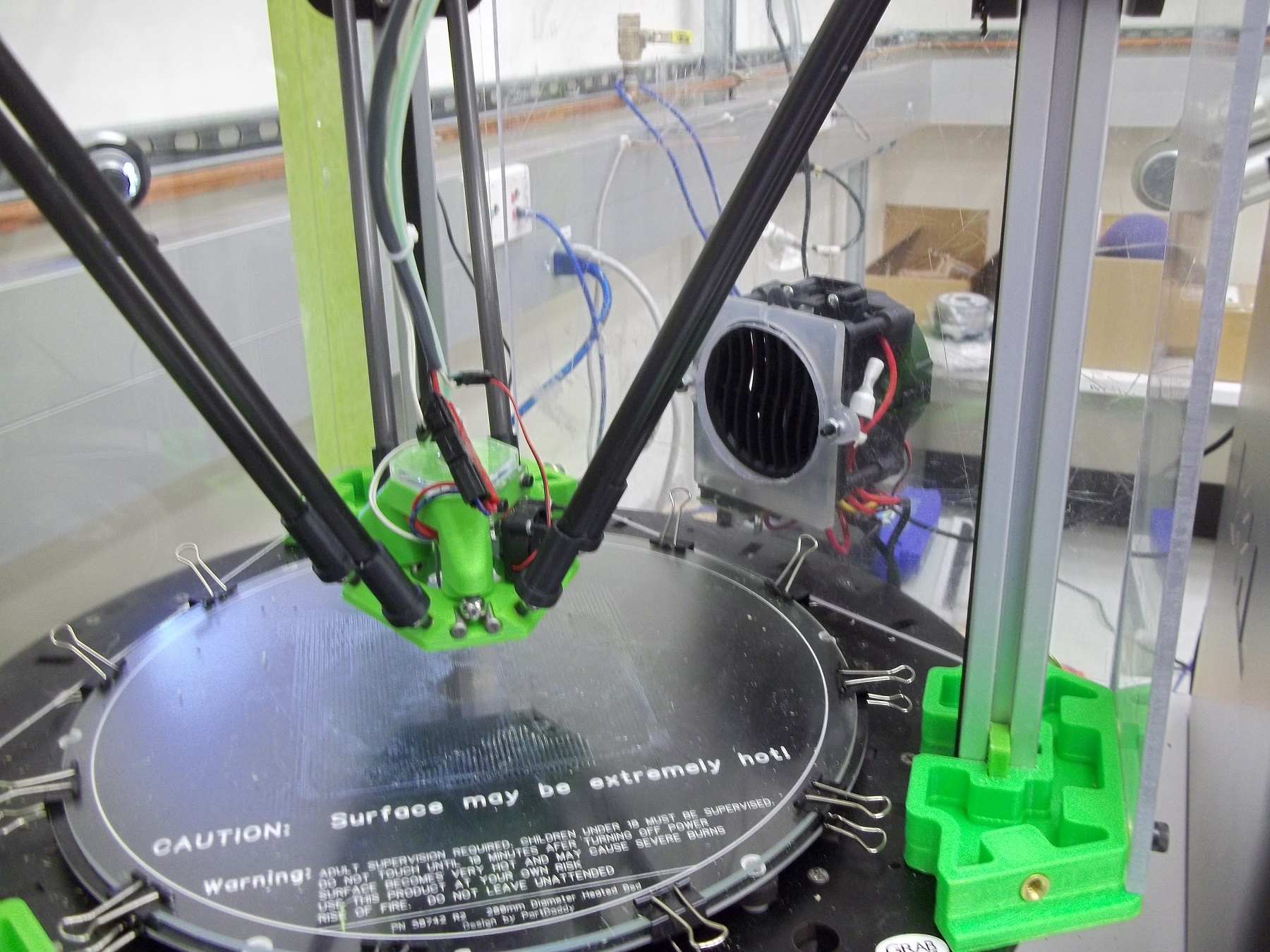

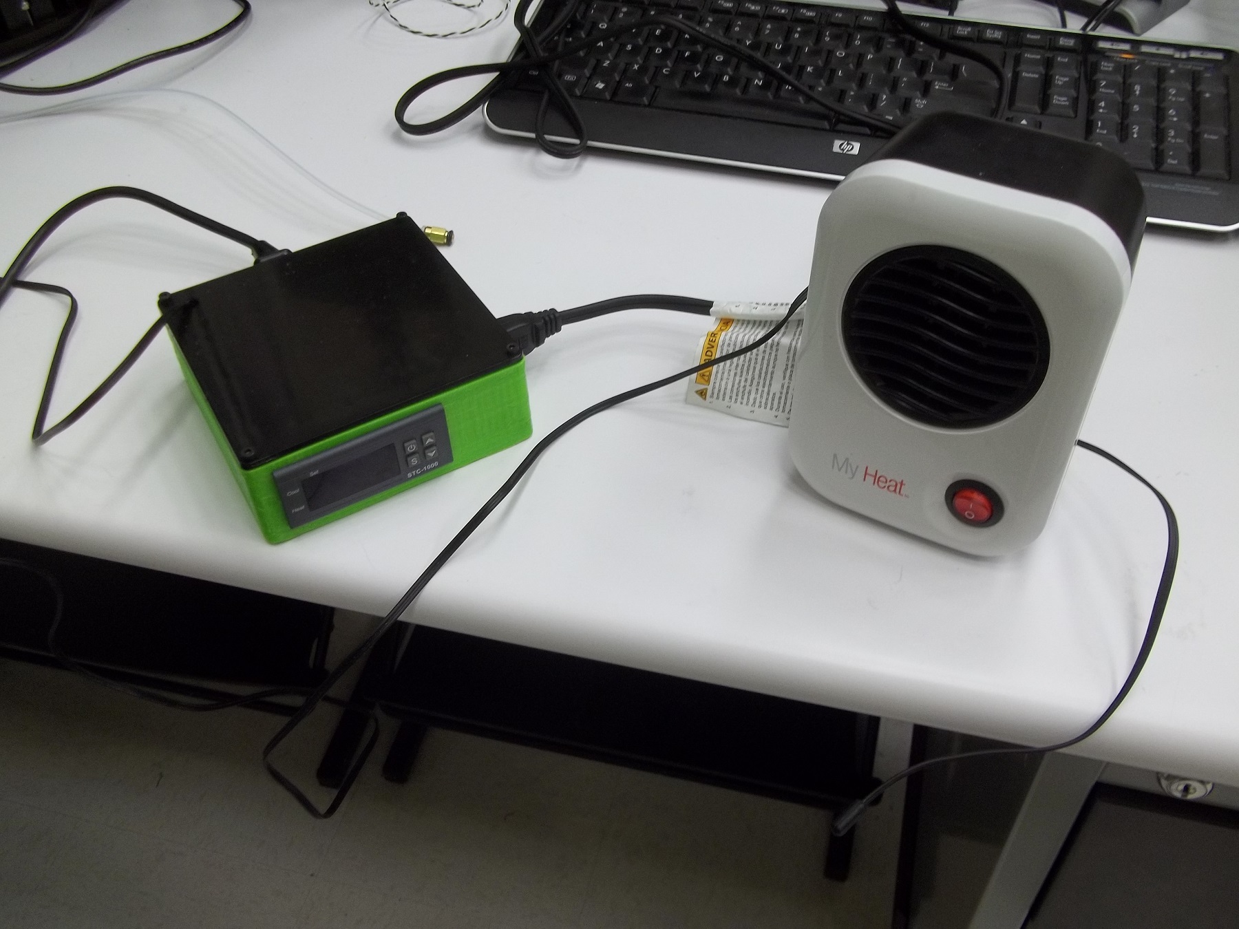

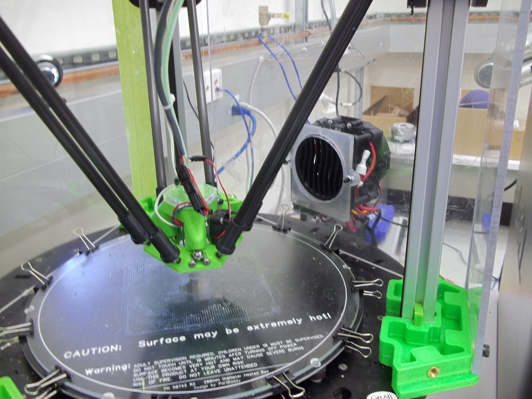

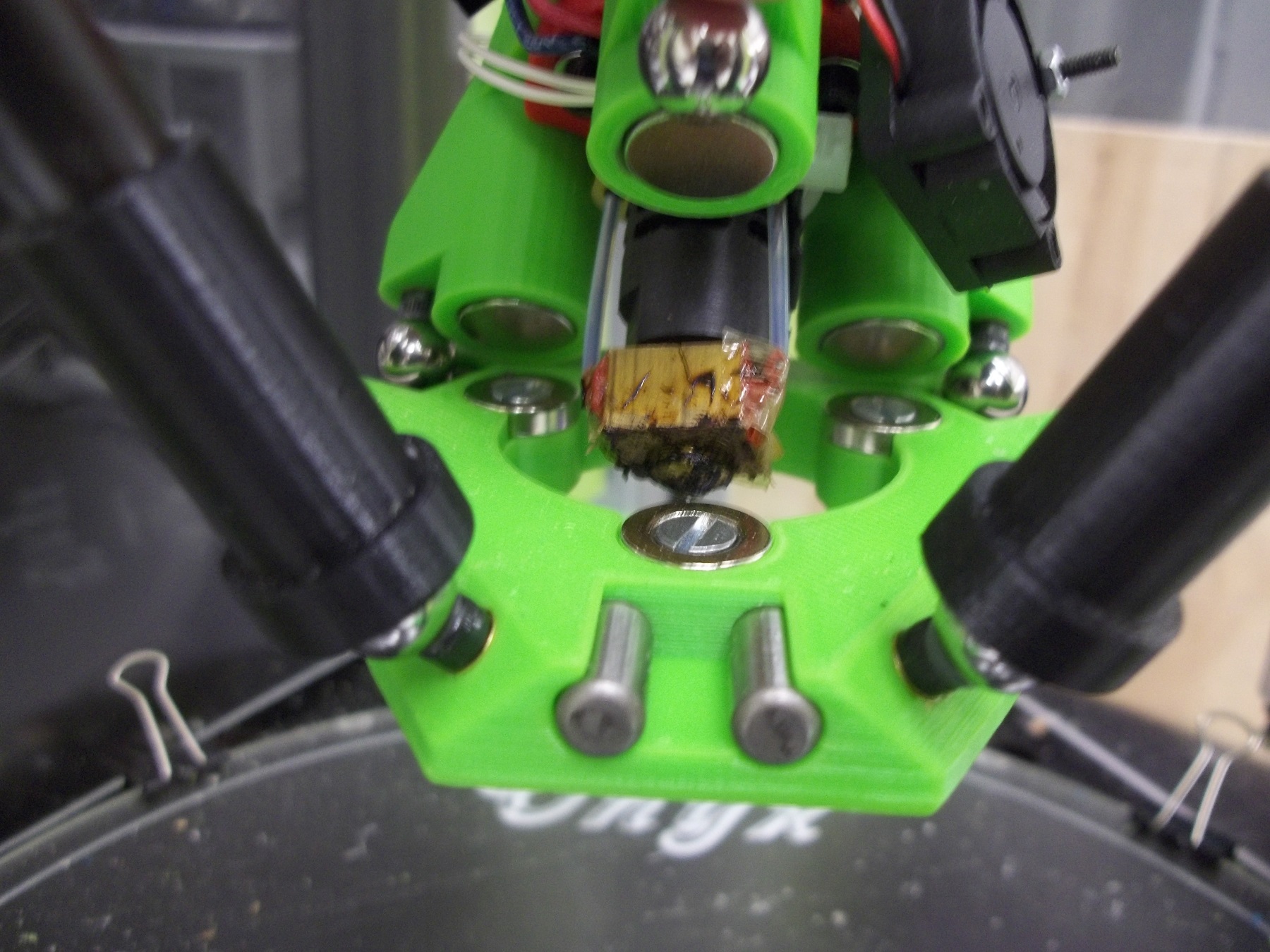

Have been testing a heated enclosure for my Rostock MAX a while back and thought I'd post some details here in case anyone else would find it useful and if anyone else has tried something similar with better results.
Instead of enclosing the entire machine, I added clips that attached to the existing Rostock MAX V1 structure and then bolted polycarbonate sheets to that. I moved the extruder stepper to the outside of the enclosed space, so that no steppers are in the heated environment. The material choice certainly is not great (or even good) for insulation, but hey, if you can't see your delta machine at work, then what's the point? =P
For heating, I tried both a small space heater and an IR heat lamp. I want to try a ceramic heat emitter next, but I think the results will be similar to that for the IR heat lamp. The heating elements were controlled via an STC-1000 temperature controller and powered separately from the rest of the machine. With only the heated bed running, I got an internal temperature of around 25C. My printer's in a rather cold lab space that's usually around 20-21C. Both the IR lamp and the space heater could push the enclosure temperature up to around 42C, though the space in the immediate vicinity of both heaters could get as high as 60-65C. For reference, the Stratasys uPrint and Fortus machines run w/ a heated environment with 80-90C ambient.
I have not yet tried running both simultaneously, and I'm not sure how the lifespan of either heating element will be affected by the temperature controller turning them of and off repeatedly. In terms of aesthetics and efficiently utilizing space, I really like the IR lamp placement, and if I place the temperature controller thermocouple on the moving effector, I think I can actually modulate the temperature with respect to the layer height, which could be really cool, though not necessarily useful.
Suggestions and questions are welcome!

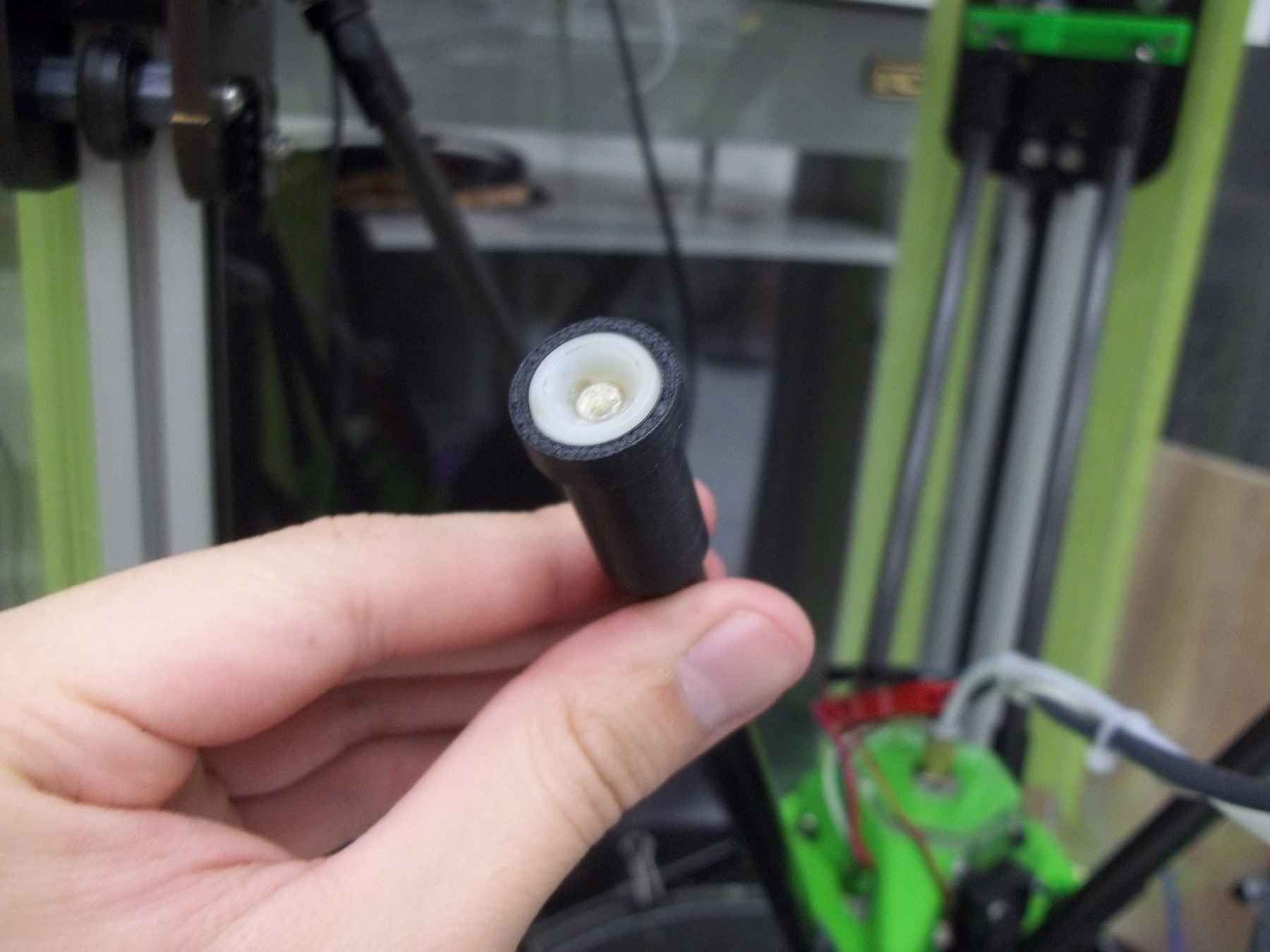

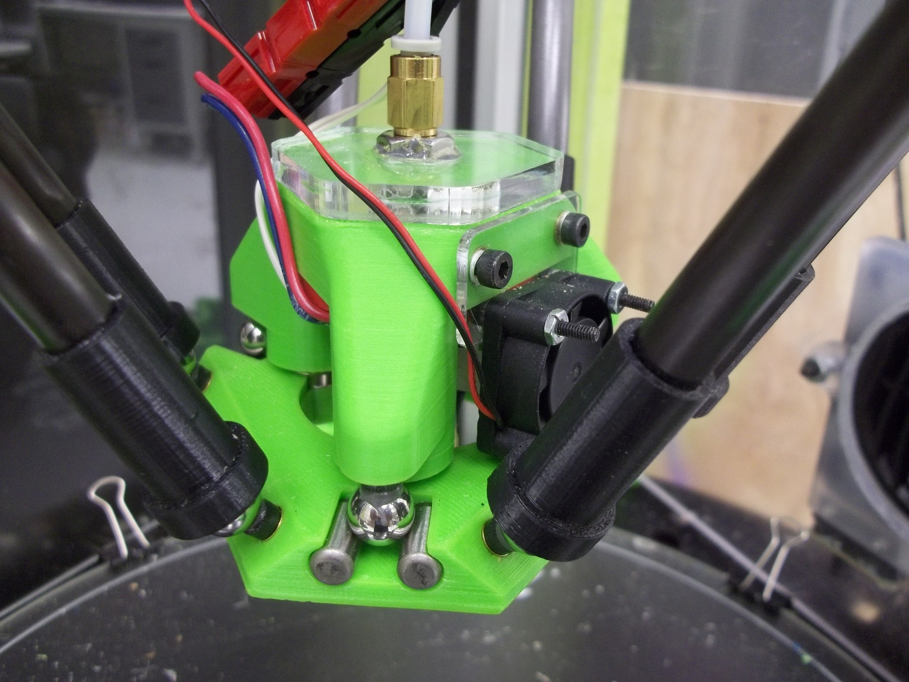

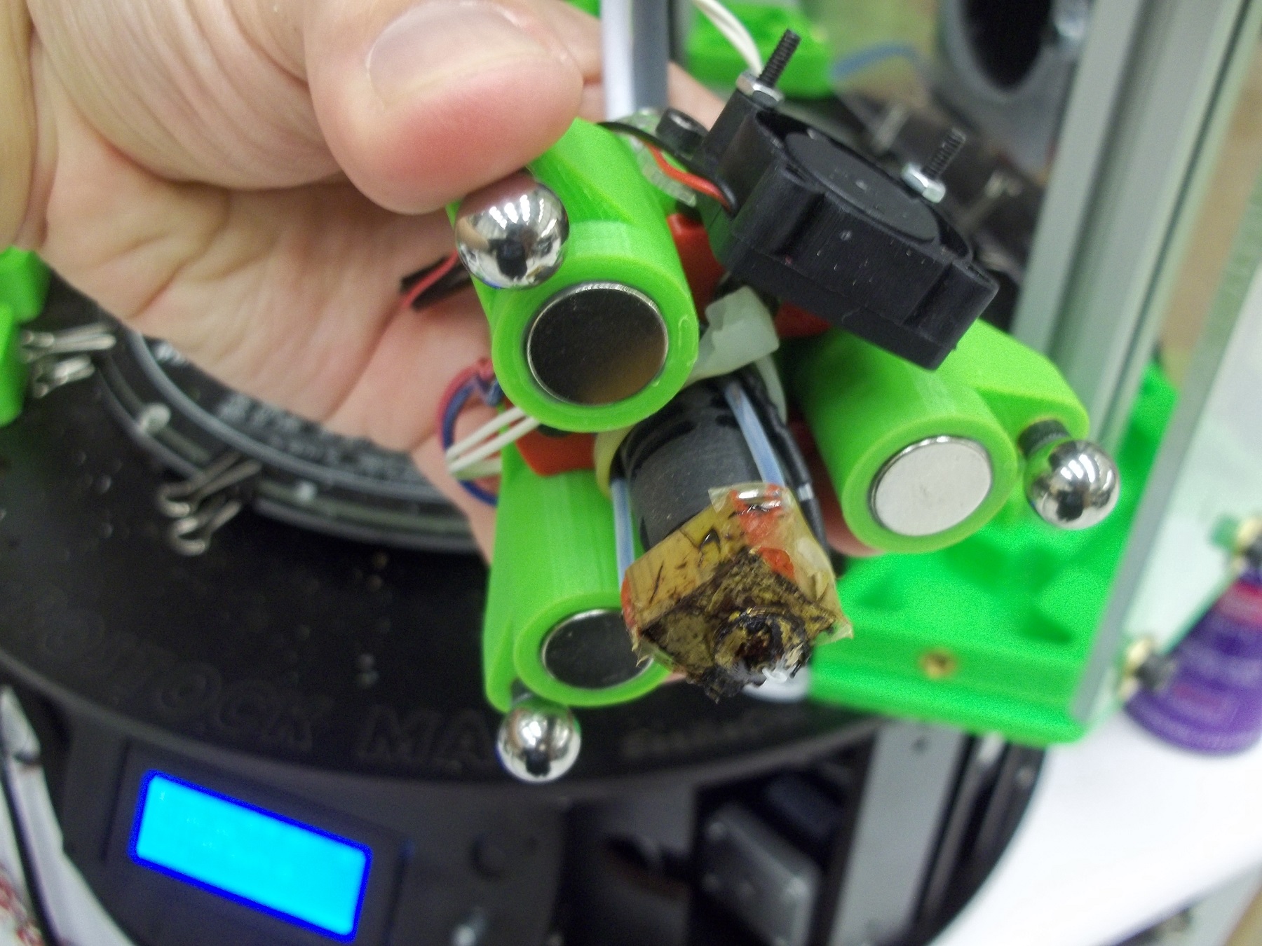

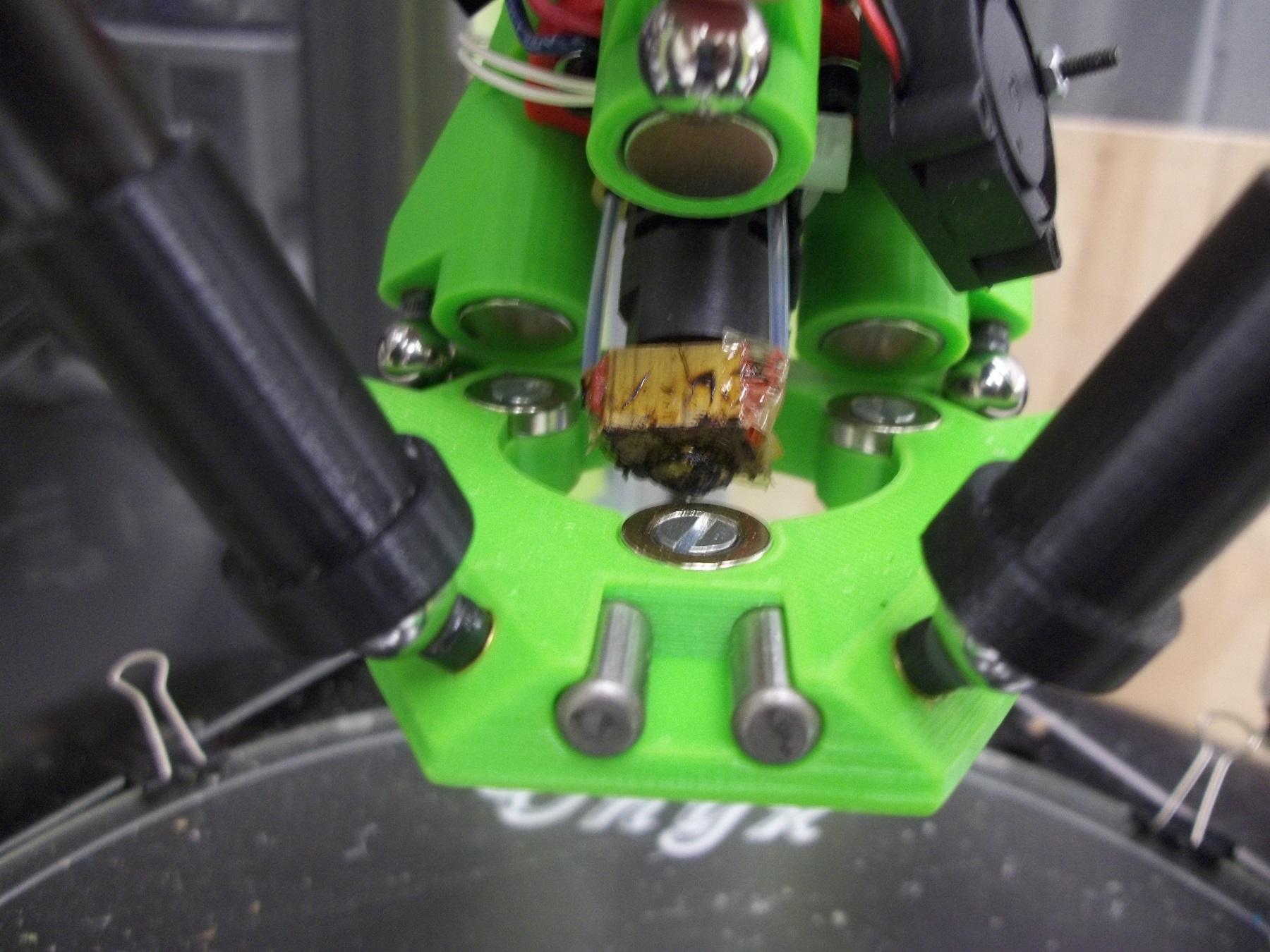

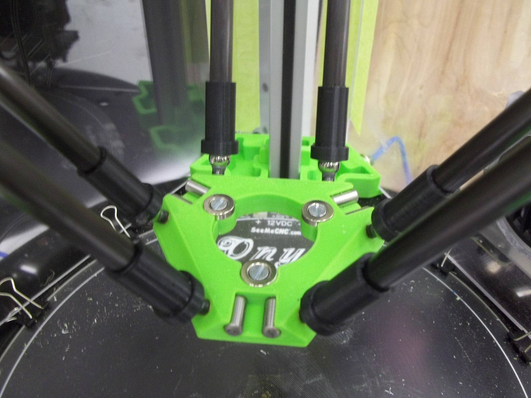

I'm interested in your effector plate / mount you have there. Got any close ups of that too?
Re: Alternative Heated Enclosure for Rostock MAX
I second that one. It appears to be magnetic with a different end cups on the rods and a different effector.McSlappy wrote:That does look really cool! Well done.
Would love more info.
Sure. I detail it a bit more here: http://blog.rymnd.com/articles/rostock-upgrades/, and I had briefly discussed some earlier work here: http://forum.seemecnc.com/viewtopic.php?f=35&t=4433Eaglezsoar wrote:I second that one. It appears to be magnetic with a different end cups on the rods and a different effector.McSlappy wrote:That does look really cool! Well done.
I'm pretty close to giving up on the passive tool-changer. A bit difficult finding that sweet spot where I can reliably disengage the hotend while also ensuring that it'll stay put during long print jobs with fast moves. As is, it's still a nice quick-swap setup that lets me easily swap out the hotend for me dial guage and whatnot

What problems would one encounter if the entire machine was put inside a cupboard?
I am not a great fan of building more structures outside the printer. I think that it is much less of a hassle just to put the machine inside a bigger enclosure if you are not really really tight on space.
WOuld the rambo electronics suffer? Or would the stepper motors overheat?
And would dedicated fans to each motor provide anything?

I think the issue with enclosing the entire printer is that most of the electronics that aren't on the hot end or the heated bed don't really like the 70C ambient temperature that's supposedly the sweet spot for ABS printing without warp (based on how Stratasys does their enclosures). I already have issues with the electronics in the base getting too warm if I run my heated bed at 115C for a while. So, you want as few things as possible inside the heated volume of the machine.
Once you hit 70-80C, I think I remember reading some spec sheets saying that <10% of a part's warping will occur if you maintain temperatures above 70C, so air flow inside the heated volume becomes less sensitive to drafts - although you don't want too much airflow over the hotend itself to prevent cooling, although having the heated volume might allow you to use a fan to improve bridging behavior.
At some point, I'm going to swap out my Rambo for a Smoothieboard, and I'm not going to bother with trying to mount it inside the base - I'm just going to bring it to a little box outside the machine, with its own cooling fan.
A fan on the stepper isn't going to help much if the ambient temperature is 60C+, the point of a fan is to move hot air out of the way to be replaced by ambient air.
One of the nice things about rostock style printers is that the steppers and electronics can be easily kept outside of a heated chamber.

Is the front side of your machine not closed?
I have a very early V1 from the kick-starter, I never bothered with the rap around cover, so my motors are basically exposed to the outside, the XY/Z stepper shouldn't get very hot, they just don't need the high current setting and mine don't, the extruder motor does, but within tolerances.
My electronics bay is closed and I have a 80mm fan blowing air onto the back of the Rambo board which is sufficient to keep the stepper drivers cool.
In my comment I was more referring to the idea of putting the entire machine is a cupboard rather than enclosing the print area, there are substantial advantages to doing the latter.
