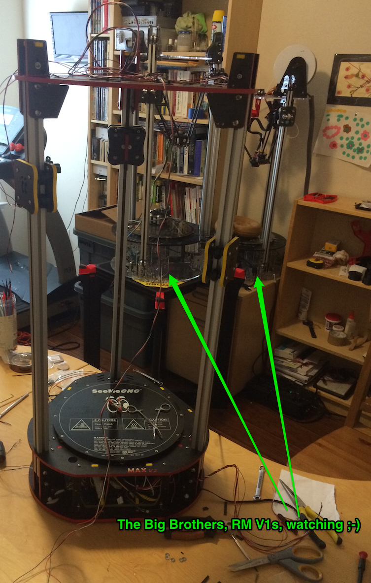

Art's *new* RostockMax V2 (Aka Night Fury!)

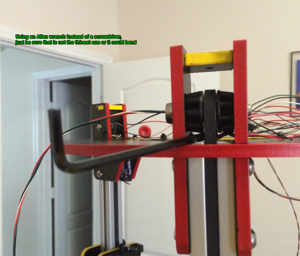

Hey Geneb, I have my own routine for "tuning" the belts without using my mouth at all and feeling awkward
Look!
then
Now, with a single hand you can hold everything together ... the form is very important, your hand should looks very fancy or it might not work! (hahaha)
Once you got the pulley in the place you want, you can use your other hand to tight the screw. Sorry there is not picture, but I used my hand to tighten the screw.
Done!
then
Done!

And sure, have plenty of pics. More coming next week
