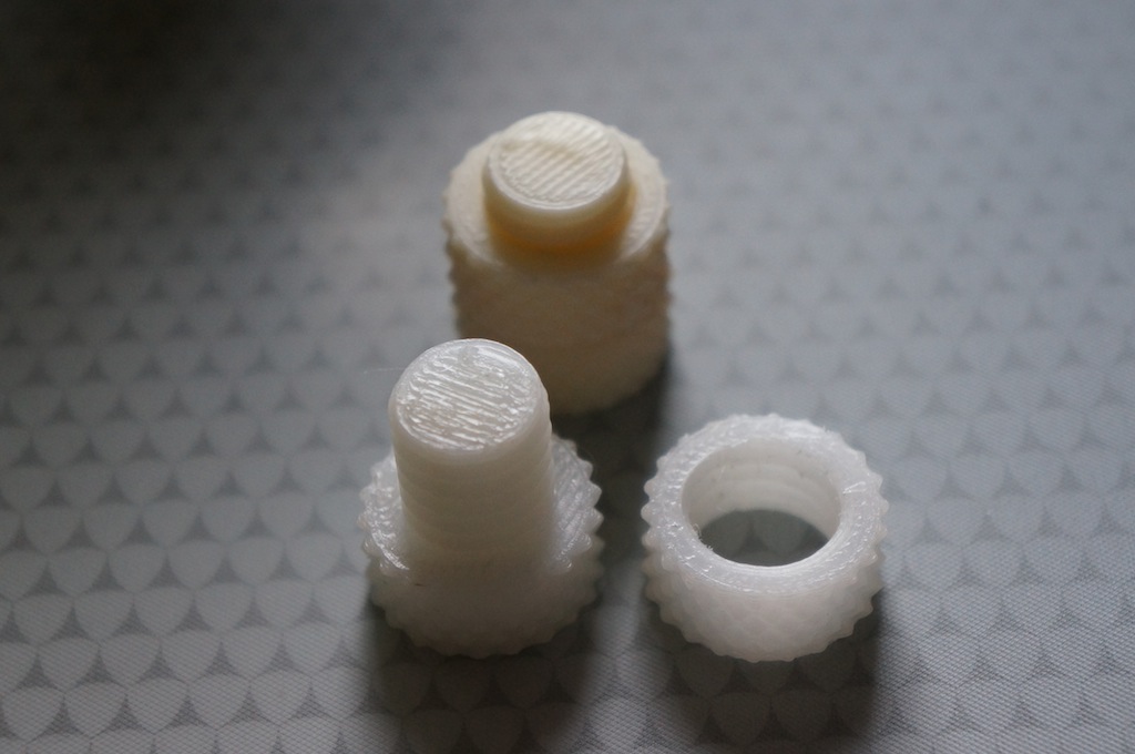

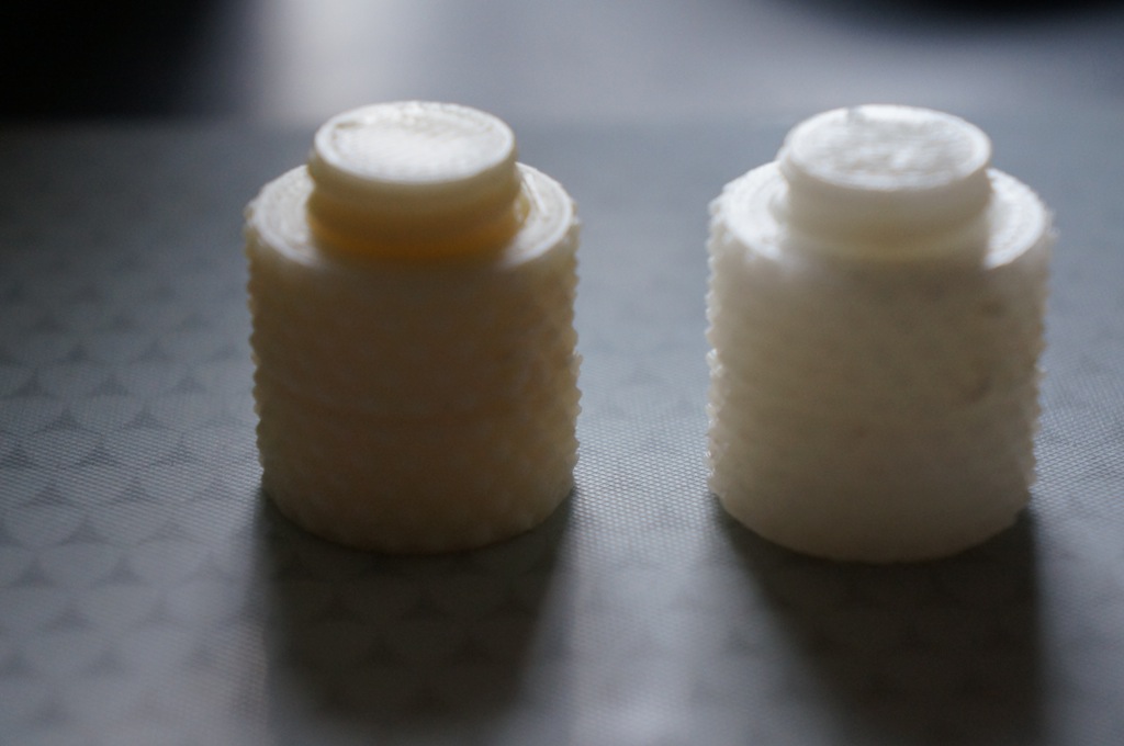

As Promised pictures of the Makerbolt in Nylon. The off white print is in ABS.
I spent very little time on calibration for this print, outside of trying to print anything that didn't warp. You can see the surface finish pretty well in the second shot, it's a pity you can't "feel the difference".
I'm printing it at 245C, although I can print colder it delaminates because of the warping forces, I had to slow way down to prevent it buckling.

How slow did you have to go to get the bumps/ridges into the "grip" part of that screw? The level of detail for something that small is impressive.
Re: New Taulman 618 Nylon filament available at SeeMeCNC!
I honestly don't remember, I usually run between 20 and 30 mm/s depending on how big the part is, it was probably limited by the cooling settings though so it's hard to tell.USMCPelto wrote:How slow did you have to go to get the bumps/ridges into the "grip" part of that screw? The level of detail for something that small is impressive.
It wasn't a particularly long print. IME the detail is much more a function of adequate cooling than speed, speed plays into that, but it's not the only contributor.
