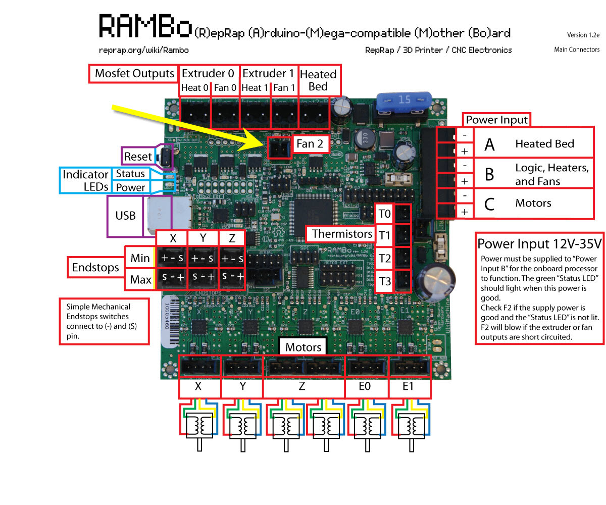

I'm looking for the connector type that plugs into the Fan 2 port on the RAMBo v1.2. Is that a 2 pin Molex 51021? (http://amzn.to/1stO2yG)

I think it's the same connector used for the thermistors. There should be one or two spare connectors included with the RAMBo that will fit that header.

Yup, you're right about that. It's the same connector as the thermistors. I don't have any spares. It didn't occur to me until now but I contacted Ultimachine and asked them. I'm really looking for some pigtails but I suppose I can make them if I have to.

Ultimachine has gotten back with me. This is what I was looking for...https://ultimachine.com/content/254mm-1 ... kit-6-pack.
