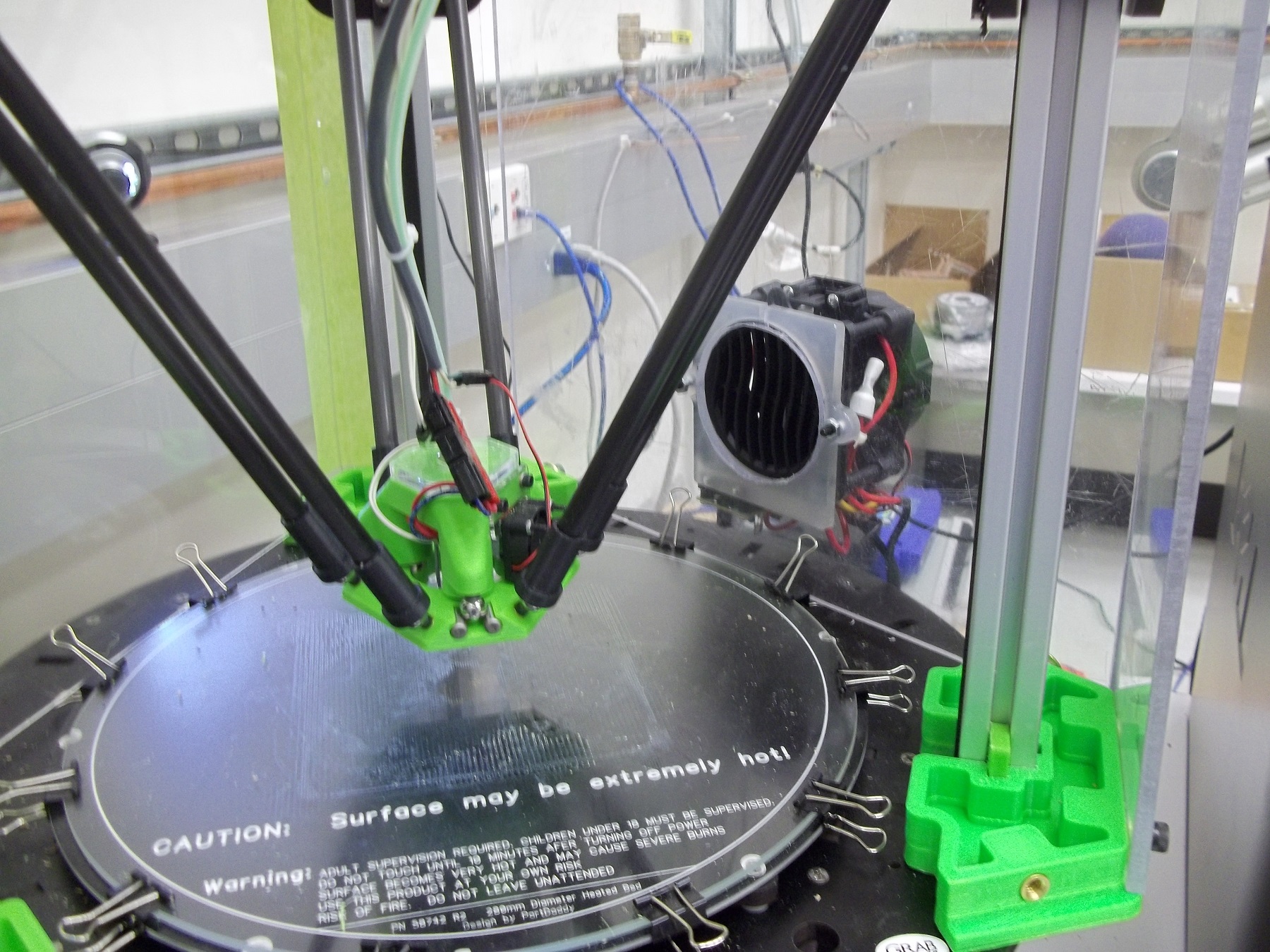

Have been testing a heated enclosure for my Rostock MAX a while back and thought I'd post some details here in case anyone else would find it useful and if anyone else has tried something similar with better results.
Instead of enclosing the entire machine, I added clips that attached to the existing Rostock MAX V1 structure and then bolted polycarbonate sheets to that. I moved the extruder stepper to the outside of the enclosed space, so that no steppers are in the heated environment. The material choice certainly is not great (or even good) for insulation, but hey, if you can't see your delta machine at work, then what's the point? =P
For heating, I tried both a small space heater and an IR heat lamp. I want to try a ceramic heat emitter next, but I think the results will be similar to that for the IR heat lamp. The heating elements were controlled via an STC-1000 temperature controller and powered separately from the rest of the machine. With only the heated bed running, I got an internal temperature of around 25C. My printer's in a rather cold lab space that's usually around 20-21C. Both the IR lamp and the space heater could push the enclosure temperature up to around 42C, though the space in the immediate vicinity of both heaters could get as high as 60-65C. For reference, the Stratasys uPrint and Fortus machines run w/ a heated environment with 80-90C ambient.
I have not yet tried running both simultaneously, and I'm not sure how the lifespan of either heating element will be affected by the temperature controller turning them of and off repeatedly. In terms of aesthetics and efficiently utilizing space, I really like the IR lamp placement, and if I place the temperature controller thermocouple on the moving effector, I think I can actually modulate the temperature with respect to the layer height, which could be really cool, though not necessarily useful.
Suggestions and questions are welcome!

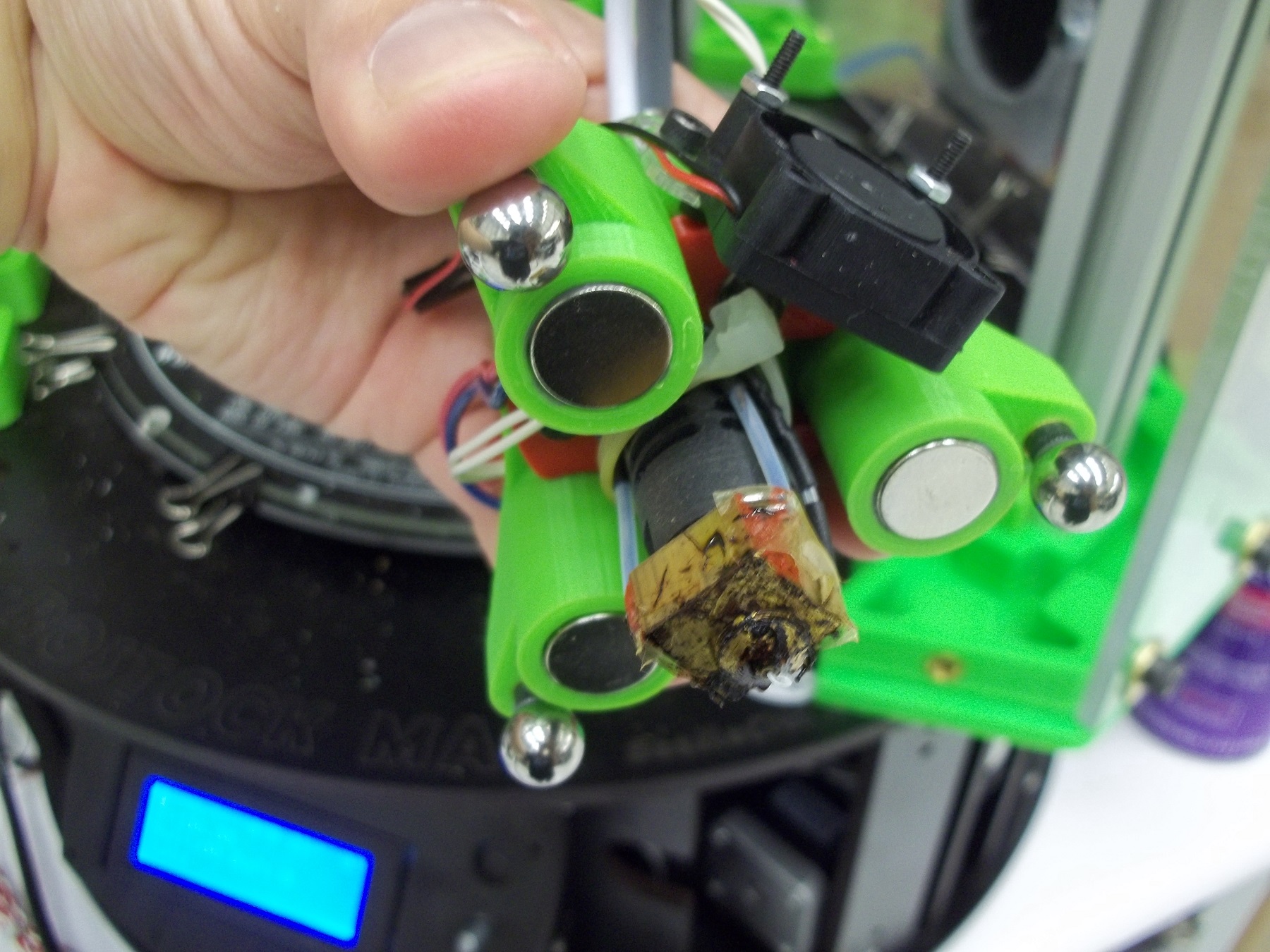

I'm interested in your effector plate / mount you have there. Got any close ups of that too?

I second that one. It appears to be magnetic with a different end cups on the rods and a different effector.
Would love more info.

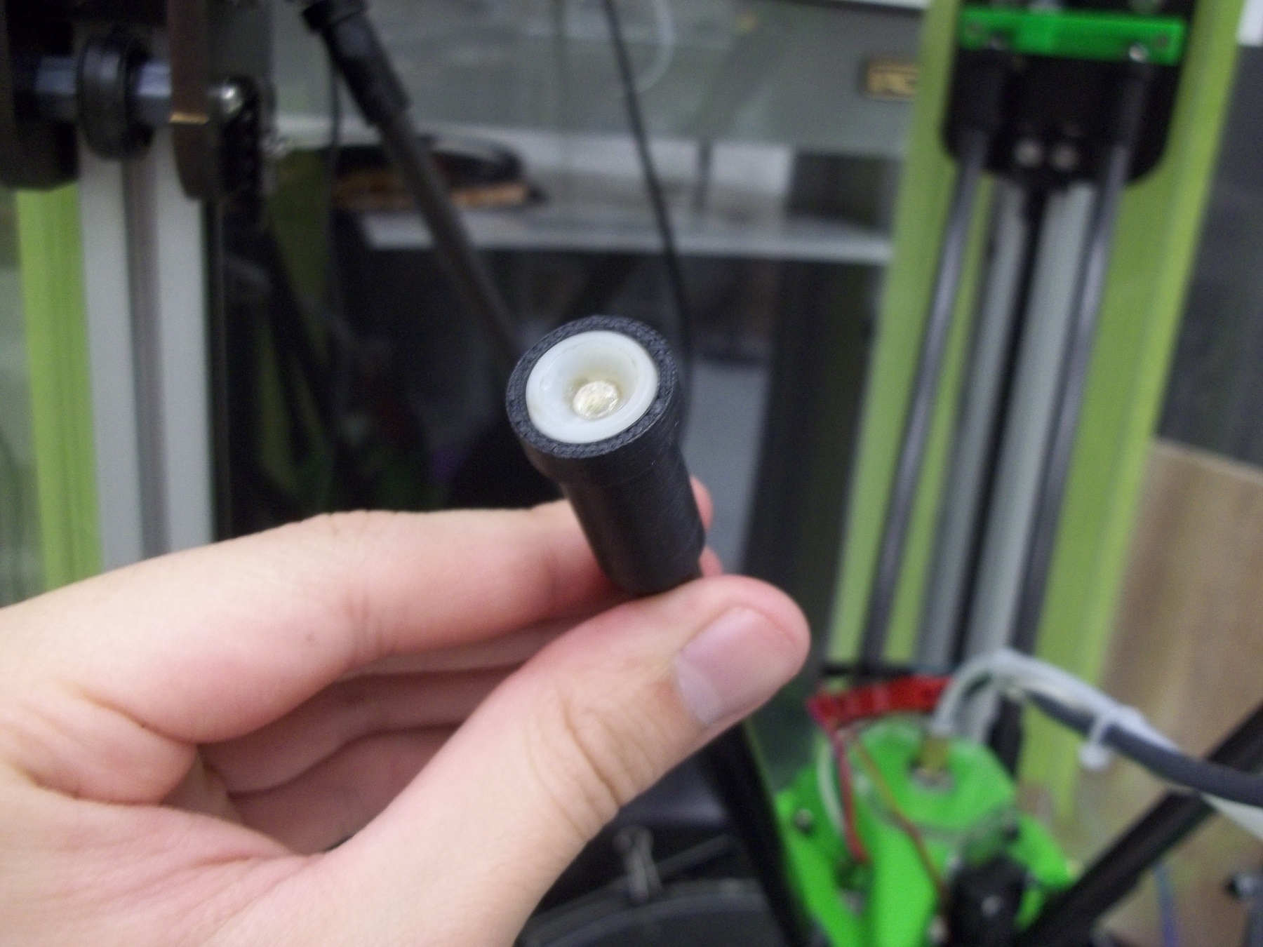

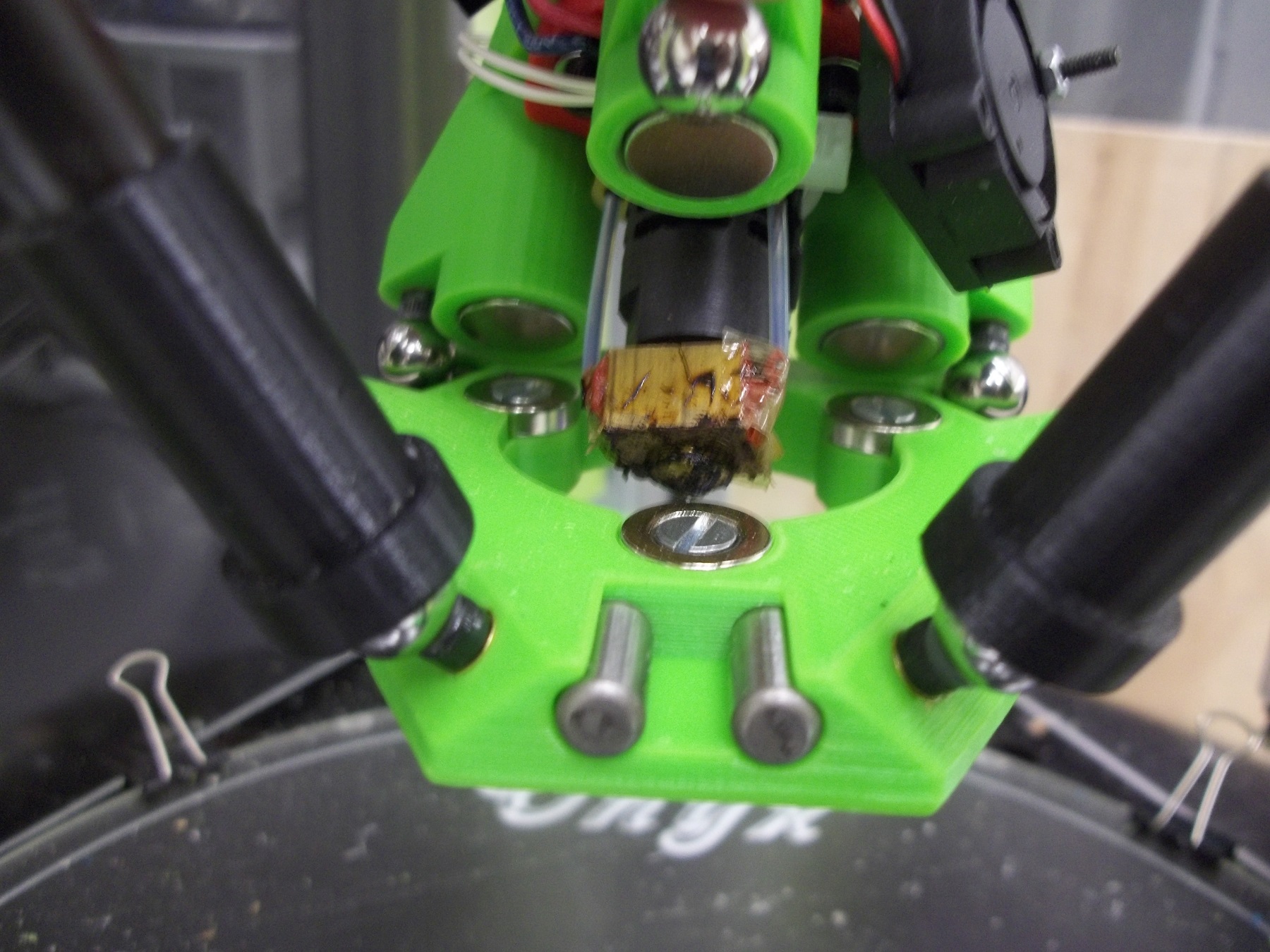

Sure. I detail it a bit more here: http://blog.rymnd.com/articles/rostock-upgrades/, and I had briefly discussed some earlier work here: http://forum.seemecnc.com/viewtopic.php?f=35&t=4433
I'm pretty close to giving up on the passive tool-changer. A bit difficult finding that sweet spot where I can reliably disengage the hotend while also ensuring that it'll stay put during long print jobs with fast moves. As is, it's still a nice quick-swap setup that lets me easily swap out the hotend for me dial guage and whatnot
