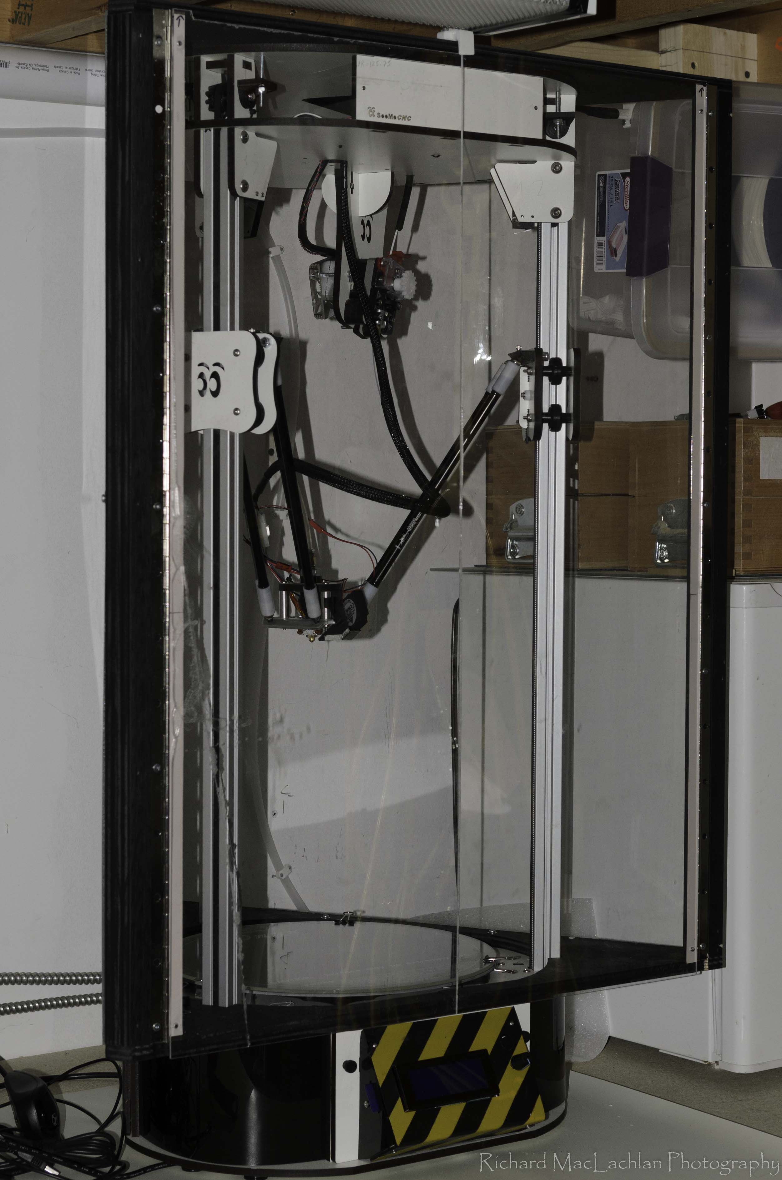

Here are a couple of pics of my V2, my first 3d printer.
some mods from original kit.
-Mag arm upgrade
-enclosure to control heat and keep dust out ( lives in the shop )
-Extra fan to ventilate electronics enclosure
-Enclosure for filament with desiccant packs
-Heat sink and fan on extruder motor ( found it was getting real warm when doing lots of retracts )

What is the insert in your spool?
RichardMac
- Posts: 36
- Joined: Wed Mar 26, 2014 4:33 pm
- Location: Keswick, ontario, Great white north
Re: Richards Rostock
it is my remake of thisteoman wrote:What is the insert in your spool?
http://www.thingiverse.com/thing:118205
I made different cones for different sized reel holes.
