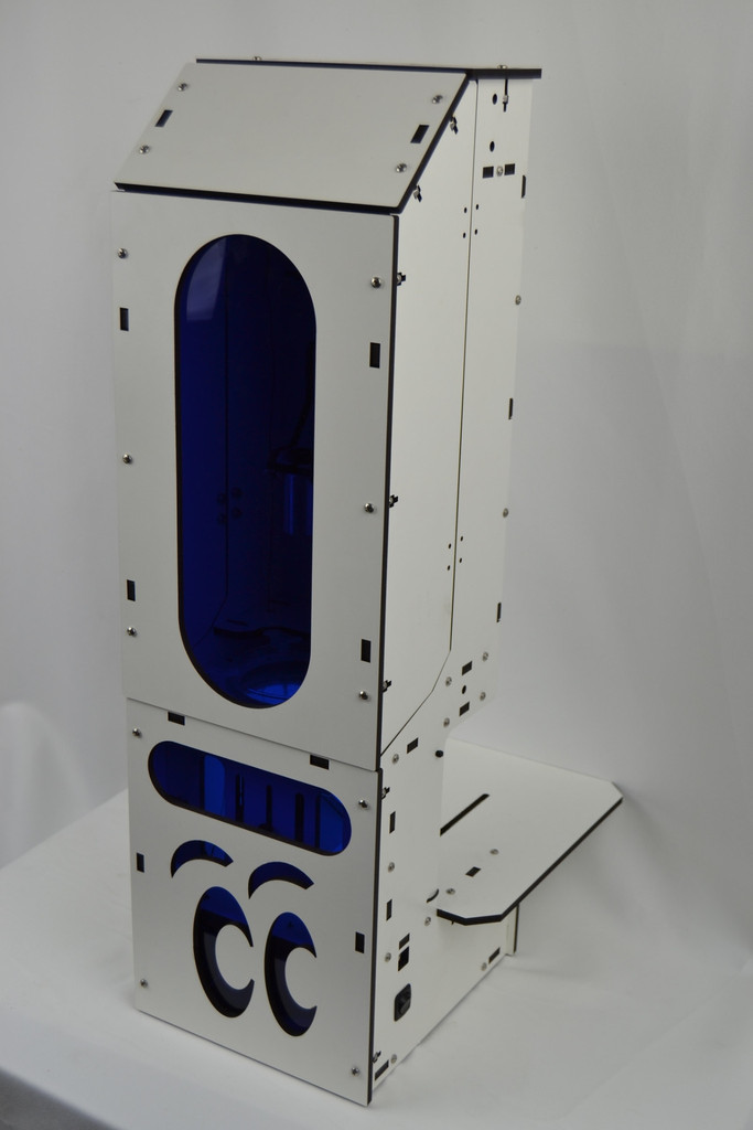

						My beta DropLet is assembled!
[img]http://mhackney.zenfolio.com/img/s5/v12 ... 5513-3.jpg[/img]
Mechanicals complete, electronics wired and unit tested. Now I need to upload the grbl firmware and test things out!

And the big news - I have motion! I had to get the latest grbl and compile and flash it. The SeeMeCNC supplied hex and re-compiled source did not work.

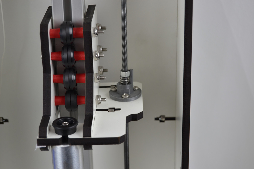

Got the acrylic parts in my kit.   Following mhackney's build thread, I was able to unpack and build up to the end of his thread in a total of 3.5 hours.  Some notes: The projector plate was a very tight fit to the sides; I had to trim material from the tabs and holes on both sides to get it to fit.  Dry fitting the very top and the lower front plate also required some adjustment in the tabs too.  Otherwise trying to force them would probably break something.  Once together, the cabinet seems quite rigid.  Tomorrow I plan on finishing the build and wiring the electronics.  Will update the thread with some pictures and any observations during completion.
