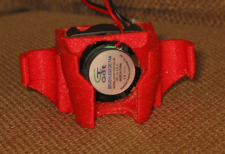

Hi all.
My 3d max v2 is ready. After the calibration this is how my first Print came out, I think that is pretty good.

Yours definitely looks better then mine.
All in all it was okay for a first print, I guess.
What's with the little hiccups and the line that goes thru the center? Is this a machine-thing or a room/atmosphere/breeze/temperature-thing?
I did no tweaking except for what was called for by way of bed size and filament thickness. I haven't even begun to start on the lessons for designing my own stuff. ANY suggestions for that???

Re: max v2 kit first Print PS
PS:
Mine didn't put down all that extra stuff on the bed... it just started straight away with the build of the object. Why? (Stuff to learn, switches to throw, knobs to pull to tweak the end product, I presume...)

Hi GPriv,
The extra stuff on the bottom of a print is determined by software settings. duvdev may be using software other than Repetier and Slic3r, or he may have just tweaked the slicing configurations to add the extra perimeters
In your photos the little hanging pieces the sides of the shroud are normal - everyone gets them, duvdev and myself included. As for the line in the middle of the print I had the same thing. I believe the cause may have been either a bit of a breeze, or an accidental bump of the printer, or most likely, I've been noticing that the filament spool is a bit "sticky" on the square edged spool mount and it jumps a bit when the extruder picks up the slack in the line.
Edit: I don't have a huge amount of experience with different filaments, but have you printed your fan shroud in ABS, not PLA? Personally, my PLA has always come out slightly glossy so seeing your glossy red fan shroud it made me think to mention this.

I print only in ABS. I'll be using my printed creations outdoors so I won't give a seconds' thought to PLA.
