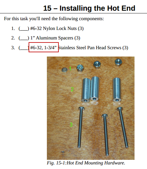

What length screw is to be used when assembling the hot end?

Use whichever they gave you. You do not want it protruding too far out.
BONE wrote:What length screw is to be used when assembling the hot end?
page 161 page 162
By the time you get to that step, there's probably only one group of screws left in your unused parts that would possibly fit in this location. There were many places in the build where you could deduce the correct screws without measuring because the manual called out some number of screws for a particular step and there were only one screw that was supplied which would fit that place.
Good catch, Brian! I'll get that fixed as soon as I can.
My kit came with not enough hardware in those sizes, so SeeMeCNC sent me a bag of each. That's why I was asking and brought this discrepancy in the manual to this thread.Brian wrote:BONE wrote:What length screw is to be used when assembling the hot end?
