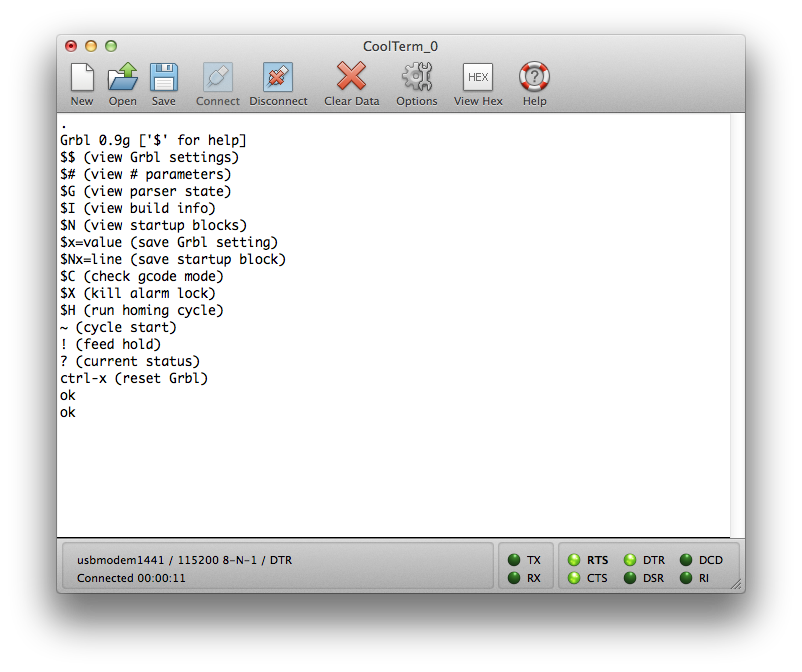

Ok, I grabbed the latest grbl sources from the grbl github, compiled and uploaded the hex file. Now I see this when I connect in CoolTerm and issue the $ command to get help:
And a G0 Z3 moves the Z stepper!!!
The configuration is all wrong of course but I should be able to fix that now. I'm not sure what was wrong with the SeeMeCNC supplied grbl source and hex file, I'll try to investigate when I have some time.

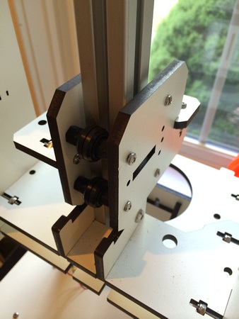

mhackney, the bottom holder for the extrusion is one layer too high.
The tabs on the "T" shape that received the t nut, gets sandwiched between the tray holder and next lower board. Notice the tabs cut out on both of those layers in your picture.

Re: mhackney's Beta DropLit build
Ah, good catch! That will lower the column significantly too. I think I can make that change without too much disassembly.

Lower T-nut mount update
As rgthane pinter out On Monday, I had not installed the lower T-mount extrusion holder in the proper place - doh! I had to do a little disassembly to get it int the right place and thank heavens for holes in the cabinet sides that allowed me to use an Allen wrench! Here's the proper placement:
[img]http://mhackney.zenfolio.com/img/s2/v1/p546337533-3.jpg[/img]
