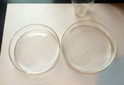

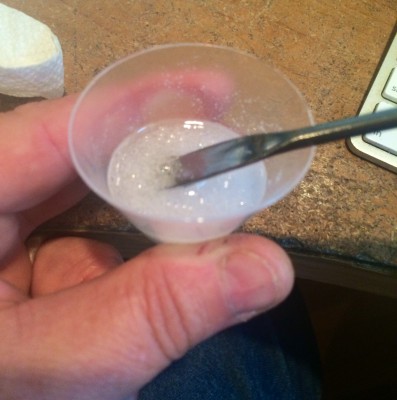

I had a big reel making workshop event last weekend in the Catskills that slowed progress on the Droplet. I'm out of the woods now though.
Today I mixed 10ml of the base with 1ml of curing agent to yield 11ml. Stir for 4 minutes until you have lots of bubbles and the mixture is milky looking.
Then I poured it into a clean glass petri dish. I used isopropanol to clean all traces of grease off. I pushed the mixture around to form a nice 2-3mm thick layer.
Place a sheet of paper over the top so it can cure without dust falling in - for 48 hours!

Re: mhackney's Beta DropLit build
I just checked the Sylgard 184 in the petri dish - it is crustal clear and dead smooth! Now I just have to wait another 47 hours.
