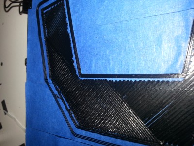

Okay so this is even more apparent in its severe detachment (perimeter from infil) No matter what settings, the infill refuses to contact the perimeter, this is generally a problem around 100% of a print. obviously, as you can see, its closer in some areas and more prevalent in others, the gcode displays correct layers when stepping through them...please help ready to sell this thing!
I should also note that the perimeter is exactly sized as the model is built (built in NX 8, exported as stl and sliced with slicer both the included version and the new .098 revision exhibit the same problems. Someone suggested a switch to kisslicer which i am not opposed to but i have not come across a good setup tutorial on configuring for the Max. I also havent had much time to search out any kiss info either...Links would be appreciated, PM, whatever, desperate in CT.
-Seth
Posts: 2417
Location: Redmond WA
Re: Perimeter detached from infil
Post by Polygonhell »
Looking at that I'd say you are losing steps, or one of your belts or pulleys is slipping because the infill is overlapping the the perimeter on one side, but not reaching the other.
I'd check the screws on the pulleys first, use some loctite or other threadlocker to hold them in.
if it's the stepper skipping, it can be one of a few things
it could be mechanical, and there is too much resistance to motion on one of the columns.
It could be the stepper drivers set too aggressively or not aggressively enough, are you using a RAMBO or RAMPS?
It could be your trying to move faster than the steppers are letting you (turn down your travel speed in the slicer)

I'd start by trying to figure out which tower is skipping, it's likely the one in the direction that the infil is moving. If it's not obvious during a print I'd write test GCode to try and reproduce it.
After that, I'd try and figure out what's different.
I'd try dropping print speeds and travel speeds to really low values (10mm/s or less) to see if it is likely an accelleration or speed problem.
Unfortunately if it's loosing steps there are a few things it can be and all you can really do is try and isolate them, there is no magic this is the issue answer unfortunately.
One possibility I forgot to mention is if the head isn't moving parallel to the bed, and it's rubbing on the bed or the printed material as it moves, that can be enough resistance to cause one motor to slip.
I usually look at the GCode visualization, and compare it to what i'm seeing in the print, and look for obvious correlation, like the perimieter looks good and if the issue is as it appears to be when the infill starts, I'd look at the travel move before the infil to see if it's moving in the direction of the shift.

If you look at his attached pictures the original poster is not having the same issue, the infill is virtually touching the skirt on one side, the whole print is offset.
As to the perimeter issue, I don't use slicer, which may be the biggest reason I don't see it, it's possible that there is enough rounding occurring in positions in the delta coordinate conversion that the infil, is short of the perimeter in slicer, but the basic math I did suggested that any rounding was in the <0.1mm range.
Both KISSlicer and Cura allow control over the edge infill overlap. I set it to 75% in KISSlicer, rather than the default 50%.
There is a lot I don't like about the Slic3r calculation of default extrusion width.
FWIW I had 2 mechanical issues that were exacerbating the issue for me, a loose pulley and som backlash in the belts

On Tuesday I got my best print yet out of the machine. My infill/perimeter issue is basically fixed.
I went back to square one and re-calibrated the entire machine.
I started out by using the new tower base points (these are listed in the current rev. of the assembly manual in the calibration section) and then I added a new step, calibrating the concave/convex shape of the build surface (or what the machine THINKS that is).
If you do "G28" and then "G1 Z0 F3500" you should have the same distance between the nozzle tip and the bed as you got from the tower base points. The key parameter here is DELTA_SMOOTH_ROD_OFFSET if you're using the Merlin firmware and PRINTER_RADIUS if you're using the Repetier firmware.
The default setting is 198.25 as shipped from SeeMeCNC. Assembly variances can and will cause this value to change a bit.
If your nozzle is higher at the center than at the tower base, you need to increase this number. Increase it about .5mm at a time. Don't forget, with each change of this value, you'll need to re-calibrate your tower figures because they'll have changed due to the concave/convex adjustment.
Conversely, if your nozzle is lower, decrease the value to pull it higher.
Another important point to note is managing the grip the extruder drive has on your filament. I was WAY over tightening the hobbed drive to the point where it was actually reducing the diameter of the filament as it passed through the drive. This resulted in the slicing software thinking it had a lot more filament to work with than it actually did.
Correcting the drive tension in conjunction with the re-calibration resulted in some excellent results.

Eliminating those Delta Rod Blues
Well, I solved my infill gap problem and suspect the "fix" may be generally applicable to others with gap problems. Here is a lengthy post (plus read a few leading up to this one): Don't Get Those Delta Arm Blues!
Basically, in my case, one stiff U joint was causing the problem. Imagine if you had 2 or more stiff U joints!
cheers,
Michael
