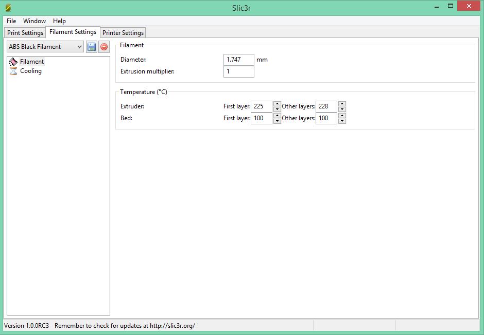

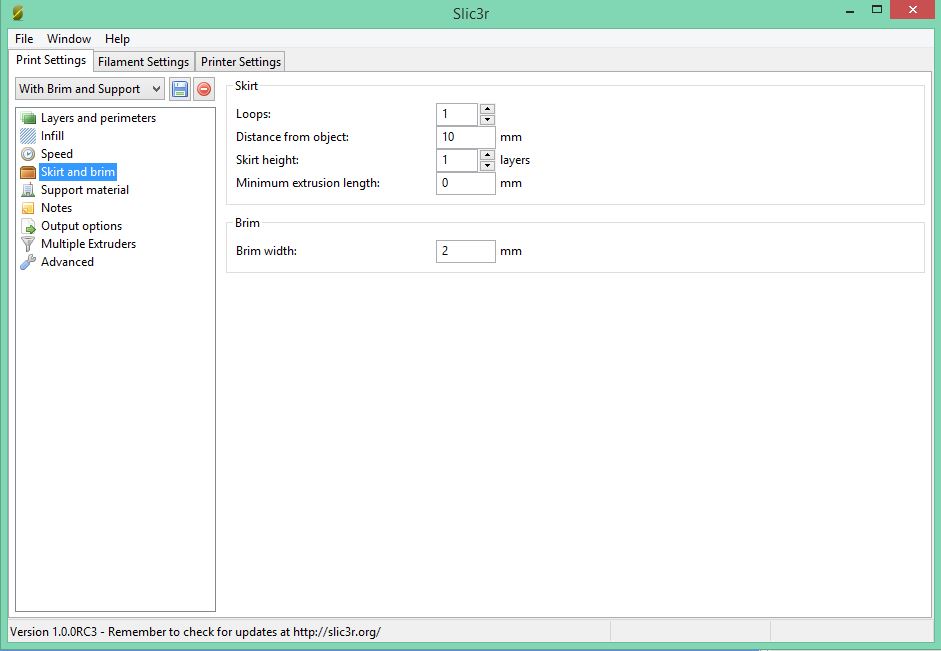

Speeds temps support settings...
Those are pretty big prints and with my luck they will picass at 99%.
HesDeadJim
Posts: 64
Joined: Thu Jul 31, 2014 8:07 pm
Location: Omaha, Nebraska USA
Re: Maleficent Horns - (First Section) on my Rostock
Post by HesDeadJim »
I took screenshots of the settings I used for the Maleficent prints and will post them below. I use ABS juice for the bed adhesion.

Thanks for the setting. Seeing the part and the setting that go with it is a good idea. Maybe we could come up with a standard way to post that.
