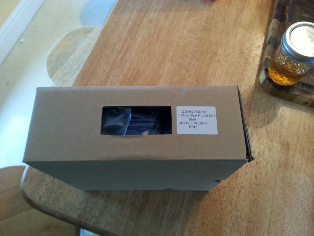

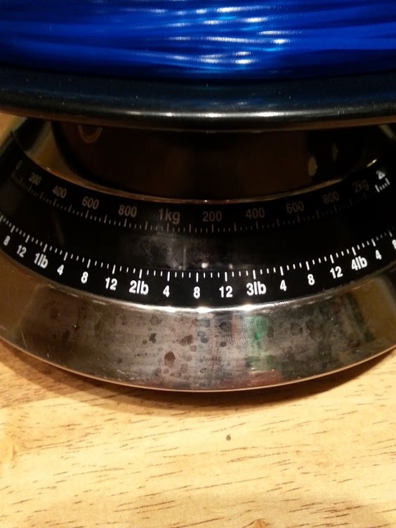

Got roll of PLA from Gizmo Dorks yesterday and did a quick experiment. It seems to have lost a 2ozs of weight in about 4hours. I checked it each hour and I could see it slowing dropping also. I weighed the plastic bag and it did not affect the results. More official tests will have to be done later. I'm also questioning how much water could be in the spool reel itself also. Does anyone now what material the reels are made out of?
Filament was dried in a fruit dehydrator for 4 hours at 145F

For us metric guys that was:
PLA lost 56 grams drying at 62 degrees during 4 hours.
And for the completely ignorant PLA spent an evening drying a a temperature very hot but touchable and lost a shot glass and a half of water.
So you are saying the pla was wet/moist when it came?
56 g is a significant amount of water.

This is my first spool of material and i still need to print something. The test was real quick and dirty. The battery died on my digital scale, so I had to use the kitchen scale. The test clearly needs to be repeated and I will do so in the future with a more rigorous test guideline in place. Weather the water came from the filament or the reel, it's water that is wanted near the filament. Maybe the dial moved on me and I didnt know it. But I do believe that I did get water of out the filament. More testing to come.
I would love for others to report results to increase the data points. I know drying works before processing, because my old job would dry every batch of material before going to the injectors. If there was an water in the pellets, it would turn to steam and generate problems. It will be the same thing coming out of the hot end on the printer.
