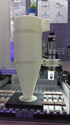

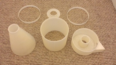

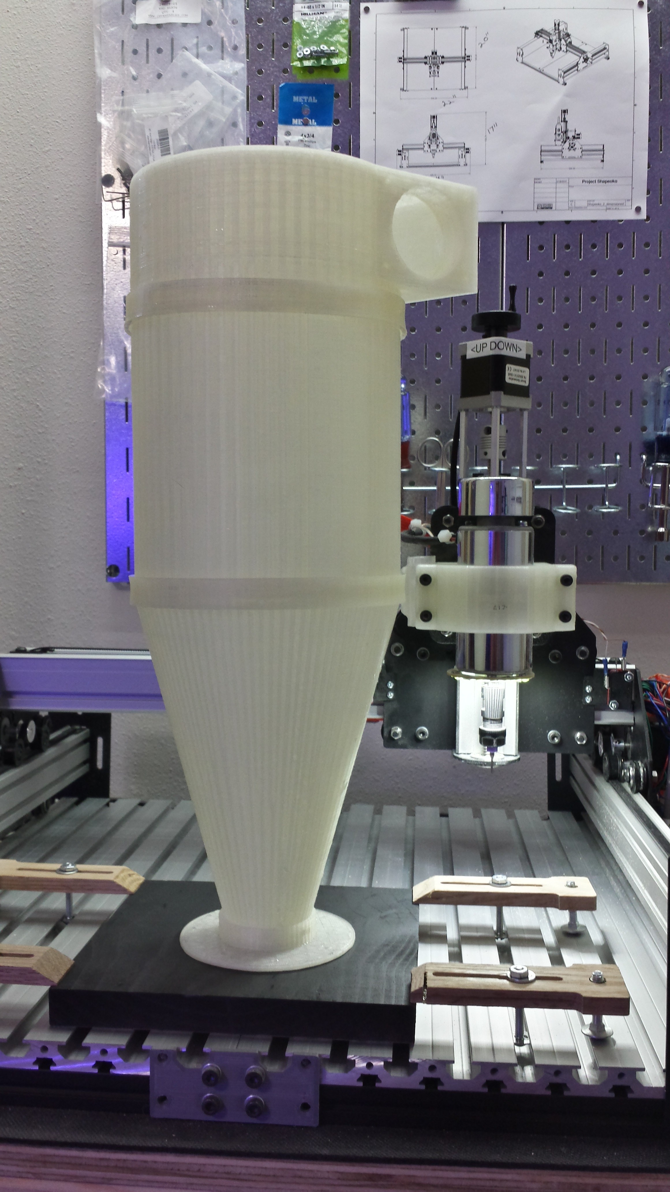

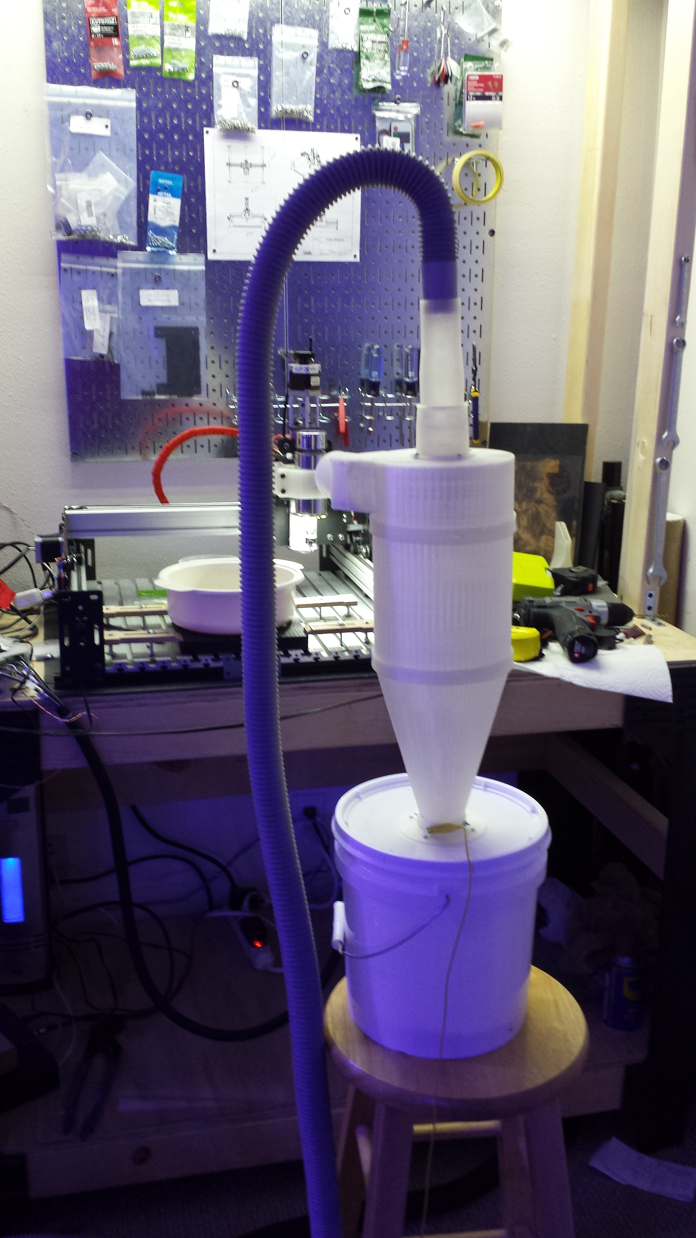

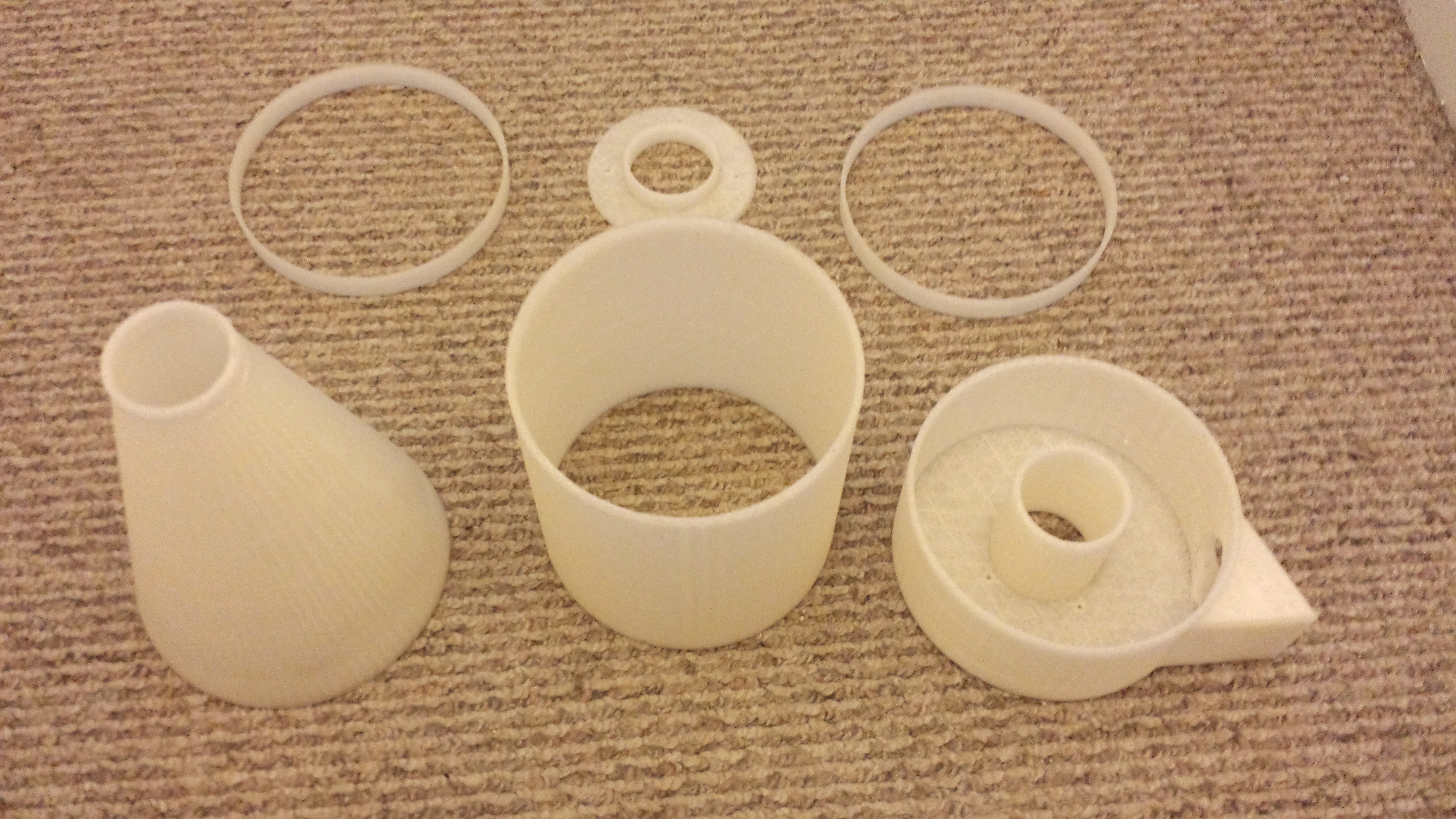

I do a fair bit of CNC work and the dust can be murder on the shop-vac filters. I downloaded and modded a cyclonic dust catcher design. Printed up in natural PLA and went together great. Just a few screws and the hose connectors left and it will be up and running. More pics when it is mounted and a few shots of the Vacuum and dust bucket once I give it a test. So far I have less than $20 in it. Cheapest system I could find (and what mine is partly modeled off of) was over $200. So far it is a win. Really looking forward to hooking it all up tonight and milling a job to see how it does. It is 17" X 6" unmounted and without the hoses attached. Since it is based off of http://www.thingiverse.com/thing:31595, it can be expanded up as needed to capture more dust if this height fails to do the job. I did how ever find the connecting rings a bit too small for my taste. I made them both touch wider and tall in Solidworks and now they fit great. The stock ones were too small and FAR too short for my liking. More pics to come as it gets put together today.
The bits and bots of it all.

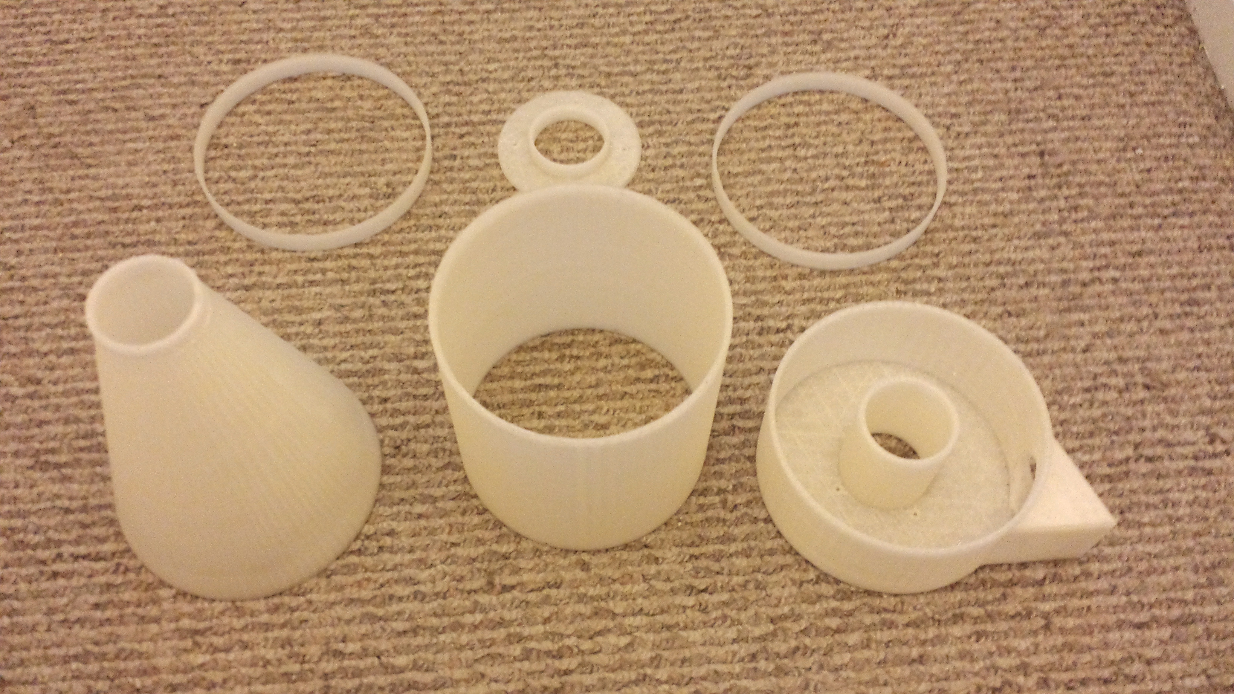

Dry fits nice and tightly. Few screws and some silicone should have it running nicely shortly.

Nice find. I hodge podge one together when I was machining a lot of mdf on my cnc mill, It made a huge difference with the vacuum.

You mount it to the top of a 5 gallon bucket, the debris falls into the bucket. When you get to a computer, click the link. The guy posted pictures of how it goes together.

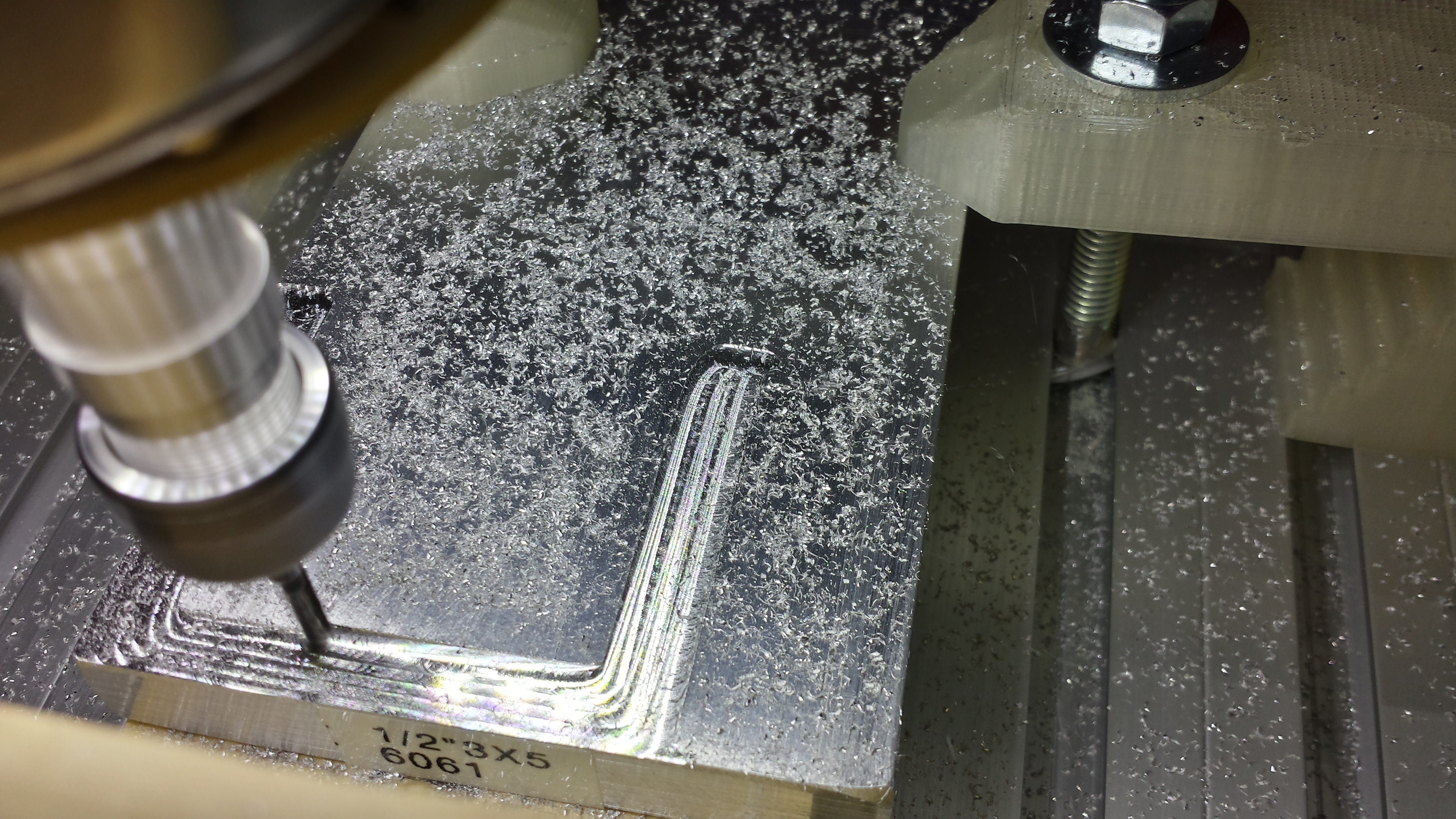

This is how it looks on my small bucket. As I mostly do PCBs and 6061 Aluminum, I did not need a large bucket. Notice it is grounded also by a screw towards the base. That made a huge difference also.

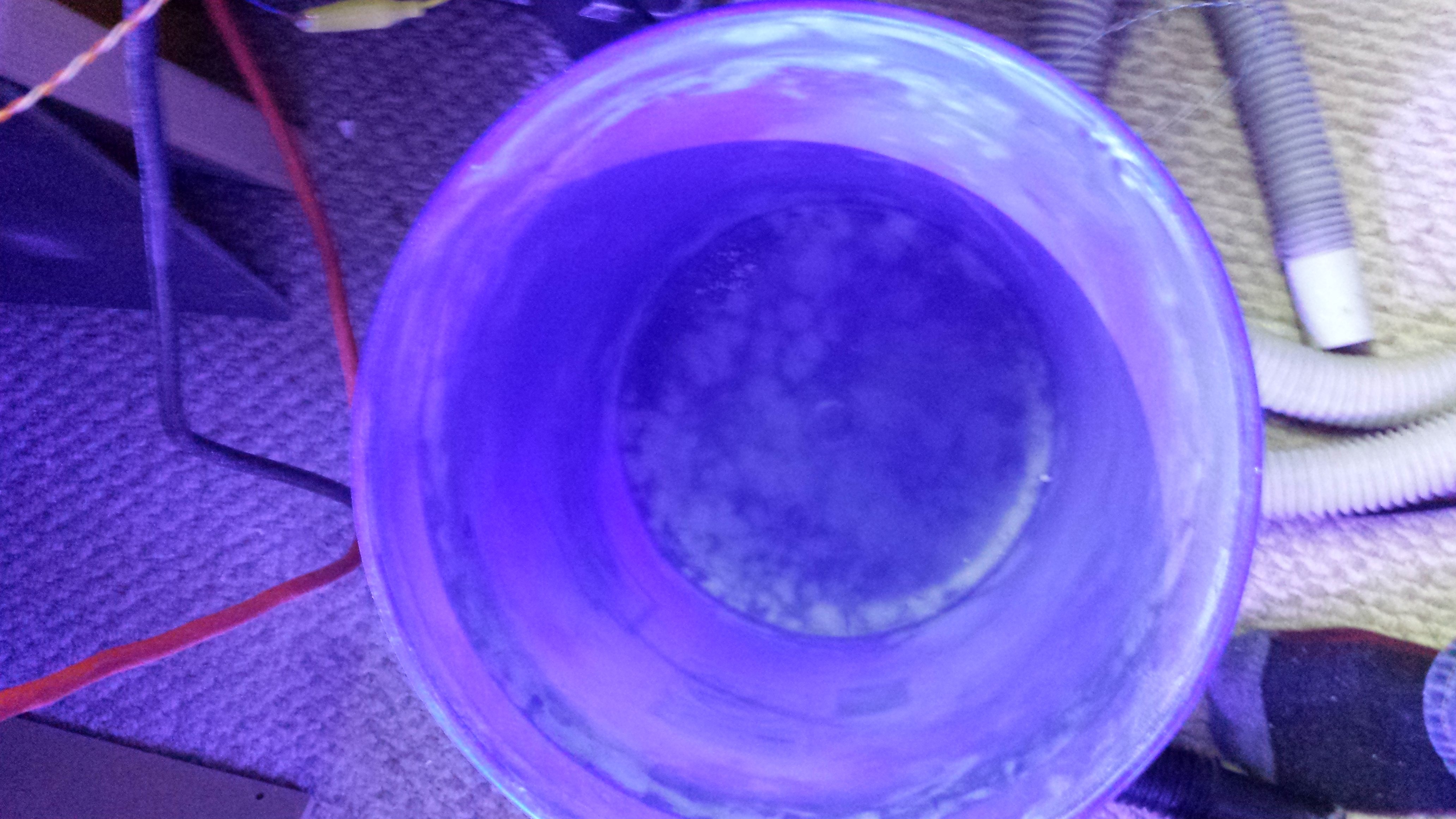

This is the empty vacuum bucket which used to be full of dust all the time.

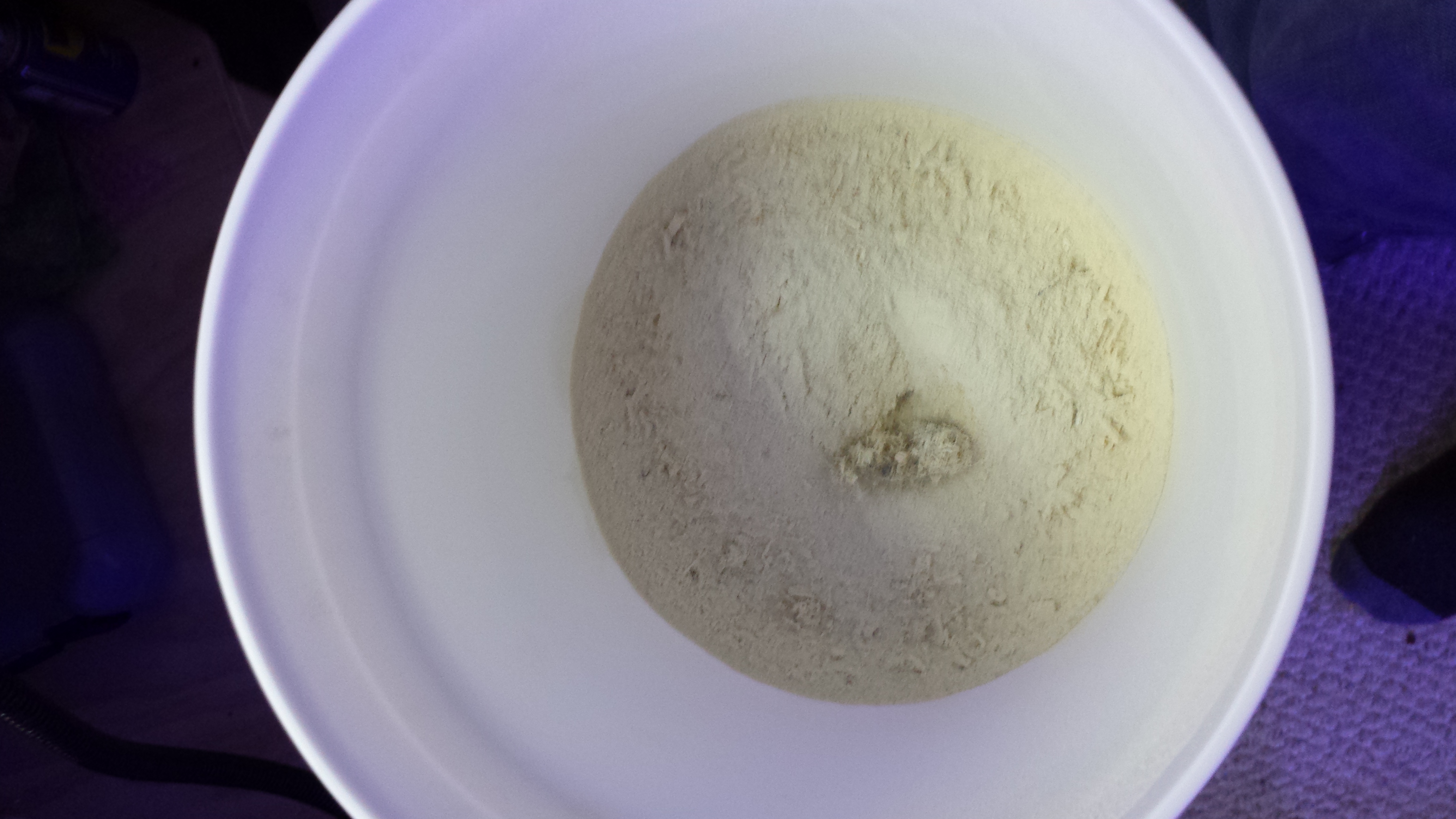

And here is the nice cyclone bucket full of all the dust I tested with. From course to super power fine dust. It all got stopped by the cyclone. LOVE IT!
I thought I might have to make a few more mods to the design but I have to say that it was pretty spot on. Will be doing some long overnight prints shortly to give a larger on to my father for his woodworking. THIS is the sort of thing I bought my Rostock Max V2 for.
Now just time to work up a vacuum manifold for the pickup system and tie it into the PCB vacuum table I am about to mill along with a balance valve and I will be all set. I bought my Max to make parts like this for my CNC even before I bought my CNC. So far it has done a perfect job!

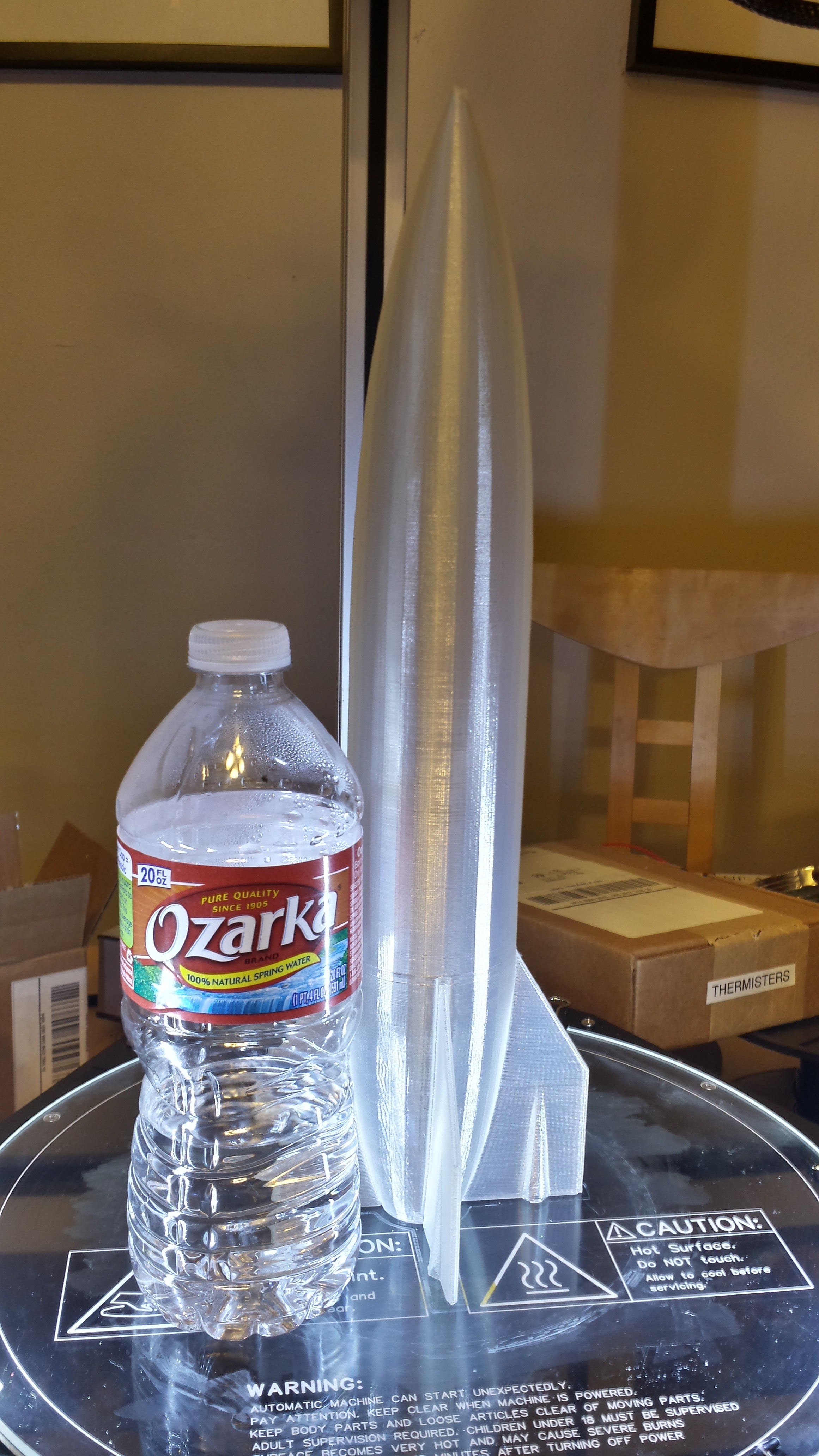

As an aside... This is my largest height print so far. Right at 14". Just a fun single wall print to show off at the Geek Gathering coming up to showcase the great size the Max can print to.
Just a fun test. My other half works at NASA so we have lots of silly space stuff all over. So this was a fitting height test subject.

Here is the file for the larger ring. So far I have not used screws on it as it now is a perfect fit. The one that comes with it kept printing too tight to fit for me. I also made the ring taller to hold better. Now it is a firm fit and the ring covers a larger area on each piece. It is working great for me so far. Just make sure you ground it. I had the screws that attach the cone to the bucket mount come from the inside out. This leaves only the screw head inside and also give you something attached to the cyclone to ground it with. I used #4 1/2" screws and bolts. On the bucket mount I used fender washers and it is rock solid now. For the hoses connections I used #4 bolts, washers and nut. You will need 2 wood or sheet metal screws for one of the hose mounts as you can not reach the screw end for a nut. 2 #4 sheet metal screws did the trick for me just fine. Let me know if you have any questions. I did mine at 3 perimeters, 3 top and 3 bottom layers with .2 infill and it is rock solid.
Cyclone ring.STL
larger body ring for cyclone dust sytem

I have done six large wood CNC mill jobs and two aluminum jobs and there is only a TINY amount of SUPER SUPER fine dust on the vacuum filter and the dust bucket is about ready to be emptied. So far I am in love with this think. Already have a guy who mills carbon fiber on his CNC asking me to print him one. Best part is I used only part of a $15 roll of PLA and it is working great. I love 3D printing!

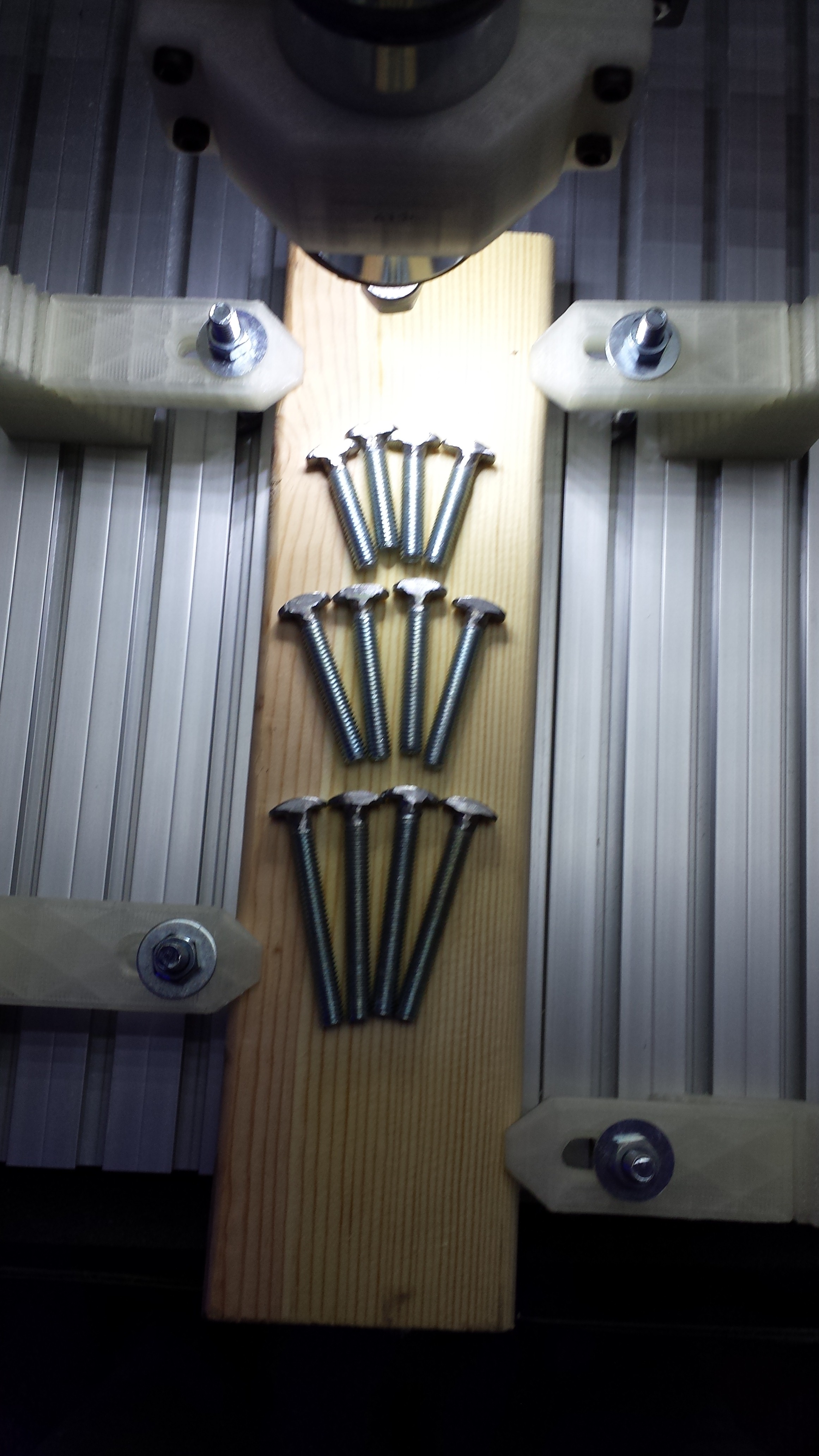

So far I have been extreamly pleased with mine. I did do a few upgrades. I went with the Z axis upgrade right off the bat. I also went with a TingY controller which over all I am pleased with. I also did the T slot bed (http://us.misumi-ec.com/vona2/detail/11 ... -15250-500) and it made a HUGE difference in getting the mill squared and over all usage. I just took some 5/16" carriage head bolts and made my T bolts. They are working great and were FAR cheaper over all. As I only do 1/2" aluminum and smaller stuff, they are working great.
