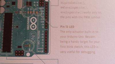

What is the function of the status LED?

I think the Status LED will flash when you press the reset button to let you know it's resetting/reset.
The flashing LED lets you know the Bootloader is loading... I think a bootloader is essentially like a computer BIOS for the board.. but I could be wrong?
Also I believe you'll be able to program it to perform whatever function you decide you want to assign to it and what you want it to indicate... useful debugging tool id guess?
From what I've seen from basic Arduino tutorials the "L" led is linked to a specific pin so you'll definitely know that pins State
as described here: http://arduino.cc/en/Main/ArduinoBoardUno

Re: Rambo LEDs
It's the utility LED on digital pin 13 found on nearly every general purpose Arduino since day one. If you loaded the arduino blink program, that's the LED that would blink. That pin isn't connected to any rambo hardware besides the LED itself, but is broken out on the pwm header.awander wrote:Yeah, I already had that doc, but thanks for posting it.
I don't know if it's used as an indicator by any of the firmwares.

Ok looks like It's intended function is definitely for debugging... well that's what the official Arduino Project Book manual states on page 11.
Though I suppose as you can code it to light however you like to feedback whatever you want it to....
