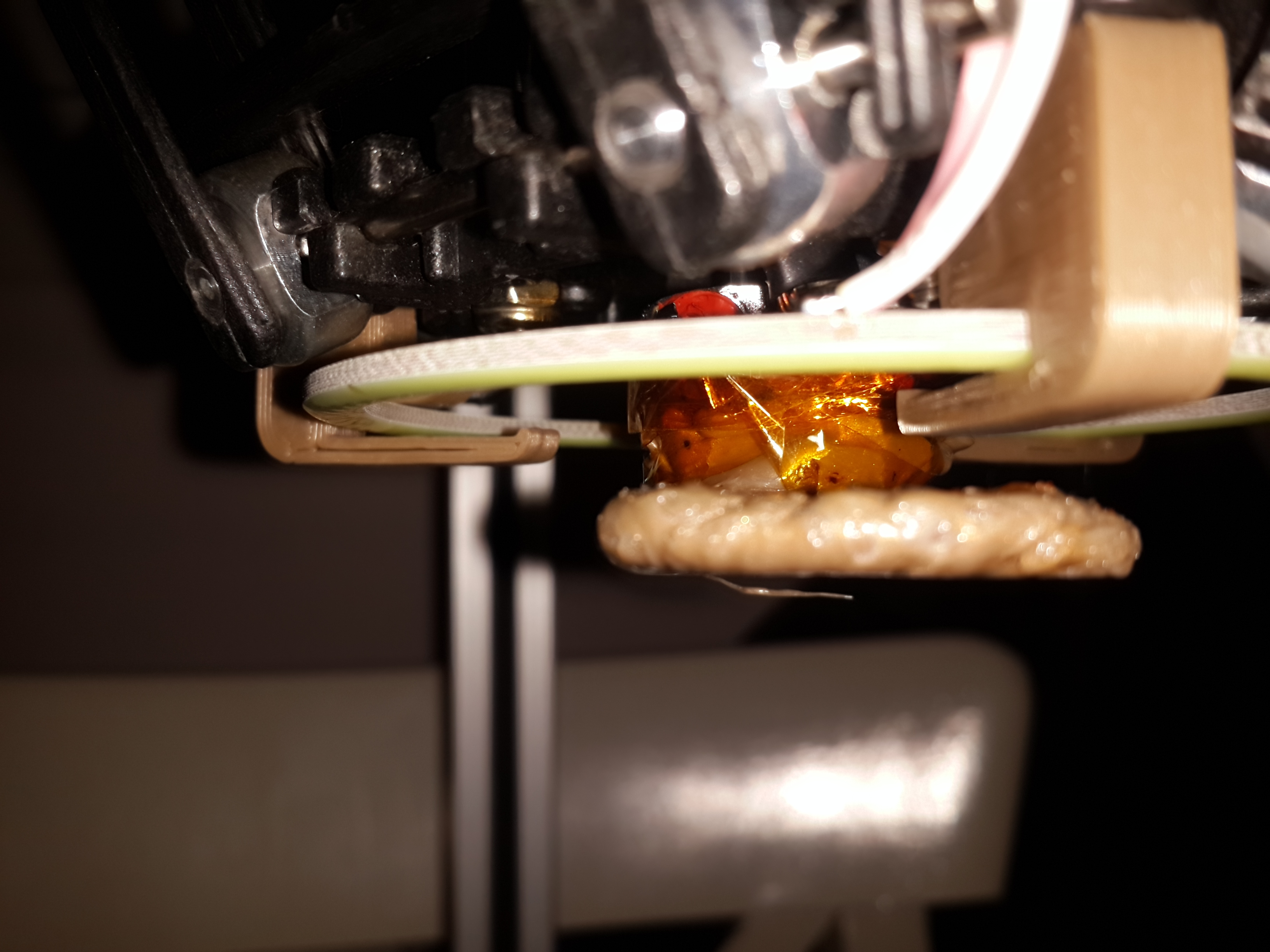

It looked as it was going to hold.
When i came to have a look discovered this.
It has crept up from the sides of the nozzle and in to the kapton tape. Its going to be fun removing it.
Ill try lightly sanding the bed now.
Re: First layer temp? MC slicer
Does a shiny nozzle help in this case? Or would have helped ?
That was easy. Heated to 208 degs and pulled it right off. All kapton tape came with it.
Wiped it with some TP and it looks decent again.

Teoman,teoman wrote:It looked as it was going to hold.
where did you bought your ABS? I remember you are in Turkey. I´m in Germany, so maybe we can share our experiences with the european Filament suppliers. Which one did you use when it came off?
When I was using abs juice, I had the same once. Had to disassemble the complete effector, because the ABS was wrapped around the Hotend and the effector plate. Cleaning took hours and I lost a lot of acetone for that. But with the PEI- or the buildtak sheet I never had this again.
Very interesting that some are very pleased with the PEI and some have so much problems. Due to we all using nearly the same hardware, it must be a filament problem.
