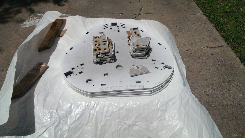

Here are the parts ready for primer and then orange paint! Anything black will be orange and anything with paper on it will be black.

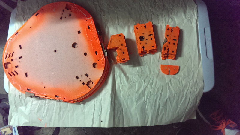

The first step of the side parts being orange. It is too hot now for any further painting in the garage. So I'll need to paint the other parts next weekend.
The primer I'm using is Kilz Latex 2 primer. I had to use two coats to cover the majority of the black wood ends.
I'm using Rustoleum Neon Orange spray paint for the final coating. You will notice some of the orange paint on the top is cracking. The sides looked good when I inspected each part.

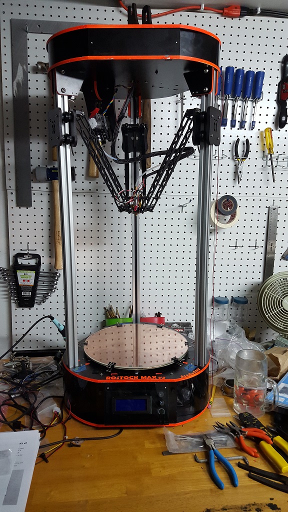

So life happened and I had to take a long break on building the printer. I've resumed and am almost done.

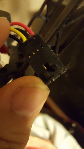

One problem is the wires broke off the crimped pins for the hot end thermistor going in to the RAMBO board. There is only one 1x2 latched female housing with the kit. Does anyone know how to remove pins from the connector with detached wires? I'm going to try an awl to push the pins out and a needle to push the metal pin latch down. Didn't have success trying to pry the pins out with my smallest needle nose pliers.

The awl did work to get the pins out of the connector. Hopefully my first print will be tonight.

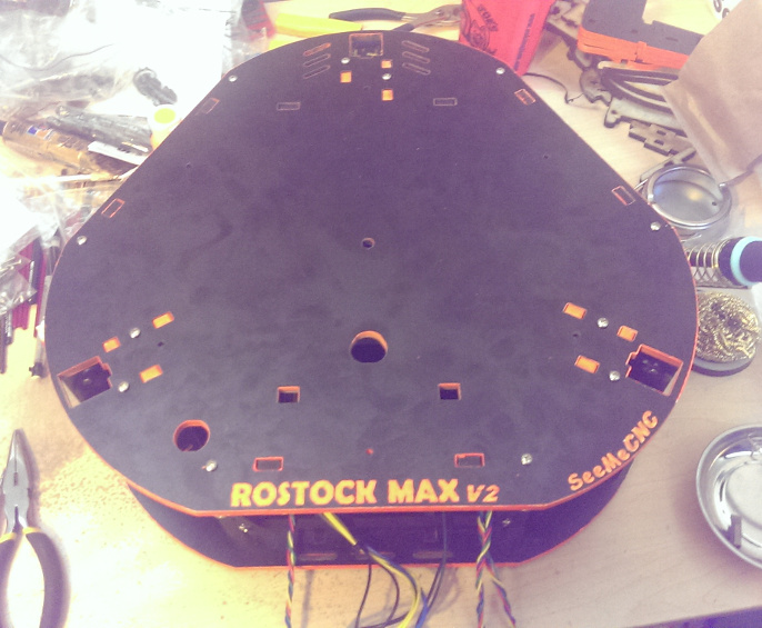

Here is what my version of the finished Rostock MAX V2 looks like. I've since moved the Rostock from the garage to my home office.
I went through the tests tonight and found a few problems. All the endstops and motors works very well. The heated bed, bed thermistor, and two LED lights work well. I have an issue with the hotend heating and hotend thermistor. I've narrowed down the problem to the quick disconnect on the extruder platform. I get continuity between the connections on the RAMBO board and to the quick disconnect connector. I also get about 88k ohms on the thermistor and 3.2k ohms on the power resistors after the disconnect latch connector which I believe are the correct resistances.
My current thinking is the male pins aren't sticking out enough on the latch connectors. The male pins are 1/4" inside the male latch connector. The female pins look like they are all the way to the end of the female connector. Here is a picture of the male connector with the pins from my phone.

I spent a few days investigating my issue with the hot end. I tested all of the wiring to the hot end and the wiring was getting continuity through out. I tried moving the wiring around inside and the continuity didn't break.
I took the hot end completely apart and tested the looked at the soldering for the thermistor which looked good. I tested the thermistor at the solder joint and it gave me a resistance in the K ohms. I tested the wiring up to the quick disconnect connector and it also gave me a resistance in the K ohms. So I put the hot end back together and took another look at the quick disconnect connector.
I already redid the female crimps and I can see the metal pins coming to the end of the housing. I have tried to shove the male pins further in to the housing because I think this was where the problem lay. It didn't work so I took a dremel and removed some of the plastic from the pin end of the housing. I put the connectors back together and it worked! The male pins really are not making connection to the female pins in the connector.
So I put everything back together and ran through the manual movement test procedures in the manual. While the hot end was moving, the nozzle gave me def error again. Forced the male pins back in the connector, rebooted and got an actual temperature. Moved the hot end and got an error again. So the connector is very sensitive and won't work for any "real" printing.
So now I'm looking to scrap the 1x4 0.100" latching connectors and redo the connection again. I have some extra JST connectors which I will try first. I've also thought of using a standard 4 pin molex connector similar to the old power supply hard drive connectors.

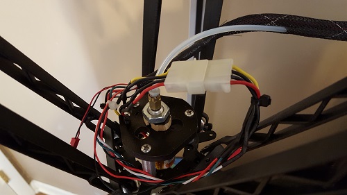

I decided to use a Molex connector from some older spare computer parts. I was working on the last thermistor lead and while stripping the wire, pulled the entire lead out of the thermistor. Luckily I have an extra thermistor I bought on eBay a few weeks ago. I was able to remove the old thermistor and add the new one easily. I tested the hot end resistors and thermistor. It gave me roughly the correct resistance values. I put the hot end back in the printer and was able to heat the hot end to 100 C. Now on to the rest of the tuning later tonight.
Here is the new disconnect plug for the hot end.

I am a great fan of connectors for the hotend, but would it not be more logical to have long cables on the connectors, so all of the connectors are on top, attached to the build plate.
I think one could eliminate all the danglies and make a leaner looking hotend this way.

If the goal is to remove the hot end and exchange it quickly, I don't think the connectors being at the top of the printer would work well. I may want to feed more of the cable length in to the top of the printer thus reducing the wires around the hot end. However right now I'm still working on basic functionality rather than looks or quick changes. I do appreciate the suggestion.
