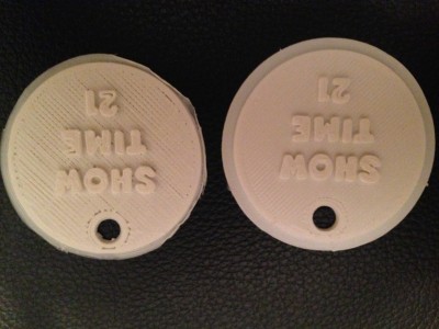

I've had my Rostock Max for a couple of months. It's the first printer I've owned and am quite pleased with it. I purchased Simplify3D a few days ago and at first I was very impressed. It is by far the fastest slicer I've tried. Overall I love all of the features it offers. However, like quite a few others I've been having trouble with gaps between my perimeters and infill. I've played with all sorts of settings and haven't been able to figure it out. I thought I had calibration issues and spent many hours printing and measuring etc. I went back and printed a small object with Simplify3d and then Slic3r. Slic3r had no gaps ( well maybe one small one that was barely visible). Simplify3D leaves gaps all over the place. I tried to match the settings from Slic3r as close as I can to no avail. So, my conclusion is that it must be in the G-code (which I have not taken the time to study) .Maybe someone smarter than me can figure it out, because I seem to be failing. I truly want it to get it figured out because I really like so much about it. But, if I cant produce quality prints, then I will have to use Slic3r and patiently wait for it to slice.

I've attached my factory file and a photo. I appreciate any help.
You can see that it looks like I'm under extruding but I can't figure out what to change. My settings match what is in Slic3r. I've been cautioned though that they slice very differently and settings are not necessarily interchangeable.

2 places where we can change values to help fill those spots are extrusion multiplier and filament diameter, have you actually measured your filament to ensure it is exactly 1.75?
Re: Simplify3D ver 2.0.0
I did measure and it is right on the money at 1.75. I left the extrusion multiplier since that is what it was set to in Slic3r and produced a good print. The extrusion steps are set in the firmware right? Unless there is some additional math going on in Simplify that might effect the extrusion?bubbasnow wrote:2 places where we can change values to help fill those spots are extrusion multiplier and filament diameter, have you actually measured your filament to ensure it is exactly 1.75?

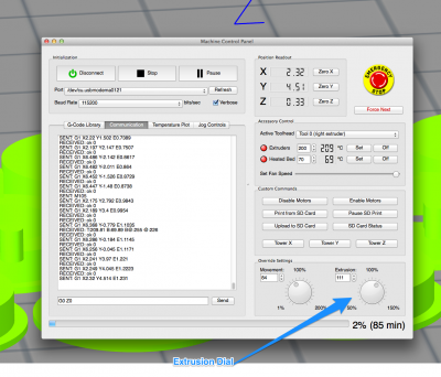

Well, it looks to me that this is the Extrusion Width.Pdegior wrote:I've attached my factory file and a photo. I appreciate any help.
It tried to upload the factory file but it won't allow it. Here are some screen shots instead.
Thanks for the input.
I would start by changing the Extrusion Width to Manual, and set 0.55 (10% than the nozzle), just to establish a baseline.
Then, in the infill menu, I would change Outline Overlap up to 35%, to make the infill touch the outlines perimeters.
Try to print with this settings. Most probably, your print is going to be a little better as the infill will touch the hole in the piece; however, the rest would be similar at your previous print.
Now, start playing with Extrusion % (the dial you see in the printing menu, besides to Speed %). I do this while printing, so I can see the changes inmediatly. You could start with Extrusion at 100% for half of the print, then change to 110% other half, 120% and 130%. You will see the difference in each part with different extrusion %. Of course, you could test with lower % (I mean, 90%, 80%, 70%,etc). Once you got it right, you can set it fixed in Extrusion Multiplier and get back the dial Extrusion to 100%
My bet is that this will fix your problem with the infill being "thin"
The other problem, the infill not touching the outline perimeter, should be fixed with the parameter I mentioned before (Outline Overlap).
And yes, same parameters in Slic3r and S3D would not produce the same results

Just to be safe, this is the dial for Extrusion I am talking about.Thanks for the input.

Did you manage to fix this?
I did for the most part. I increased my extrusion speed and also increased the overlap setting to try to make sure it covered any gaps when changing direction.
Great!Pdegior wrote:I did for the most part. I increased my extrusion speed and also increased the overlap setting to try to make sure it covered any gaps when changing direction.
I am not sure if it is related or not, but I had been experiencing perimeters with not infill (even though infill was 30%) for small walls AND gaps.
I just discovered that, lowering the value of the "Extrusion Width" to the same value of the nozzle (in my case, 0.4 mm), I got the walls to be infilled and, also, it closed the gaps.
Yes, I have, as well, a high value (40%) of overlap infill as well.
I'll try and play with my nozzle setting too. I would have thought that the software would account for this but that might not be the case.
