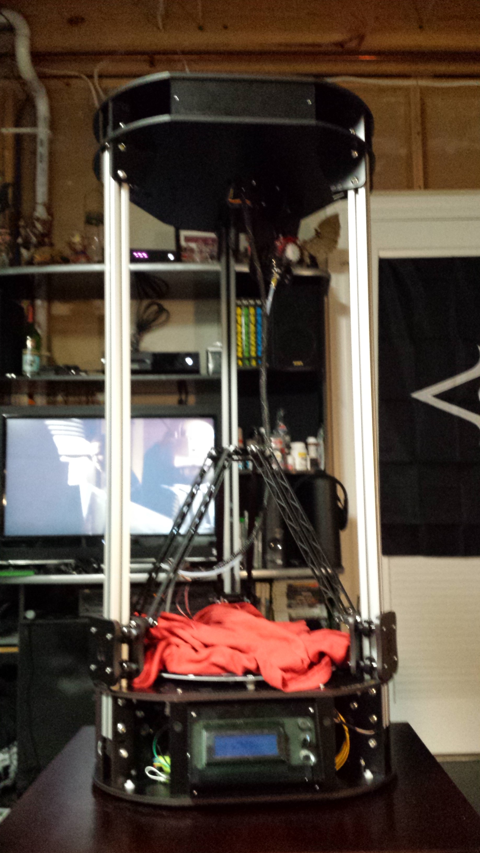

I got myself a rostock max v2 from seemecnc, ill post pics of the build, the upgrades, the prints both good and bad

Re: my first 3d printer
Looks good so far. Welcome to the forum!
Looks to me like you need to be closer to the bed.
For a first layer, those lines are looking pretty round. Personally I would drop it a bit.
Agreed; the closer you can get to the bed without smooshing the nozzle so hard into it that you don't get ANYthing coming out, the better. It gives you nice solid adhesion and a pretty glossy bottom where the filament was pressed to the glass.
thanks guys I recalibrated the printer, and it seems to be working good nowlightninjay wrote:Agreed; the closer you can get to the bed without smooshing the nozzle so hard into it that you don't get ANYthing coming out, the better. It gives you nice solid adhesion and a pretty glossy bottom where the filament was pressed to the glass.
