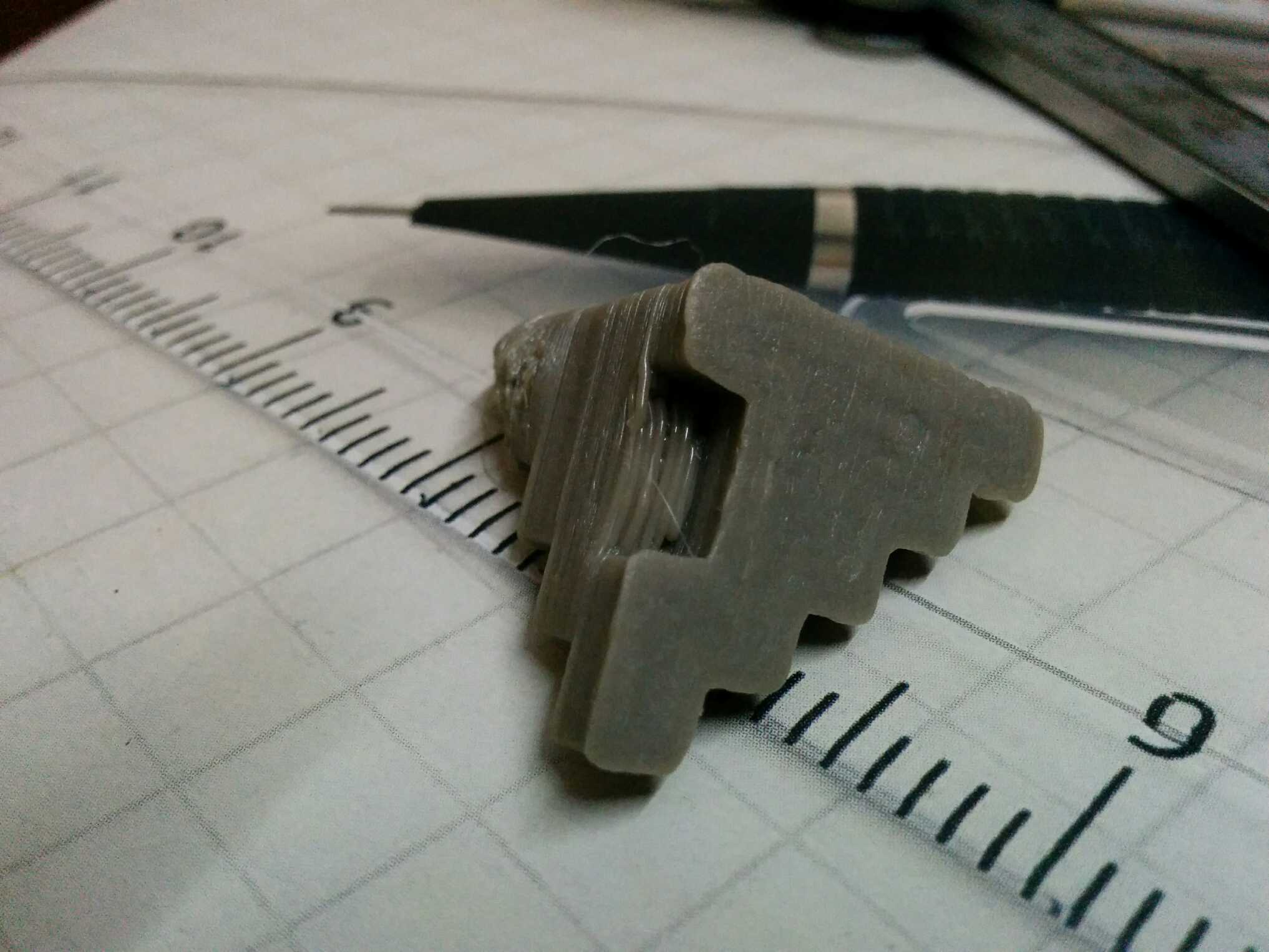

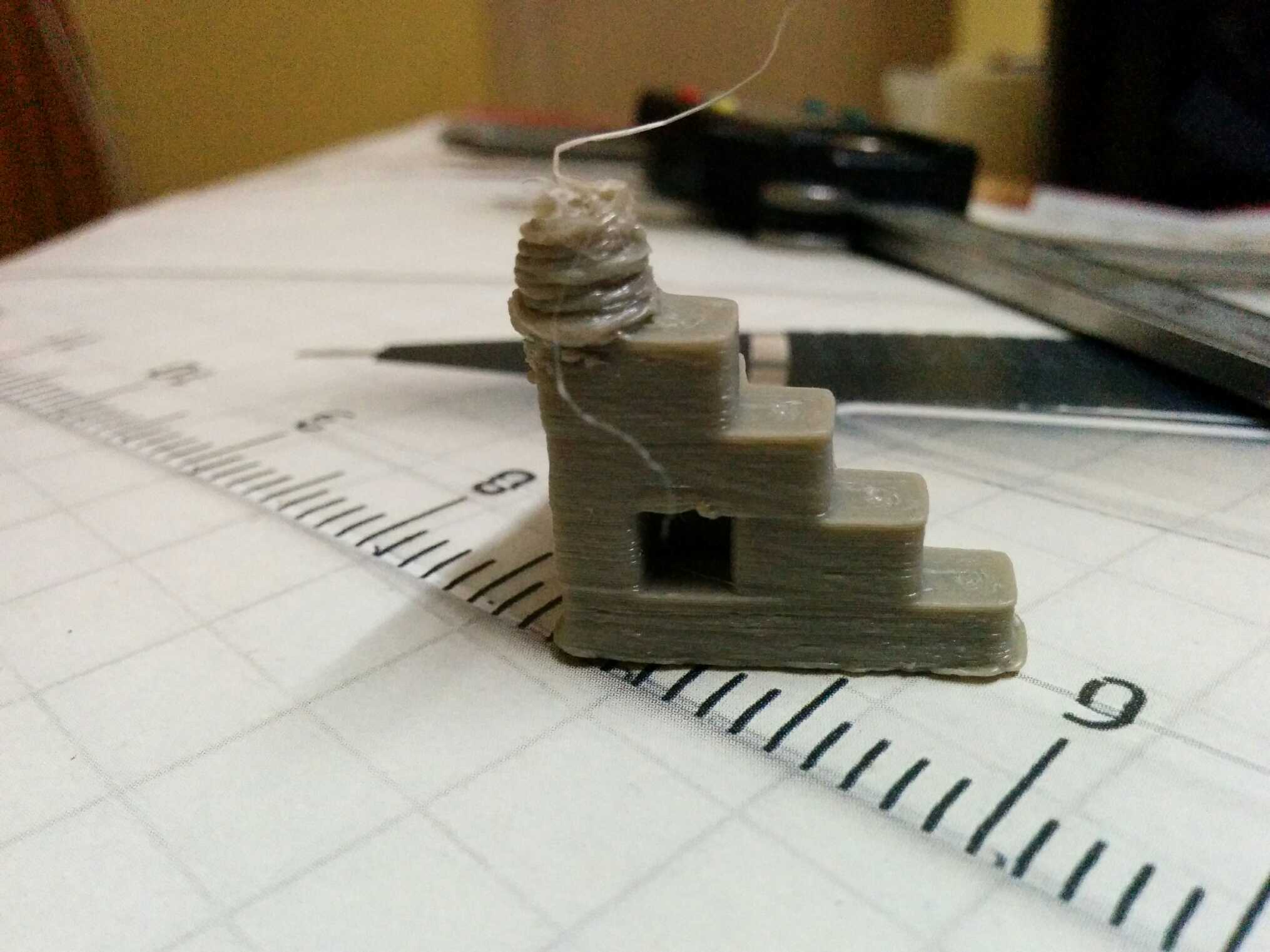

Team and Experts,
I could successfully print on the Rostock V2, while have some calibration issues, Hope people who have seen it can crack it as soon as you can see these pics.
According to me it looks, One Arm, mainly the Z arm is bit lower when compared to the other arms, while seeing this print, But again people who are experts with Delta can correct me or suggest me.
I shall be happy hear out.
Pingnagan P :)
Calib cube 1
Calib cube 1
Re: Calibration Help Needed
Your first layer indicates to me that you're overextruding. Definitely do the extruder calibration.
Everything else looks like temperature/speed melt. Are you using a cooling fan?
