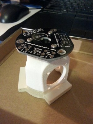

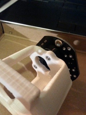

Printed the latest design to trial fit a few upgrade parts. Layer fan is going to be tight.

How fast are you printing there?BONE wrote:Just got my Monolithic Platform with E3D v6 together and working. Worked right really well right out of the gate, super excited. Printed a test piece to make sure that everything worked right and now back onto a customer job. The thermistor on the stock hotend fell out and snapped a wire. There was lots of smoke, luckily I was there when it happened. That silicone does not hold very well in a straight hole.
With the new setup, I gained about 11mm more height and can print just over 400mm now.
Couple of issues with having the new platform close to the bed. One, it's hardier to see right where the nozzle is printing. Second, watch out for the arms hitting the binder clips when getting close to the perimeter. Going to to have to work on both those issues.

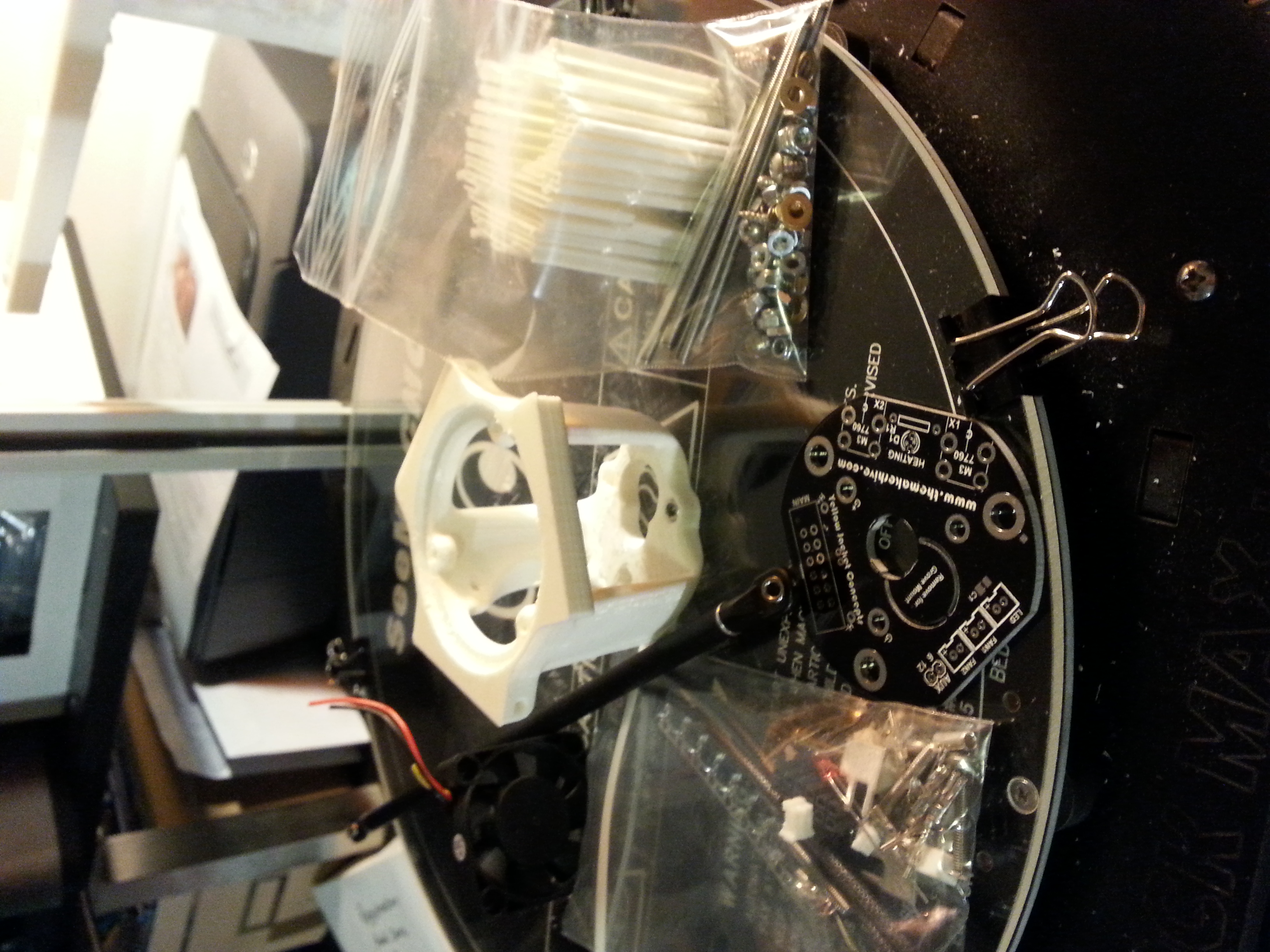

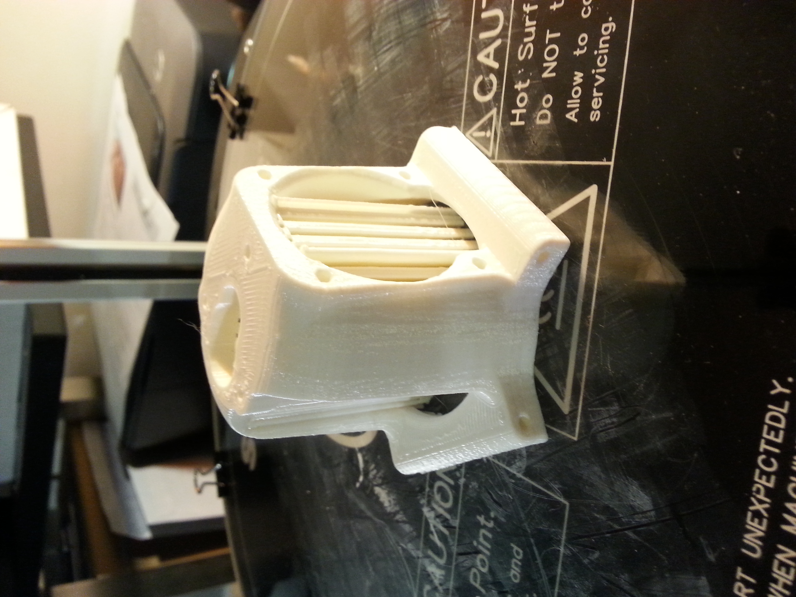

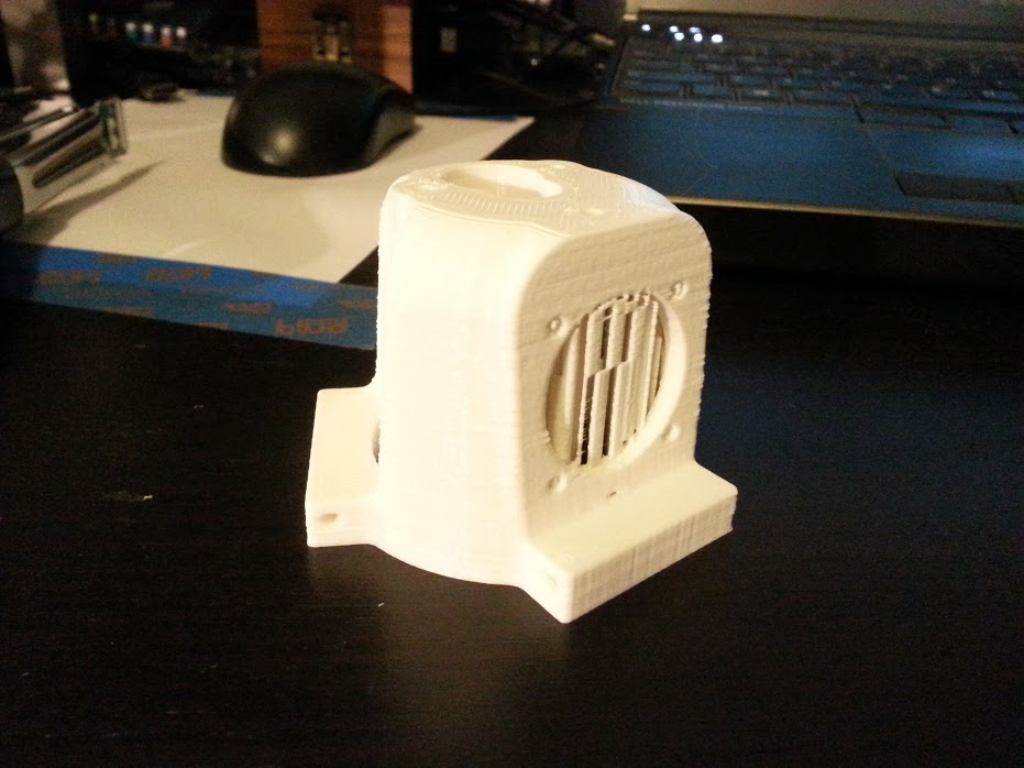

[img]http://s25.postimg.org/9n99hyp4b/20141117_135842.jpg[/img]
[img]http://s25.postimg.org/e6li3h6zv/20141117_135932.jpg[/img]
[img]http://s25.postimg.org/xcyp6nnhn/20141117_140011.jpg[/img]
This is my result, 1:42 print time. Overall happy with fit and finish, messed around with duct for layer fan so as not to be close/blow on heater block. Using 1/8 inch dowel to hold things in place. O.A.L. ended up at close to original due to the fact I wanted to print this as one piece using the original layer fan that came with the kit, and keep as much airflow off of the heater block as possible. With everything assembled and wired, if i keep a fingertip right at the nozzle i can feel what i would call a moderate amount of air. So, all in all I would call it a success. Now to test the benefits(or lack thereof) of a layer fan with ABS and soon to come..... Nylon. Any tips highly welcomed.

Looking good. I don't think you need a layer fan with ABS. But more with PLA. I really want to switch to Nylon soon also.
Are you not having problems with the joints and arms hitting binder clips or the print itself? Might want to test printing at the extremes of the bed to how it prints. I was seeing that problem. I think you're going to have lower the nozzle some more, it still looks to far up the platform.

Wow so many different prints to try. Eatout, what is that black stuff on the bottom of your printhead?eatoutmikey wrote:[img]http://s25.postimg.org/9n99hyp4b/20141117_135842.jpg[/img]

I'm gonna write some simple g code now and test at extremes, but at center of platform I have just over 3mm between glass and clips..... so i think I'm ok.BONE wrote:Looking good. I don't think you need a layer fan with ABS. But more with PLA. I really want to switch to Nylon soon also.
I'm getting an extra hotend from a friend to test everything soon. That way I keep printing stuff and developing the new platform.
*Update* So after running a bed level script..... It does not rub.... I wanna say the closest it got was about 1.5mm from the glass, which I am extremely happy with.

It's abs from a failed print. Had a part come off the plate and wasn't there to notice. Made quite a mess, but easy to clean up....just get the thing up to temp and wipe with the rough side of a sponge.Fiddler2070 wrote: Wow so many different prints to try. Eatout, what is that black stuff on the bottom of your printhead?

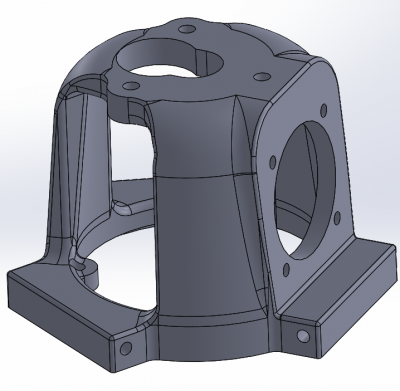

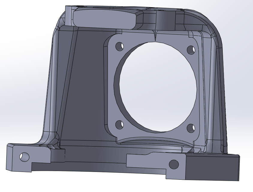

Here's my latest one. Going to print tomorrow or this weekend and try it out. The model is rough and I just hacked it together to get a prototype made and fit up all the parts. I plan on cleaning up the fillets on top of fillets and making the styling smoother at a later date. Dimensions are on the tight side, so some filing and fitting up of components may be needed.
On the outside.
- Rod holes are 2.80mm, so drilling and reaming needs to be done ensure a proper fit and clean out rough edges. Suggested not to print support inside those holes.
- 37mm dimension between flat to maintain the distance needed for stock joints or Trick Lasers.
- 30mm layer fan mounts to the outside.
- Use the Yellow Jacket E3D v6 mount for holding the hotend in place. Yellow Jacket Board can sit on top of the mount. On the inside:
- Mount the layer fan duct to the inside using the screws that mount the fan. (Duct yet to be designed or design your own)

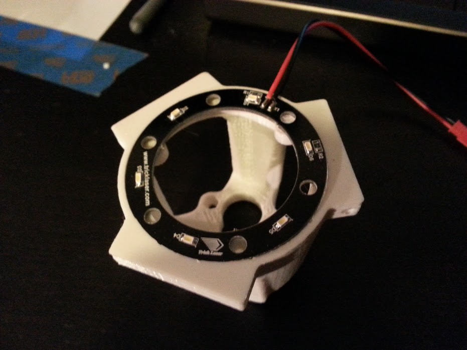

- Use the 3 holes on the bottom inside to mount the Trick Laser LED ring. Un-solder the wires and flip them to the inside for a cleaner look.

Mike is coming up with some good stuff also. It's nice bouncing ideas off one another and coming with new ones. If anyone prints any of these, I love to see pics and some feedback.Eaglezsoar wrote:Thank you for sharing these with us.

Printed the latest version. Looks like everything came out alright and the support material all broke out nice and neat. Just got to take the time to test fit everything. Still need to design the layer fan duct. If anyone has a good design for the duct that goes around and E3D v6, let me know.
The BONE ZONE build thread.
Re: Monolithic Platform for E3Dv6 Hot End
Great looking print! The fact that this works with the YellowJacket mount will make this very popular.
After mounting the Yellow Jacket board, it looks like I need to rotate the mounting holes 60 degrees so the arms don't hit the board. Using some M3 locking nuts inserted in the platform.Eaglezsoar wrote:Great looking print! The fact that this works with the YellowJacket mount will make this very popular.
