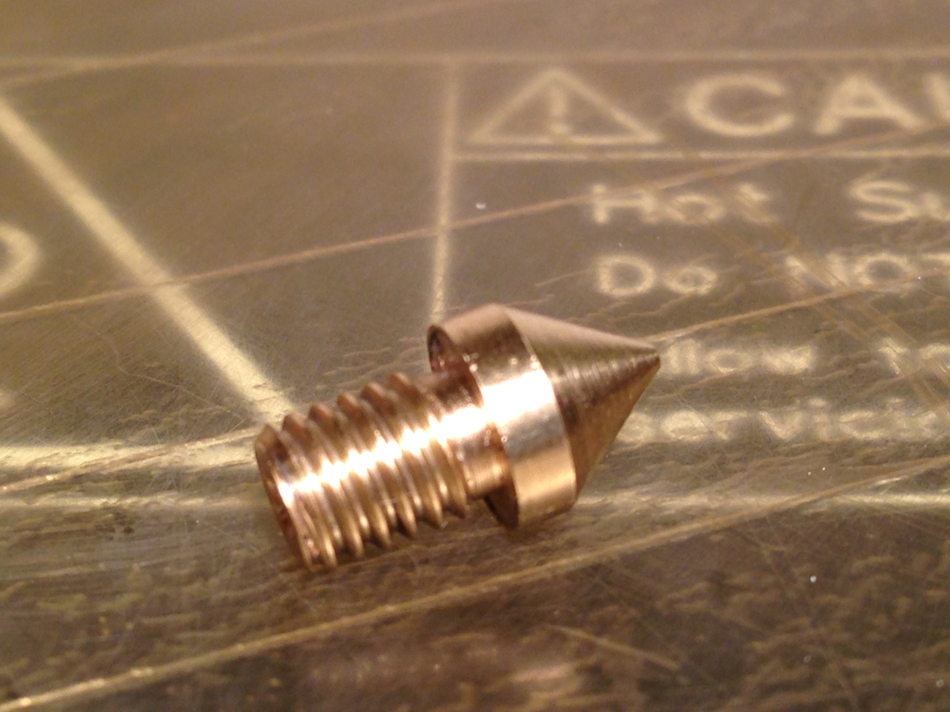

I've started turning my take on a nozzle design for my Kraken. I'm close to being done, all I need to do is drill a 2mm hole, ream it, chamfer the hole with a counter sink, cut M6X1mm threads, cut the nozzle off the rest of the material, cut the angle, and drill a hole for the material to come out. The college I'm taking the lathe class at is woefully under equipped with metric gear, they don't even have metric micrometers.

I'm a few steps closer to having my own custom nozzle. Ive drilled all the holes and threaded the M6 thread.
We don't have any 2mm reamers, so I drilled a 1.5mm hole, and then chased it with a 2mm drill bit, hoping that would leave the nozzle smooth enough.
The orfice I drilled with a .0145" bit (about .36mm). Once I machine the angled part I'll (try to) get some pics of the orfice size.

Re: Mike's Birch V2
Yeah, I got all your settings from that configuration file you posted in your thread. I don't know if I'll get to trying out some more stuff with the auto leveling. I just finished my nozzle today and I really want to try it out. I'm going to make a few more, and I'm going to try to see what I can learn about this one I've made in the next few days.
(The surface finish isn't the best because my tool bit wasn't very sharp, and this one is lacking the wrench flats that I plan to have eventually. The instructor wants me to do all the flats at the same time at a later date)
I don't know how well it will work with PLA (the angle of the bit I used to drill it out was a standard 118 degree 2mm bit, so its a pretty sharp transition from 1.75 to .36), or how well it will work in general. I'm hoping I'll get some pretty nice surface finishes out of it, I've said before a little bit about my theories on nozzle design performance and quality (sharper the point the better the finish, but if its taken to extremes (the Merlin hotend) it can impact performance). This is assuming the internal angle (transition angle? I don't know proper terminology) is pretty close (if not) the same as the outer angle. More simply put, the sharper the point of the outside, the better the surface finish, and the sharper the angle on the inside, generally the better performance. This is all by observation of the different hotends I've used, and the different prints I've gotten from them and from what I've seen of other's prints.
Back to my nozzle and my machining class, I found an appropriate test print to bring in tomorrow. I'll post some pictures wether or not it turns out...
