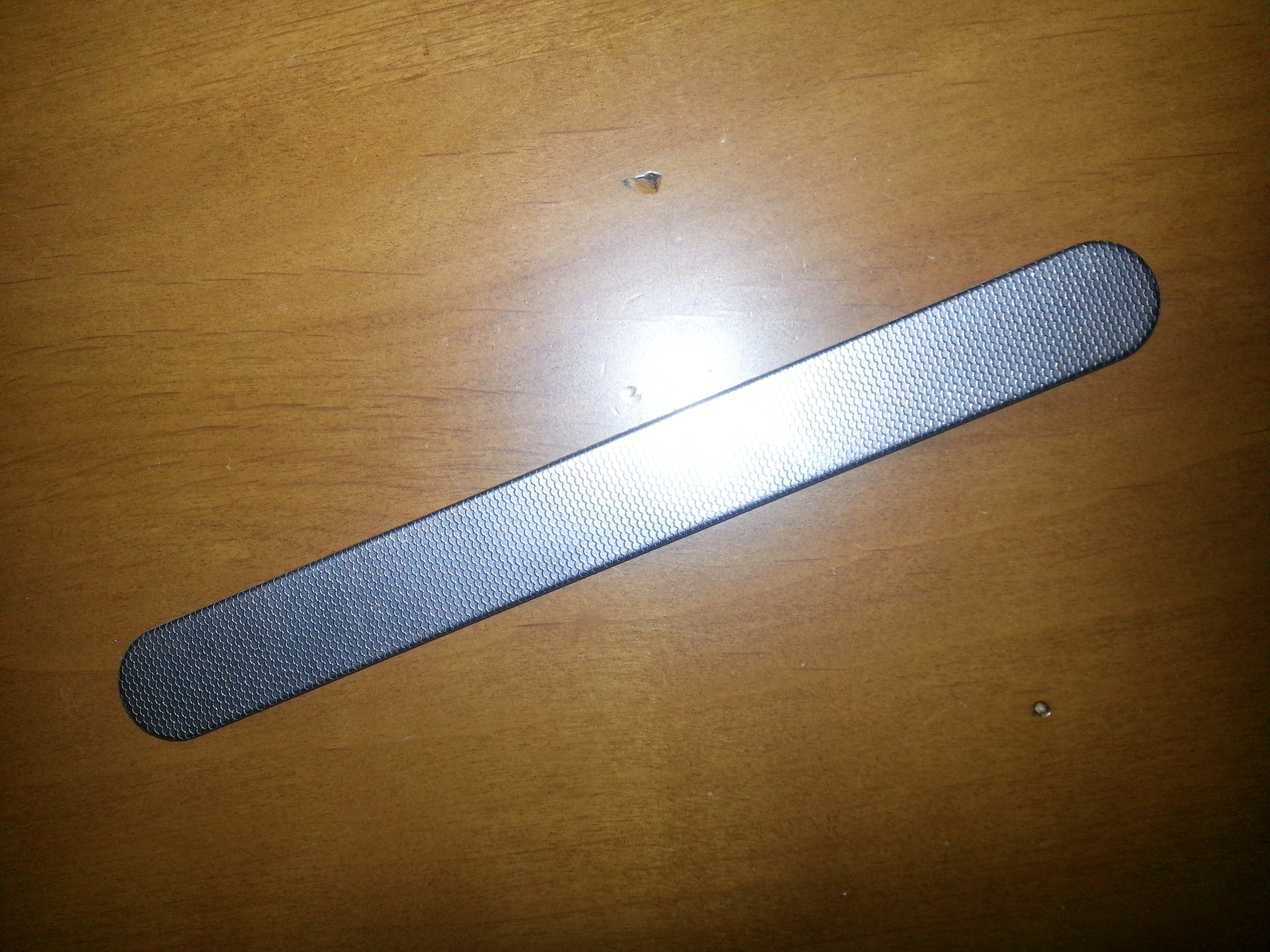

Funny you should ask about sanding posts, I literally just did this tonight. This part is ABS but I think PLA would work the same. I used 400 grit wet/dry paper. I cut a strip about 1/2" wider than the length of the post and long enough to wrap around it to form a "U" with about an inch on each side. Does that make sense? Then, under flowing water (sink) I simply pinched the two ends together with the post in between and rocked it back and forth around the post, say about 90-120° if possible. If you can go all the way around, even better. It is best to remove any blobs with a knife first - or use an emery board (the kind women use to shape their finger nails).

"(the kind women use to shape their finger nails)."
Taking a risk here :) the wife doesn't know I took this. It's laser etched with a pattern that cuts one direction and smooths the other. It's mean't to take the ridges off fingernails. It works fantastic for taking off very little material. I don't remember the brand? You can find them in almost any pharmacy.
Re: How to get good bonding for pillars
Excellent - "I" have the exact same one!
