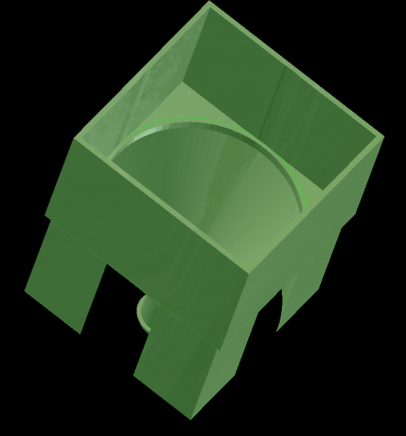

Filament Guide & Dust Collector
Post by tamcofarms »
View1
View1
Actual print
Actual print
I created an all-in-one filament guide and dust collector for my Rostock Max v2. It snaps into place in the existing filament hole on the top of the machine. I live in the desert and am not 7 foot tall so something that wipes the dust and allows me to blindly feed the filament made sense.
You can get the files here: http://www.thingiverse.com/thing:375151

Cool,
how does it wipe dust?

Hey tamcofarms,
That is a really nice design, and a very good print, but I'm not sure how that's going to keep dust off the filament.
if you make the aperture too small, it will grab the filament and starve the extruder.
any larger than that, and dust will fit right along with the filament.
Why not try something a little simpler, like this?

gestalt73 wrote:Hey tamcofarms,
[img]https://i.imgur.com/2ciqJyP.jpg[/img]
All you need to do is shove a couple of pieces of waded up cotton cloth in the box after feeding the filament, big enough not to fit through the funnel and not too tight. The object is to wipe the dust off. I am working on a grate that will fit in the bottom with holes big enough so that you can feed no matter the angle the filament takes but will ensure a sponge can't get through.

If you decide to print this using Repetier you need to scale up by 10. For some reason every time I design something using AutoCAD and export the stl file the size is always divided by 10 even though I use mm for my units.
Once printed you just use a sponge or other dust magnet in the box. This is designed to fit exactly in the pre-drilled hole for the filament.
Posts: 1407
Re: Filament Guide & Dust Collector
Post by Mac The Knife »
It sounds like autocad is exporting your file in inches.
Mac The Knife wrote:It sounds like autocad is exporting your file in inches.
It sounds like that to me also but why 10? Wouldn't it be closer to 25?
I am far from being a Cad expert but the 10 just doesn't sound right.
0110-m-p
Posts: 455
Location: Atlanta, GA
Post by 0110-m-p »
Sounds like it is changing the units to centimeters...that would make it off by a power of 10.
0110-m-p wrote:Sounds like it is changing the units to centimeters...that would make it off by a power of 10.
That sounds correct, thank you!
