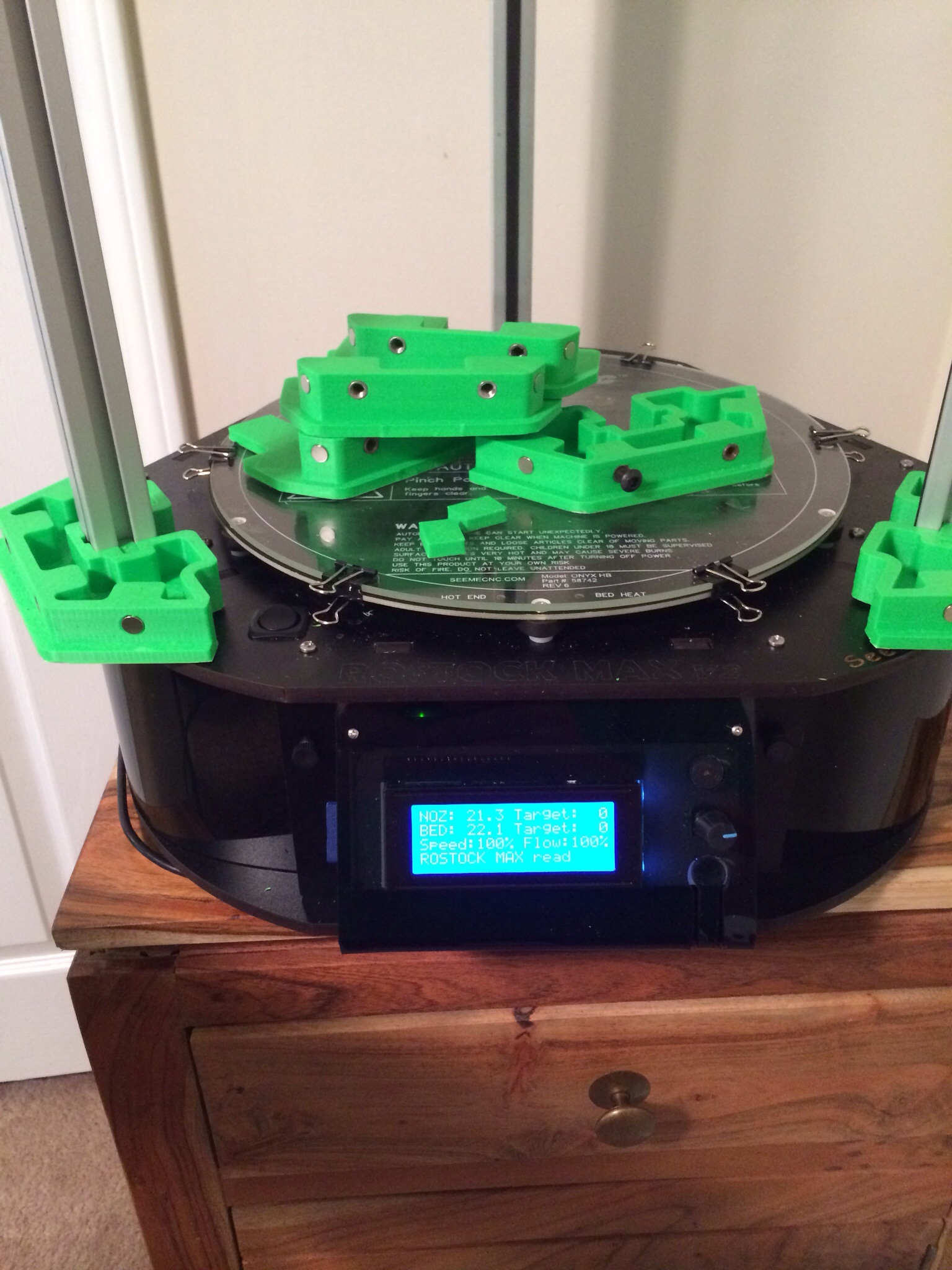

Good thread. If anyone is wanting to make this for the v2, I've modified the files to work here: http://forum.seemecnc.com/viewtopic.php ... =25#p52124
Re: Enclosure build to print ABS and Nylon bigger and faster
Got all the heat-set inserts installed and will hopefully be finishing it up this weekend. Still trying to decide if I want to spend the money on 1/4" acrylic panels for the entire enclosure or if I want to do painted wood with acrylic windows (would be MUCH cheaper).
Anyway on with the pictures...
Heat-set insert installation tip installed in my 40W soldering iron. Setting "4" on the iron seemed to work well.
[img]https://farm8.staticflickr.com/7580/151 ... c98f_b.jpg[/img]
Pre-loaded inserts into the first top and bottom mounting bracket. Holes are a little undersized for these inserts, but a bit of extra heat fixed that problem.
[img]https://farm8.staticflickr.com/7466/151 ... 2096_b.jpg[/img]
First set of inserts installed....really gives printed parts a more professional look.
[img]https://farm8.staticflickr.com/7580/155 ... e632_b.jpg[/img]
All mounting brackets complete with heat-set inserts...
[img]https://farm8.staticflickr.com/7570/155 ... a515_b.jpg[/img]
Shot of the stainless hardware and polycarbonate hinges that I am planning on using. Hinges will look awesome on acyrlic/polycarbonate doors...maybe not so much on wood
[img]https://farm6.staticflickr.com/5616/157 ... dcaa_b.jpg[/img]

I noticed you have a MAX V1 as I do, how did you fit the upper enclosure mounts to the V1 upper melamine plate?
edit: okay I see they will in fact fit over the upper pulley mounts.
Next question; the E3DV6 hot end cold section probably is not going to be happy in this elevated temp. Piece of cake for the water cooled hot end guys, anybody have experience with the E3DV6 in an enclosure? Printing ABS.
I enclosed my Rostock Max V1 with Polystyrene foam insulation panels lined on the inside with radiant barrier insulation. I printed some brackets made to hold sheets of acrylic that I found here and taped the foam to them with foil tape. I did not put foam on the front due to lack of a door design. I just finished it off with a double layer of radiant barrier insulation with a hole cut in the middle which I cover with a sheet of acrylic attached via velcro (which I have hinged on one side with foil tape) and also some foam weatherstrip to help the door get a tighter seal. I also excluded the extruder from the inside of the chamber with radiant barrier insulation. On large prints that really need the heat I cover the really thin window with a piece of radiant barrier insulation held on with blue painters tape. All holes on the top and bottom plates of my Rostock are also covered with painters tape, as well as any gaps between the insulation and printer. I didn't want to put permanent tape on my printer where it would leave residue if removed. Overall it looks terrible from the outside but I get chamber temps of 60C+ which has let me print some pieces in ABS that would've otherwise cracked (I know because I couldn't print them before without splitting). I also switched to a PEI build platform which is wonderful.
My E3D has had no issues printing ABS even with the chamber hot and the bed at 115C (which is actually too hot and causes weird shrinkage at the bottom). As for PLA, my E3D has never printed PLA and even if yours does why do you need a hot chamber for PLA. I've settled on 90-105C as a good temperature, depending on room temperature, part size, and my particular mood when I'm playing with slicer settings that probably don't need changed. I've had some things stick wonderfully at 90, and some warp. Some plastics are fine at 105C, some get weird hourglass warping at the base. The cheap ABS plastics are the ones that like to warp in weird ways, and actually tend to curl off the bed too. IIRC before I exhausted my supply of ProtoParadigm ABS I was printing it at 103C or some odd number between 100 and 105. I forget how I arrived there, I think I measured bed temp with an IR thermometer and that was actually a true 100C or something. I've been playing with mainly Nylon for the last few months so that's my current experiment.
I've been planning on re-doing my enclosure to make it prettier but it's functional right now, and at the end of the day my printer is making damn good prints and that's what really matters. I'm afraid an all acrylic enclosure wouldn't get hot enough without active heating. Fun way to test your enclosure temp without using a thermometer, although not as accurate as a real thermometer: turn on just the heatbed and see how hot the extruder gets at it's home position up top. If you can hit 60C up there then you're doing it right!
