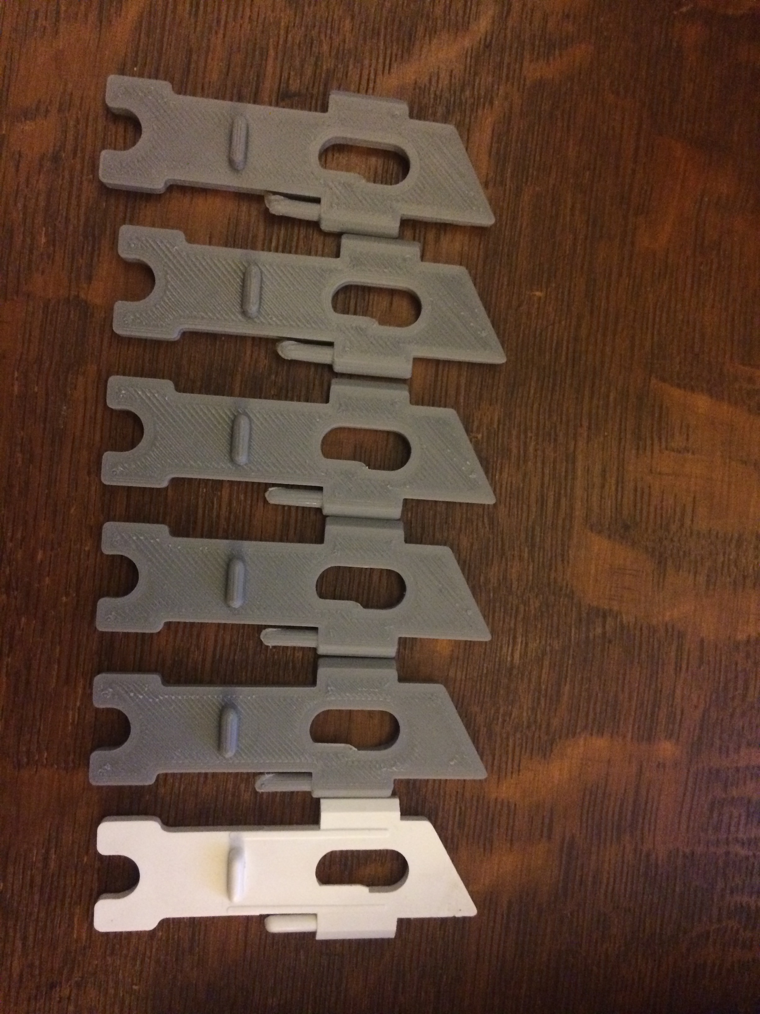

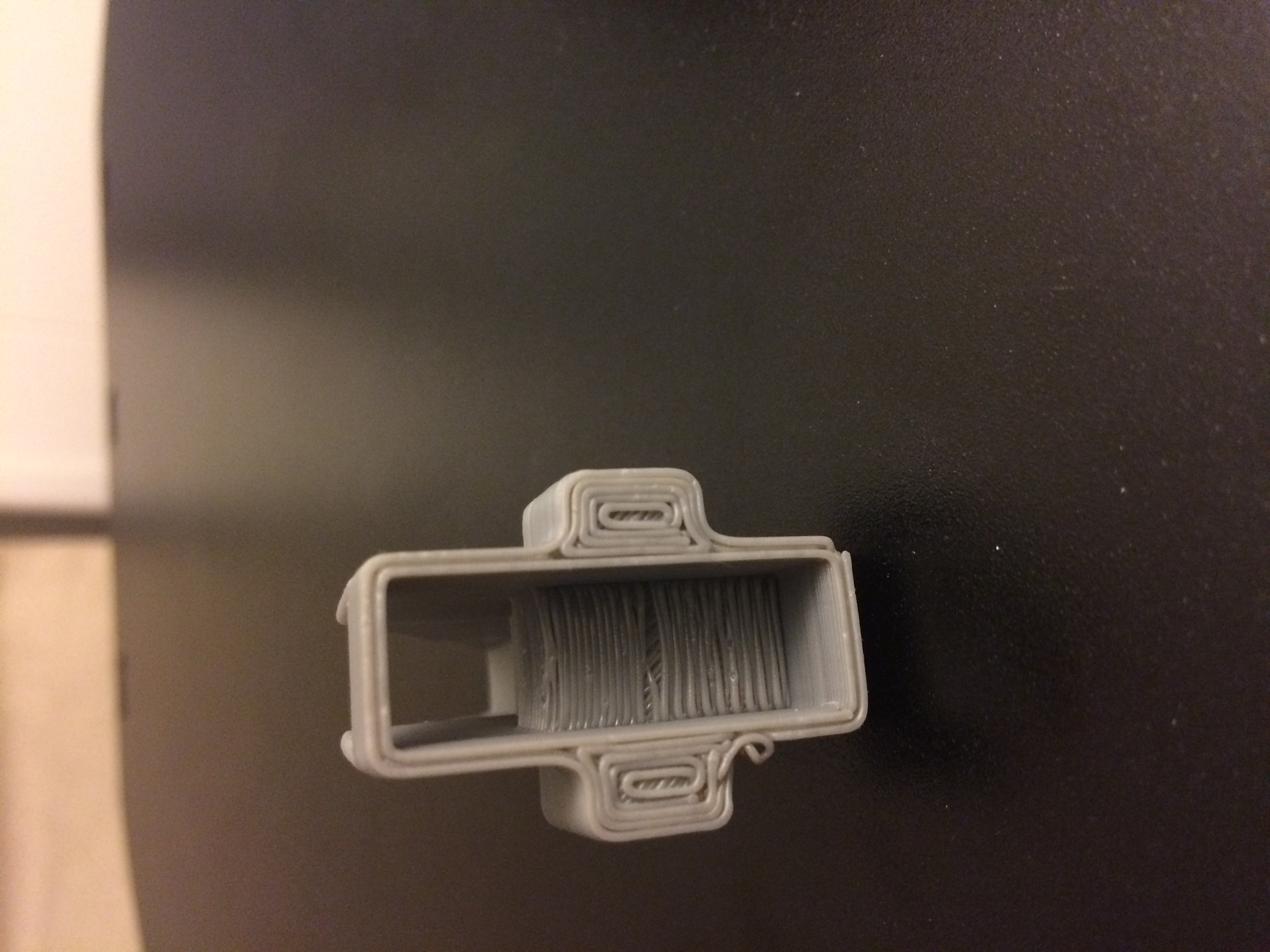

So my first print. I'll admit I did not collect the elmer's glue stick mentioned at the beginning of the guide because it did not mention I would be printing in ABS and I figured I'd start with printing PLA. Of course, there was no way I would have a completed 3D printer and not be printing something on it, so I did some research. Some people were having no problem printing directly on to Kapton tape and I had plenty of that. So I put some down and had my first go of printing the fan shroud. You can see in the attached images how that went. I then tried spraying some "extreme hold" hairspray on top of the Kapton tape and setup another print. This time I stopped it only a few seconds into the print because the ABS was visibly not sticking and even getting hung up on the hotend. Finally, I found some decade-old "Ross Stik Washable Glue Stick". It's consistency was more of rubber cement than glue stick, but I smeared that stuff all over the glass bed anyway. Lo and behold, I got my first print out. Stuck so well I had to remove the bed and use ice cubes to cool the plate til the print released.
It came out well enough to do it's job, but it definitely has its flaws that I wouldn't want to see in my future prints. I've provided plenty of images, I hope you guys will pick over them and maybe offer up suggestions to get rid of some of the flaws like the spaces in the walls, the unflat base, and the strangeness in the bridges and overhangs. Also, my printer dribbles a lot before printing. I sit there and pick the excess extrusions off just before the printer goes into action so its not dragging around extra plastic. Is there anyway of stopping this? My first goal is to enclose the work space. It doesn't need to be heated, I'd just like to protect the print from drafts and myself from the smell.
