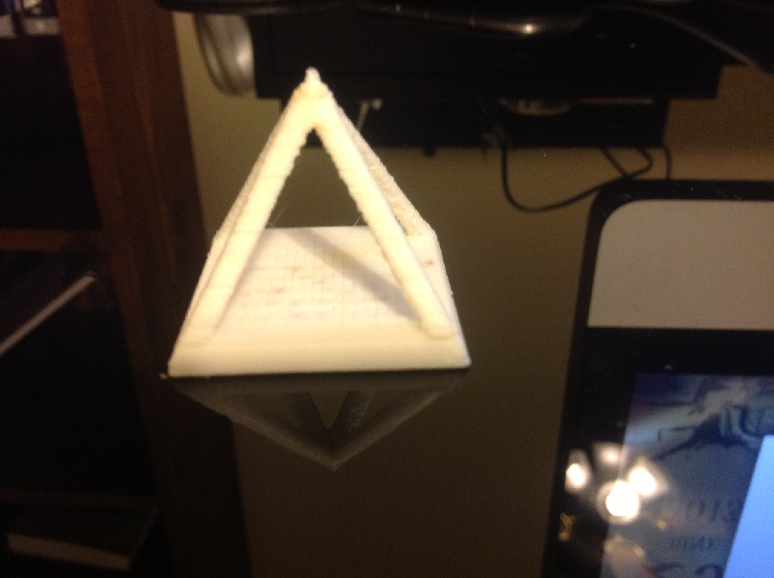

dunginhawk
Posts: 361
Joined: Thu Oct 23, 2014 4:12 pm
Re: Rostock Max Hollow Calibration Pyramid Challenge!
Post by dunginhawk »
The flat surface is amazingly smooth. Filament is Hatchbox PLA at 190C, Simplify3D slicer with .25 layers, 20mm/second travel speed and 1 120mm fan at 100%(need to go to 2-3 blower style).
Hax0red.. how do you like the hatchbox PLA? i have a bunch of the PLA and a bunch of the ABS.. its honestly all ive bought so far (new to this). Seems like you got good results. Just curious as to how it compares to some of the others.. Its cheap, thats what i like.
dunginhawk
Posts: 361
so here is mine... im actually really dissapointed... the close up does make it look worse, but i had a little stringing, and the blob on top...
the outside edges look REALLY good, but the inside are a little off.
wondering where to touch up... i think i need to work on the retraction piece of things.
edit : it did not peel up and deform the bottom right corner, its just sitting awkwardly on a piece of paper :)
