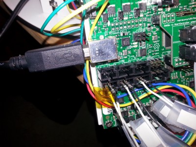

The x, y & z axis end stops were reporting h's when queried with the the M119 command. I checked everything until I found that the pins in the connectors on the rambo board were not making contact. No amount of force, wiggling, or jiggling could make it work. In my 1st attached picture below you will see that I removed the pins from the plug in connections and inserted them directly into the female socket. This caused all axis to report L's as needed.
bare pins inserted in the rambo end stop locations

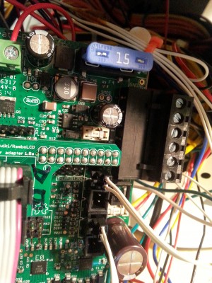

The thermistors both were reporting ~23C, but when I tried to turn the heat up (or on) the control panel shut down. This was true if I did it on the max lcd panel or thru Mattercontrol. The bed heat led will not come on. I pulled the bed and there were no wiring issues, bridges, shorts, or broken connections. I checked all the plug in & screw in connections on the rambo board but the issue persists. Again this issue is true of both the hot end and bed heat. All fuses were checked several times and are good to go. Again, no amount of force, wiggling, or jiggling could make these connections work.
thermistor connectors
So is my p/s supplied with the kit underpowered?

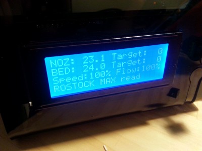

gotta love that cool blue lcd

You should leave the thermistor connectors alone. There is nothing wrong with them. We know this because the LCD screen is showing ambient temperature values meaning that it is reading the thermistors properly.
What do you mean by "the control panel shut down"? If the backlight is shutting off then power is cutting out, possibly from a short in the heater circuit. Might be best to start with hot end and heated bed disconnected from the RAMBo. If the LCD panel stays on then, you've isolated part of the problem.
Do not rely on the hot end LED to be the sole indicator of hot end function. LED could be bad, mis-wired, or installed backwards.

Ok - if I have both sets of heat wires pulled out of the screw terminal I can adjust the bed or extruder temp on the lcd panel and the lcd does not go blank (and the rambo does not shuts down either). If I have either one or both sets of red & black wires screwed in I cannot adjust its temp settings without a shutdown.

Bed heat Led is installed correctly. Measured bed resistance at 1 ohm.

Check the 12V output on your power supply. You can easily check this with a multimeter on the input of the rambo board. I'm guessing you're going to read less than 11.7 V, and it drops to zero when the power goes out. I'm guessing you have a bad power supply (I went through the same thing with my recent build). My supply was making a screaming sound with the heaters on, so that's one dead giveaway that something is awry.
