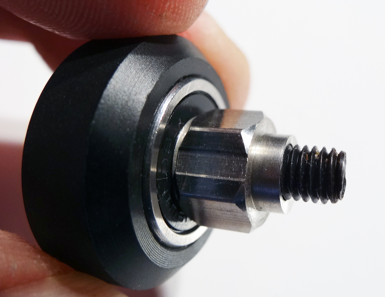

I got mine and put the bearing in the wheels (had one wheel oversized and slip fit), but haven't played with the eccentrics yet. One thing to note...the 1/4" and 6mm is referring to the length of the eccentric so that you match the correct length spacer.RegB wrote:Anyone else get their OpenBuilds parts and try fitting them together yet ?
I may be having a blonde/senior moment, but I had EXPECTED the eccentrics to fit inside the bearings.
Either they fit inside the truck plates or I have the wrong eccentrics.
My order SAYS 1/4 inch eccentrics, which is what Brian has spec'd in a few places.
6mm is the only alternative on their site.
About the eccentric mounting though...it fits into the trick trucks plate. Check out the 3rd picture on this page and you see one of the holes is larger than the other two for the eccentric to fit into.
