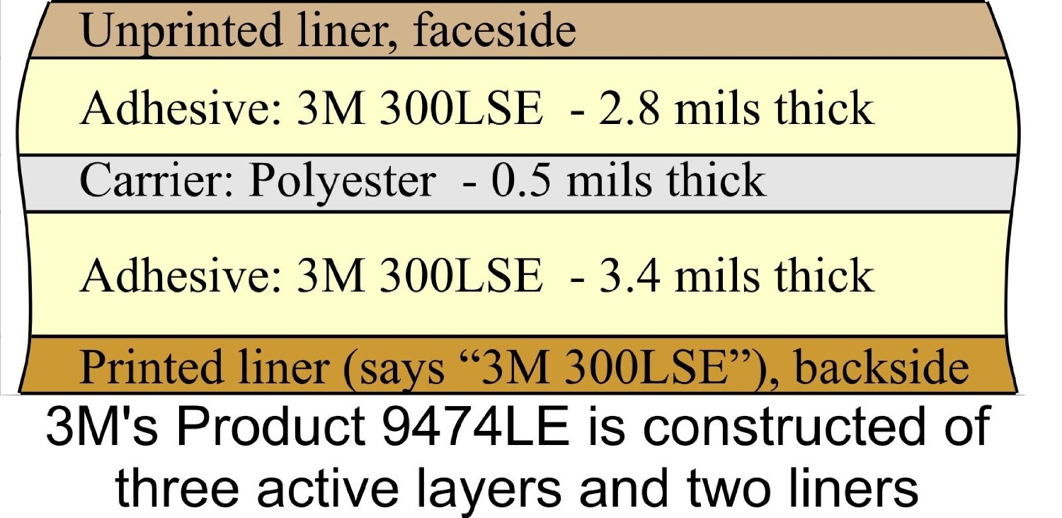

Re: PEI print bed surface experiments
Michael,
I was looking back through the 20 pages of posts, but I wasn't sure what was the latest consensuses was on the layering.
So I went and ordered the 468MP sheet, which has short term heat resistance up to 400F (204C).
http://multimedia.3m.com/mws/media/1040 ... -200mp.pdf
I also ordered the 8153LE 300LSE, which is "Temperature Resistance: 3M™ Adhesive 300LSE is usable for short periods (minutes,
hours) at temperatures up to 300°F (148°C) and for intermittent longer periods of time
(days, weeks) up to 200°F (93°C). "
Looks the 468MP is the better option for heat resistance and cheaper per sheet. I might end up returning the 8153LE 300LSE, but I'll might also be curious to see if it works also.
I also ordered a roller for applying the tape and flatten the layers. I have experience with applying larger vinyl stickers with a card, so I guess that a similar technique is used in laying down the layers for material with the roller.
http://www.amazon.com/gp/product/B0007W ... UTF8&psc=1
I'm also in the same boat currently where my print has been running now stop for the past 3 days. I'm going to be taking it with on Holiday with me just to keep up with a large customer order. Luckily it's all PLA, but I'm getting tired of the glue stick application and cleanup. Can't wait for being able to print ABS with way less issues also.
The heated bed will never go much above 100°C so the 3M 468MP does not have problems. Unlike the 300LSE (which I also tried) the 468MP does not loose adhesion at 100°C and keeps the PEI firmly affixed. Everything else I tried eventually lost adhesion and the PEI pealed off. The RTV silicone was the next best but it finally gave up the ghost shortly too.
A roller like that or a J roller will help. I used a J roller. But be careful that 1) the glass is WELL supported on something dead flat and 2) not to use too much pressure.
I hear you about glue stick, tape, etc. I went through all that. Sure, you can get good adhesion and reasonably nice surface finish but the turn-around time was horrible! Now with PEI it's "pop and print"!
