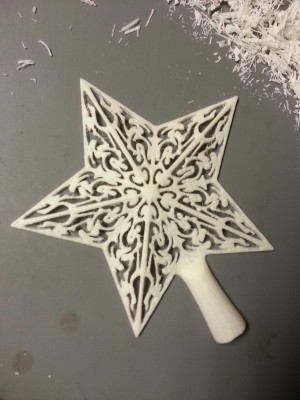

We needed a tree topper for a smaller tree.
This is one half after support removal.
Here is the link to the star:
http://www.thingiverse.com/thing:583200/#files
I cut it in two in NetFabb and printed two halves with support.
Octave White ABS, 235/80 temps, KISSlicer
