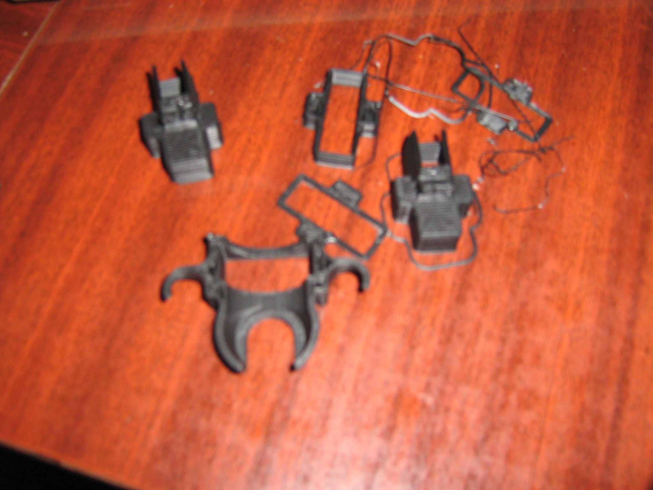

I don't know what to do.
MAX 2 can stop working in any time without any reasons.
Just stop in a 10% , 30% ,60% model not completed.
No have any warnings. Looks like working but no movement

Does it switch off completely ie no power at all or is it still powered on but just stops moving? Does it reset itself when it stops and is it running tethered to the computer or from SD card? If it stays on after it stops is the hotend fan still running and does it keep the bed and hotend heated? More information would be great, it might help to diagnose your problem.
Re: MAX V2 stop working any time he want
its look like press on "pause" but without pressing. Running with computer. I cant move MAX2 by computer with this problem, but can push a reset button on printer, works fine, all towers return to upper position.
Not all fan installed , I dont know running or not .I'm still not finishing second fan. I try print it 5 time !
