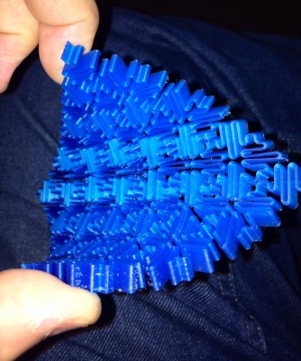

My BuildTak review
As John said, I learned about BuildTak at the NYC 3D printing show a few weeks ago. I was very impressed with the surface finish it leaves on the parts. It has a little bit of texture that is quite nice looking. I chatted with the VP of the company, showed him one of my 3D printed fishing reels, and he sent me a 12" disk to test. I had to order a 2nd borosilicate plate to put this on since I have PEI on my original plate and I don't want both sides covered for thermal conductivity reasons. I've been testing the BuildTak as much as I can between production runs. I'ver probably printed 60 parts in PLA and 20 in ABS. My experience has been very positive.
Firstly, BuildTak's web site says the material CAN WITHSTAND high temps (110-125°C) but I don't print anywhere near that temp. I could imagine that aggressive sticking would happen at these temps. I've been printing PLA at 55°C and ABS at 75°C. The parts stick very well and they pop off with a very pleasing "pop" when they come off. (My hot bed temps are calibrated with a thermocouple so are reasonably accurate.) I had no problems with first layer pealing or curling and my "open weave" tenkara line spools are very good tests for this since they have many small radius corners (like a flower petal) AND they have very low first layer contact surface due to the open infill. When one of these stick to a build surface, I know it's a good one! You do have to make sure your Z=0 is set properly as it is more difficult to remove highly smooshed first layer parts from this surface, probably due, at least in part, to the surface texture.
I also printed this very tricky mesostructured cellular material to get stuck with no problems:
These are both difficult parts to get stuck on any build surface and the BuildTak had no problems with first layer lift or curling. And all parts (well, actually 40 pieces of the line holders since they are printed in 2 halves at the same time) came off with a reassuring and crisp "pop". I do clean the surface with isopropyl alcohol wipes between prints to remove any finger grease, etc. NEVER use acetone on this material, it will ruin it.
I see no signs of wear after 80 prints in the same central area. But, I did not have to use any tools to remove the parts so there was no damage to the surface. I don't see why I couldn't print 100s of parts on a sheet. I like the stuff and now that I have it mounted on a glass plate it is ready to go whenever I need it. I still use PEI for most of my parts since it leaves a nice matte surface finish but for parts that I want a little texture, like some of my fly fishing reel parts, I'll use the BuildTak.
