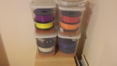

I got these tubs from Morrisons in the UK and I can get 3X 1KG spools in them and they are airtight, think they were £2-3 each and are aimed at cereal storage?.
Indicating Silica Gel beads in the base (lots) with the spools sitting on some small Tripod stands I printed out.
So far I can see no colour change (Turns Green/Blue when water saturated) after several months use due to the quantity so I'd guess i'll rarely if ever have to oven dry the Silica Gel.
I got a reel of ABS filament that had not been sealed properly in the factory so I tried it and it was spitting furiously.. a week+ in the desiccator tub
beside a radiator and it dried it off with no spitting at all. Could have been quicker but I didn't get round to trying it but it does work nicely for ABS.

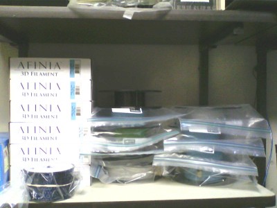

Depending on the brand of filament, gallon ZipLock(tm) bags may work. I like them because I'm not exposing them all to moisture just to get to the one on the bottom.
