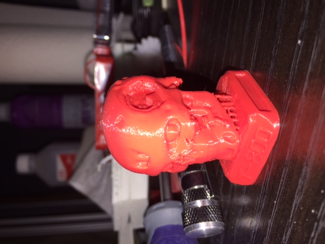

After that I tried printing the t-800 terminator at .25 scale from thingiverse. Attached is how it came out. Usually the hot end does not look like this either.
Using Mattercontrol, but set the Speed: 120% on the Rostock itself as PLA jams happen when its at 100%. I just wonder if dipping into Mattercontrol is not worth it.

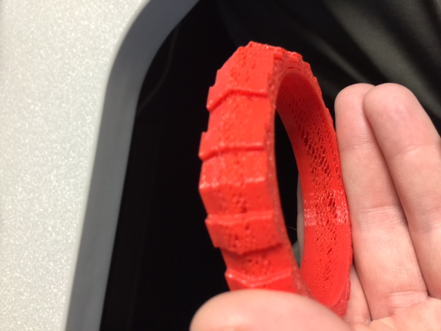

Re: Calibration - Box, top layer issues
Prior to the bracelet above, I printed a Terminator head after clearing out ez struder, Bowden tube, hot end. Support said to go from 110 retraction speed to 60. After doing so, the Terminator head printed well. I then printed a larger terminator head and during the night MatterControl crashed on my Mac. This killed the Rostock print. I believe it caused another PLA jam. After clearing out the ez struder, Bowden tube and hotend again, I tried printing again. This time by SD card. The bracelet is the latest print that's showing major issues. During the bracelet print, I saw the temperature set to 190 drop to around 185c.
Attached to this message is the previous successful print of the terminator head.
