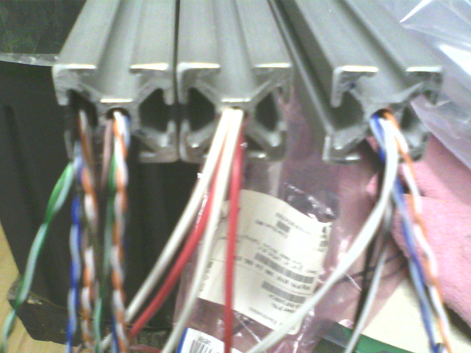

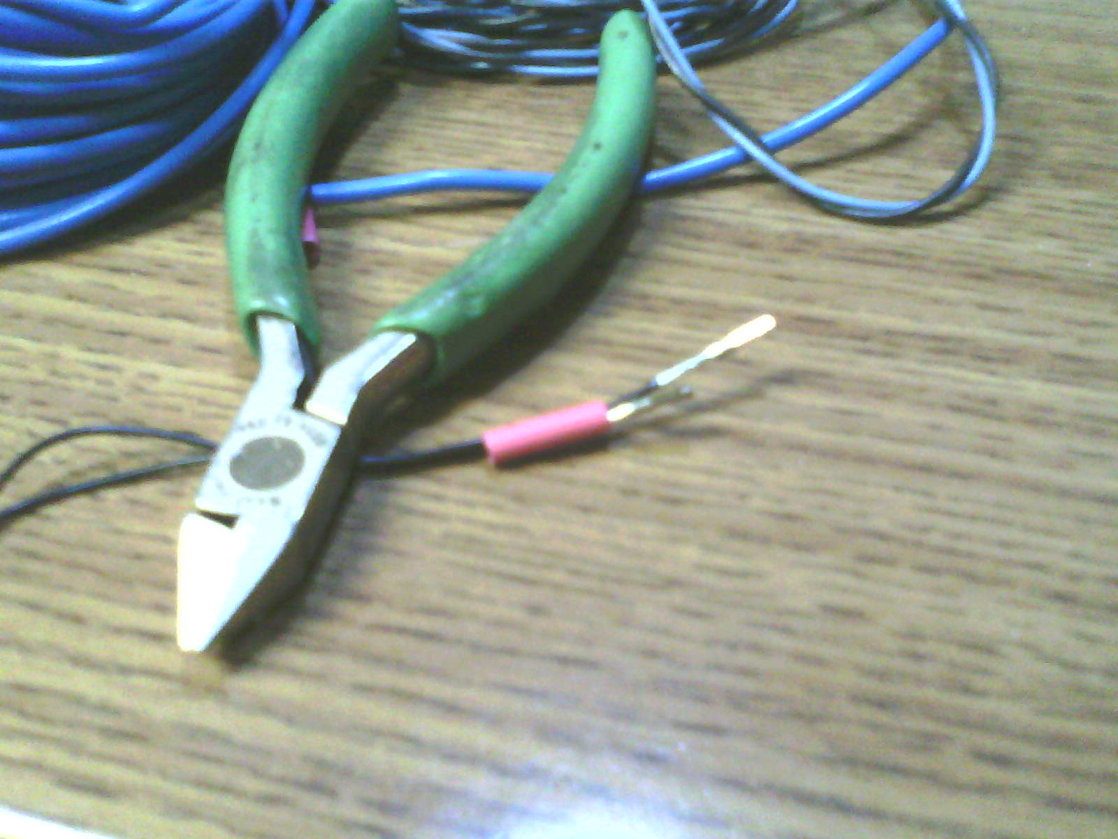

Since there's three end stops that have wires that need to be kept track up, I'm illustrating two different ways of keeping them straight. The first is three different color pairings, white-white, white-black, black-black. The second is colored heat-shrink on the pairs to keep them together.
They're twisted to keep down interference since these apparently have high-ohm load resistors. In my designs I'd both twist AND use a lower ohm resistor to both reduce interference and to keep the contacts clean (a little current switched keeps contacts clean).
To get the connectors through the small heat shrink, feed one at a time.

A very good idea! I have used cat6 patch cables and removed all the pairs and have used them for the endstops.
