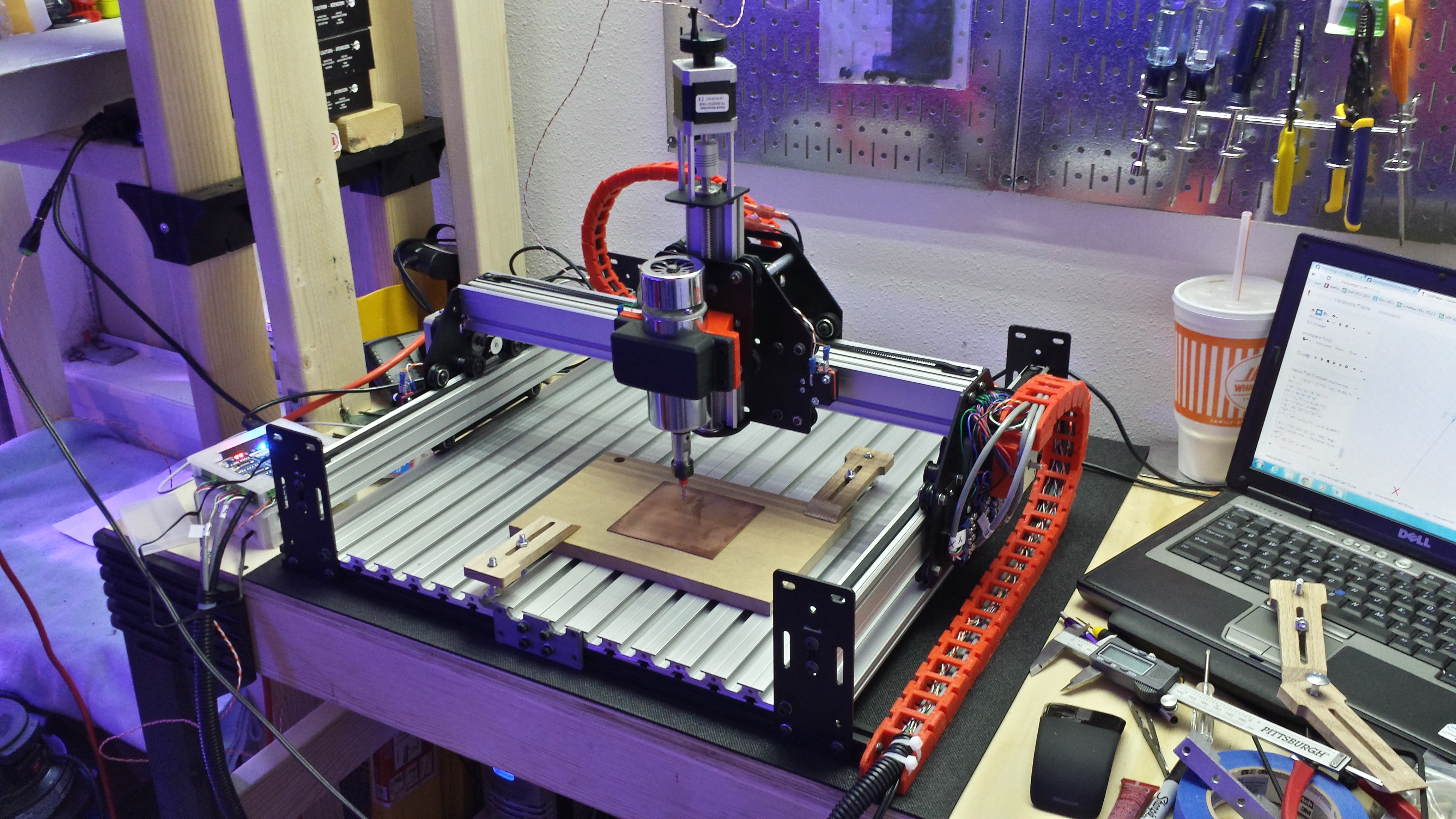

SO, on another subject, Our Makerspace has 2 Shapoko II's. What are you using for a motor and what software? one of ours is using the stock Arduino w/GRBR shield running a Dewalt 20,000 RPM router. I'm using a Lamp dimmer to control the speed. The other I am trying to hook up a Rambo Board with a 400 watt spindle from Inventables.

This is early on when I first got my mill.. Right now I am running the 400W DC spindle but I am soon going to be switching out to a 400W DC brushless spindle for higher torque at lower RPMs.Jassper wrote:The only reason now that it would need to be recessed is for the aforementioned reason that the inner 3 holes on the board are not electrically isolated. but I can easily use a piece of insulation.travelphotog wrote:Jassper wrote:Here is what I am talking about above,

Since this lives in my office I have to stay with this style of motor so I can mill late at night and not keep my other half awake with motor noises in the next room. One of the very best things I have done for my mill was upgrading to a full metal slotted bed. It squared up the mill right away and is super easy to attach things to now. I really LOVE that upgrade. The red cable chain is the very reason I bought my Max for. I saw the need for many printed parts on the mill to get it up and running faster and to keep it nice and clean. My cable chain is one of the very first things I ever printed. It was researching the mill that I first saw the Max V2 and i fell in love with it the moment I saw it. Sitting in the airport in Newark waiting to catch a flight home. The moment I saw the giant Delta I knew I wanted it and that it would be my 3D printer to set up the mill with.
This is my little work area. This is by far the best work bench and storage system I have found and is 100% custom and I love it. You buy the black plastic parts that hold it all together and the rest is up to you. I love this system. BTW the strange glow off to the left is from custom coral farm reef LEDs. I grow and sell saltwater corals in a book shelf type system just off camera to the left. The lights are 10K Kelvin so look super odd to the camera phone.
I mounted my limit switches to my X and Y motor mounts with printed pieces. I also designed and printed my motor mount which works great and has done a far better job than I expected PLA to do. I bought the mill mainly to make PCBs for the many projects I build for reef tank system controllers and now for the remote video dolly systems I make in my spare time. I started milling aluminum as a challenge to myself and those who said a Shapeoko 2 can not mill aluminum. While it is not fast, it does work as you have seen.
For hardware I have the following on the mill. 400W DC spindle with speed controller, Full metal t-slot bed, Upgraded Z axis rod and bearings ( this is also a super good upgrade and worth the cost). I run a TINYg controller for the controller but might be switching to MACH3 shortly so I can use SOLIDcam as I can not find a post processor for the TINYg for SOLIDcam. Right now I use SOLIDWORKS and HSMXPRESS which is a great pairing. I would go to HSMWORKS if I had an extra $7500 for the 3D milling package. I like to barter at times and was able to trade shooting some ad stuff for a local oil valve company for one of their legal copies of SOLIDCAM. Upgrading to a MACH3 or MACH4 system will allow me to take full use of that. I run the mill though CHILIPeppr right now with the TINYg. Over all it is a great combo, though from time to time it has a controller fart and dumps a job here and there (GRRR)
This is my next mill I think https://www.finelineautomation.com/prod ... cnc-router I am limited by the small work area of the Shapeoko. I need the large space for some on going projects. I have good contacts in the music world and custom amps and guitar parts are in high demand, but my Shapeoko limits the size of the projects I can do and has cost me a few jobs already sadly.
