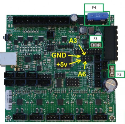

So for the purpose of this example, we'll figure the analog out from the thermocouple amplifier is being connected to pin #3 of the RAMBo analog header. And I'll figure we're using an AD8495 thermocouple amplifier chip as that is what is used on the analog board available from Adafruit and they rock! Lastly, I'm basing this on Repetier v0.91 firmware, where we need to make changes in the Configuration.h file and then upload the altered firmware.
line 187 is where the temperature sensing method for the first extruder is defined.
With a stock thermistor, it reads #define EXT0_TEMPSENSOR_TYPE 97
The AD8495 code is 60. You can see it listed a few lines up comments. Change line 187 to read #define EXT0_TEMPSENSOR_TYPE 60
Next we need to describe where the temperature signal is connected.
On a stock RMV2, the hot end thermistor is plugged into the RAMBo at temp input 0.
line 189 will say #define EXT0_TEMPSENSOR_PIN TEMP_0_PIN
It looks to me like the RAMBo analog header doesn't have defined specifically, so we need to call out our connection based on standard Arduino names. Pin #3 of RAMBo's analog header is actually analog input #6 on the ATMEGA2560 chip.
Change line 189 to read #define EXT0_TEMPSENSOR_PIN 6
Those should be the only changes needed.

The one in the link is analog like the Adafruit board. The linked part uses an AD597 chip instead of the AD8495. It has a different output profile, but appears to be a close cousin of the AD595. For devices using AD595 or AD597, set line 187 to type 100 instead of 60.

The thermocouple replaces the thermistor, and gets mounted to hot end. Unlike a thermistor, the thermocouple cannot be wired directly to the RAMBo/controller. The thermocouple requires some additional electronics. One option is the Thermocouple Board that you linked to. AD8495 is the ID of the chip used on Adafruit's similar board. So you need a thermocouple and the accessory board. Thermocouple wires to accessory board as shown in wiki on that board's page. Board wires to RAMBo in manner I described a few posts above.

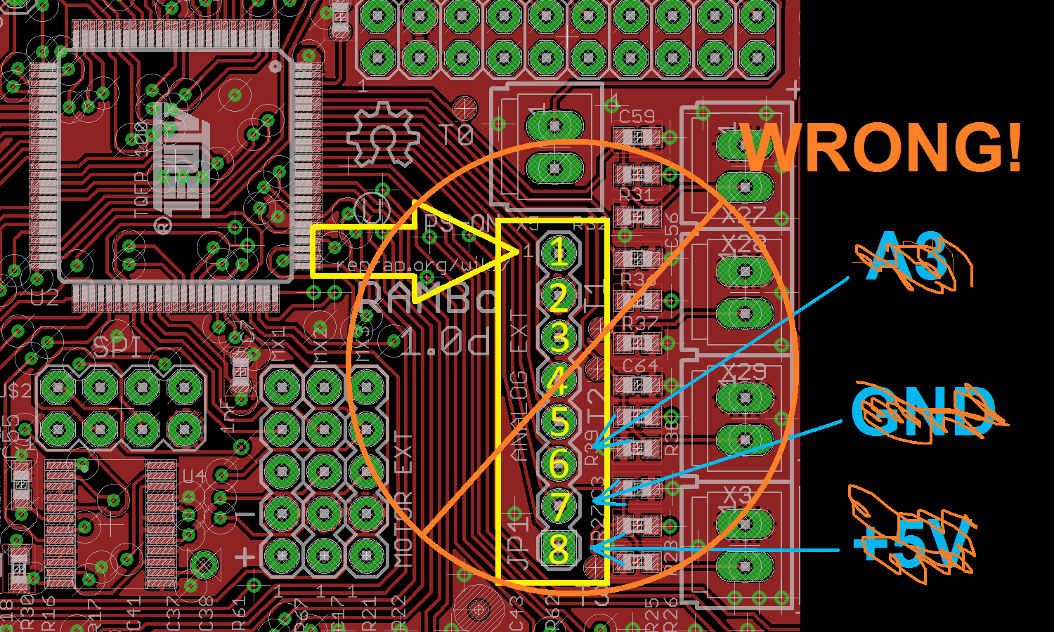

So correct me if I'm wrong... Do I have the correct header highlighted? What makes it a 4x2 header instead of (I'm guessing) an 8x1? I'm worried that I have the wrong one.Earthbound wrote:I'd be happy to help with the pins and firmware side of things. As far as the wiring goes, the analog connector is the 8-pin (4x2) header between the thermistor connectors and the LCD adapter board. Pins 1 (+5V) and 2 (Gnd) of that header can used to provide power to the thermocouple interface and pin 3 or 4 used for the analog signal. I'll take a look at the firmware and come back with those changes.
Also, is #1 indicated by the print on the board that I have the arrow pointing at? It seems a bit odd that the text orientation is 90 degrees different than the "analog ext" label... Perhaps the "JP1" text at the bottom indicates pin #1 instead?

You have found the correct header, which on your version (v1.0/1.1) is a 8x1 row. The later (v1.2/1.3) has a 4x2 header.Jimustanguitar wrote:So correct me if I'm wrong... Do I have the correct header highlighted? What makes it a 4x2 header instead of (I'm guessing) an 8x1? I'm worried that I have the wrong one.Earthbound wrote:I'd be happy to help with the pins and firmware side of things. As far as the wiring goes, the analog connector is the 8-pin (4x2) header between the thermistor connectors and the LCD adapter board. Pins 1 (+5V) and 2 (Gnd) of that header can used to provide power to the thermocouple interface and pin 3 or 4 used for the analog signal. I'll take a look at the firmware and come back with those changes.
[img]http://i.imgur.com/CC1bZ3m.png[/img]
[edit 2/17/15] Discovered that the 8x1 header on early boards is a source of confusion. In the image above, the silkscreen shows pin #1 at the "top". You can see the "petals" surrounding the pad of the adjacent pin, which make it recognizable as GND. The schematic for this version says that pin #7 is GND, so silkscreen numbering is reversed from schematic's.
For v1.0 RAMBo, pinout on that header according to the schematic is:
pin 8 = +5V (SILKSCREENED as PIN 1)
pin 7 = GND
pin 6 = analog input 3
so make the assignment as #define EXT0_TEMPSENSOR_PIN 3

Earthbound wrote:My earlier identification of pins is for the later (current) RAMBo. Your v1.0 board has a slightly different layout. You have found the correct header, which on your version is a 8x1 row. Pin 1 is at the arrow.
For v1.0 RAMBo, pinout on that header is:
pin 8 = +5V
pin 7 = GND
pin 6 = A3 (analog input)
so make the assignment as #define EXT0_TEMPSENSOR_PIN A3
That makes a lot more sense...
So the first time I was trying this (and had the wrong pin called out in the firmware) I was getting a reading of something like 494 and then it would go to default.
After changing it to pin 3 in the firmware, I'm at more like 360 before it goes to default. (if I make it type 60 instead of 100, my reading goes into the 700's)
I don't understand where you say to use pins 6, 7, and 8... I should be using the top 3 pins or the bottom 3 pins? (they both give back a value of 360 and go to default) but I've only got 5v between the top two pins, the bottom 2 (pins 7 and 8) have less potential between them...
Thank you very very much for the help!

Hope the annotated picture makes it easier. I've done one for the early (v1.0/1.1) boards and one for the later (v1.2/1.3) boards.
V1.0/1.1 (the original image here was incorrect. Look two posts down in this thread for correct layout.
V1.2/1.3
V1.2/1.3

There must be some other variant that's not evident on the Rambo Wiki... I definitely don't have +5v on the pins you specify. I measure that voltage across 1&2, but not 7&8... Weird.

After a closer look at the image of the v1.0 board, I realized that the silkscreen and schematic disagree on the location of pin#1. The "flower" around the adjacent pad (GND) is a tell.Jimustanguitar wrote:There must be some other variant that's not evident on the Rambo Wiki... I definitely don't have +5v on the pins you specify. I measure that voltage across 1&2, but not 7&8... Weird.
Suddenly the flipped silkscreen almost makes sense.
Here are the correct connections for v1.0/1.1 boards (number on silkscreen, not schematic) #1 at top.
1 = 5v
2 = GND
3 = analog input 3
4 = analog input 4
5 = analog input 5
6 = analog input 6
7 = analog input 7
8 = analog input 8
