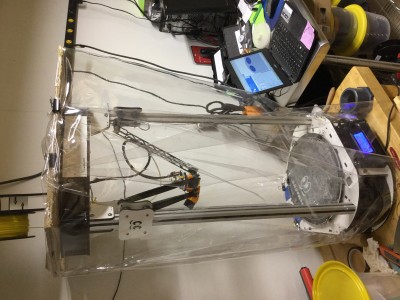

This is my simple eclosure to protect from drafts. Keeps ambient temp up 30 deg F. I have taped off the electronic vent holes to remove that draft source and removed the rear smoked plastic cover to let the electronics vent below the bed surface. The top was just a scrap piece of OSB and the sheet is 4 mil thick plastic for covering windows in the winter ( can be found in rolls near weatherstripping). Door flap and bottom held in place with binder clips.
