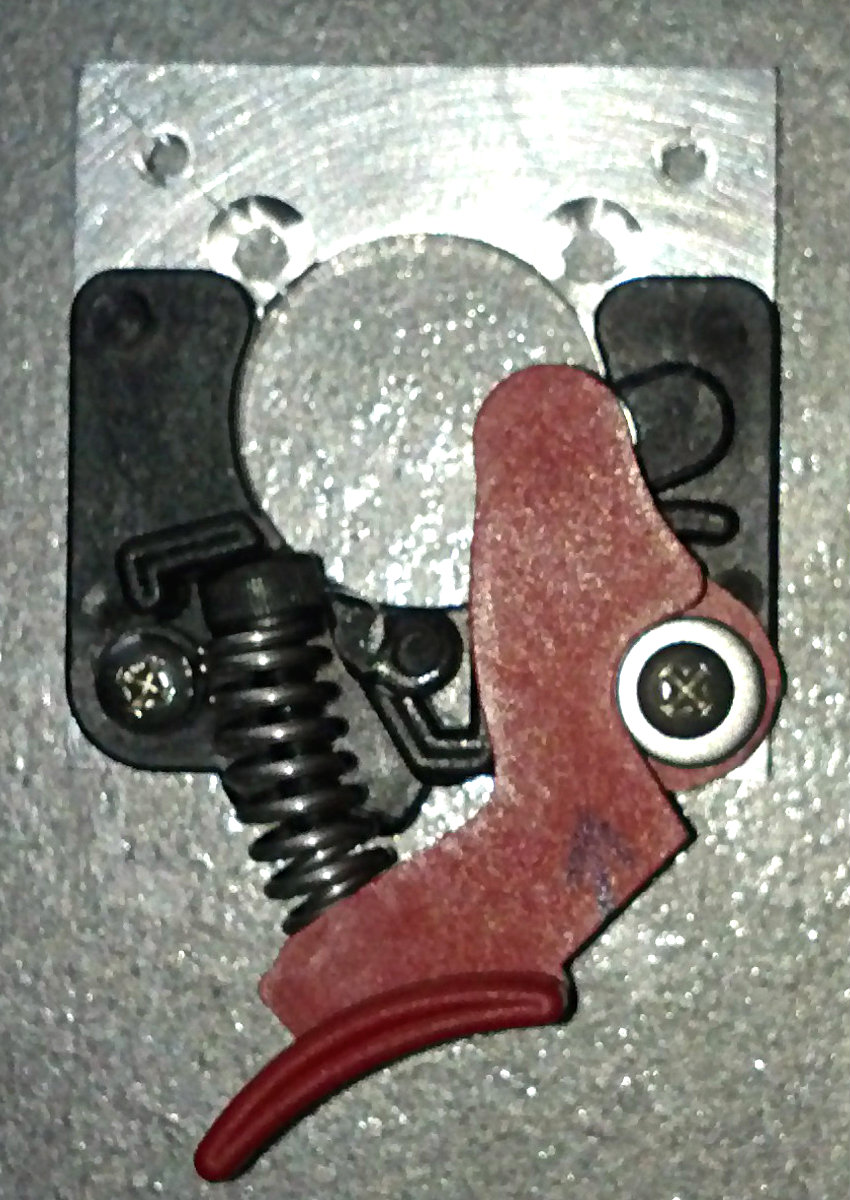

Mods/upgrades that will help the ezStruder push filament more reliably, particularly when running smaller than stock .5 nozzle ...
1. Add a M4 x 10 socket head cap screw to the spring to increase spring pressure. See photos.
2. Trim off the height of pivot boss for the red lever so it can not twist to the side. About .010" - .015" is all it needs, just so boss is flush with lever.
3. Replace the washer under the pivot screw with a larger diameter to help stabilize the lever.

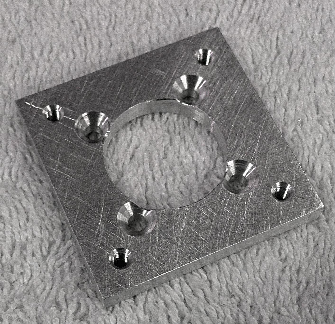

4. Replace stock stepper motor with a Kysan #1040222 5:1 geared stepper motor to increase torque. http://www.3dmakerworld.com/store/parts ... pper-motor
You will need to make or print an adapter plate for the geared stepper. Here is a printable one https://www.thingiverse.com/thing:131310
I machined mine from aluminum
The stock stepper has 76 oz-in of torque, the geared one has 125 oz-in
Note: the geared motor has a 8mm dia. shaft, stock motor is 5mm. So you will need to bore out the stock roller or get another one.
They are a bit hard to find with 8mm hole, see posts below for some sources. I carefully bore out the stock roller on my lathe.

See the attached photos to hopefully clarify things.
Hope this helps somebody.
