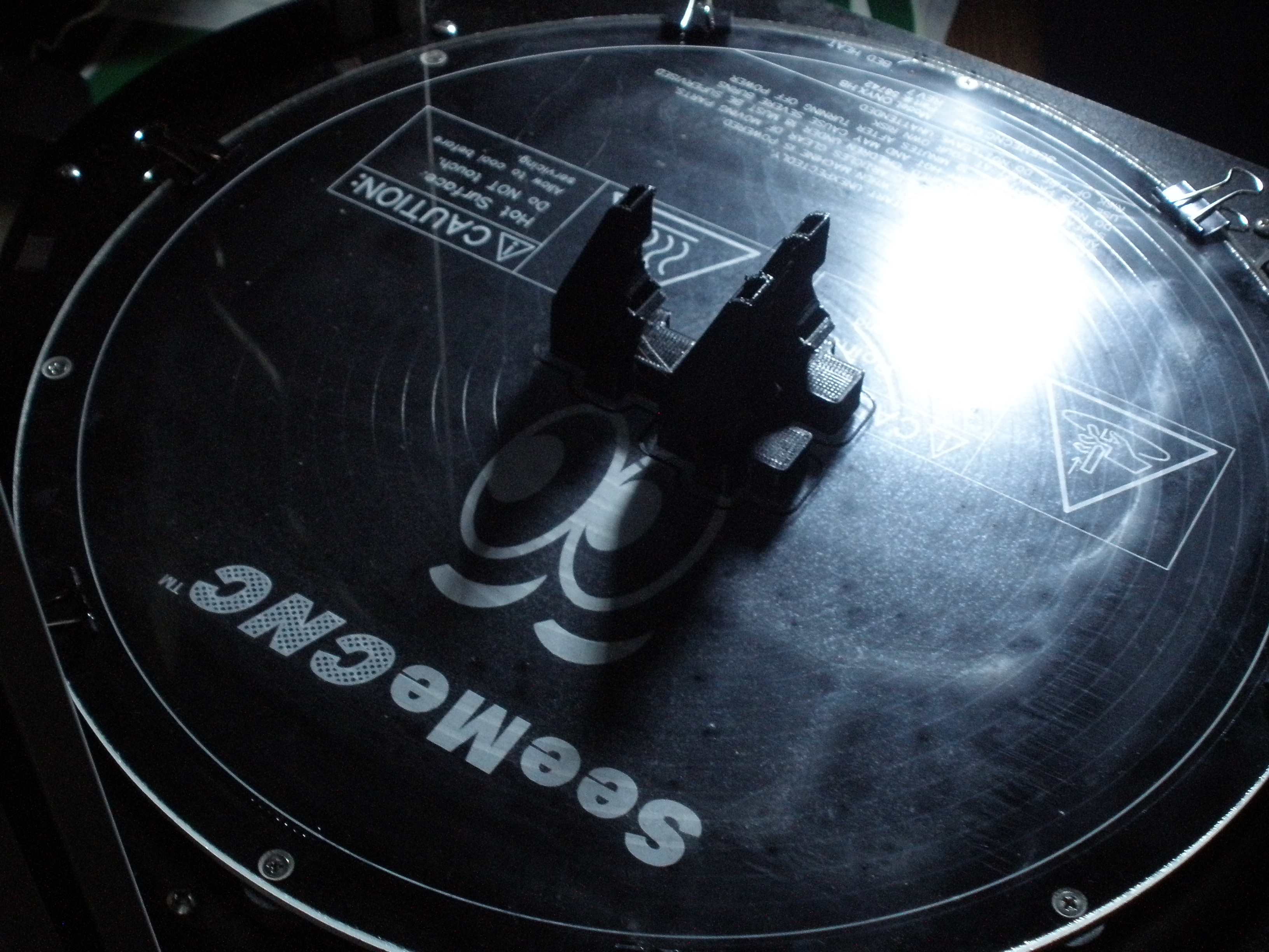

Well, finally got time to finish this up. It's currently printing the PEEK fan shroud.
I have the bed set to 90 and the nozzle to 228. I notice the nozzle is running consistently high, about 232 up to 234. The bed is holding pretty close to 90. Of course the funky PID is jumping all over the place.
I was going to check my extruder steps but with the nozzle at temperature telling it to extrude 100mm would result in a fairly short piece that would ooze to about 50mm. But, the print looks fine so far so maybe it has to get worked in? ???
jdurand
Posts: 397
Re: Waiting for delivery
Post by jdurand »
First print done. While not perfect it looks decent, I was getting worried with people's first print problems. :)
The nozzle temperature ran high the whole time, while waiting for the print to finish I poked around the extruder.cpp file some. At first glance their calculations seem simple which leads me to believe the PID routine is either getting noisy data or more likely isn't being polled at EXACTLY 100mS intervals. If the interval changes from poll to poll, the calculations will be crap. I have no idea how the OS on Arduios works, for something like temperature control I'd expect no more that microseconds to no more than 1 mS jitter from poll to poll.
I'll probably do my own routine and if it works a lot better (couldn't be worse) I'll post it here.
Pictures of first print attached. At least I can make some prototype parts with this until I get it tuned in.
