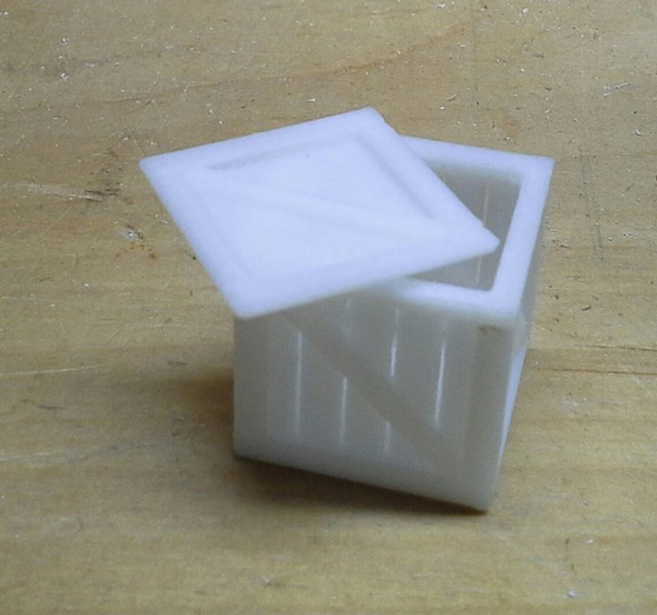

Hmm... here's what I mean here. This is a box I made with a removable top. Using this Thingiverse file:
http://www.thingiverse.com/thing:144255
The edges are pretty sharp. Lid fits nice. Wasn't really a lot of clean up needed. Of course it's white ABS plastic so it;s hard to get a nice shot of it. But that's what I mean but the corners.

Im not really seeing it.  How big is the box you printed? Maybe it is just optical? The cube im printing is 1" square.

This is about 1 and a quarter squared. Not that much bigger.

Box on thingiverse is 40mm so that would be 1.575"  unless you scaled it down some.   Thats a pretty big difference in scale.
Think of this, your extruder pumps out an extrusion from a round hole, lets say your extrusion width is .45mm, that would make your corners have a .225mm radius to them theres just no way around it. Even if your extruder only put out a single dot, it would still be round.

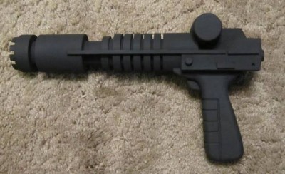

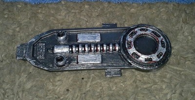

This is the item I want to make. The ultimate goal. I made this example out of wood to show it and had intentions of casting it. After several attempts, I just couldn't get casting to work. I played around with it for about 5 years now. I figure now 3D printing might bring it to a reality. If I can get a pretty nice print from a printer, I can assemble it and do whatever I need to do to smooth it out the rest of the way. Spray paint alone does a decent job on my 200 micron prints. I figured if I could get 50 microns, it shouldn't be too bad at all. Of course the Rostock is suppose to give even better than that right? Isn't it at 20 or 25?

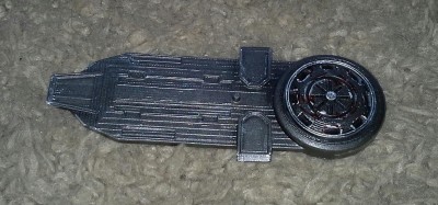

As far as the detailing I meant on the top and bottom of a print, here's a hoverboard I made that shows a good example of what I get now. It is painted and some of the lines are covered, but it comes out solid with no gaps and no fudging with the software.

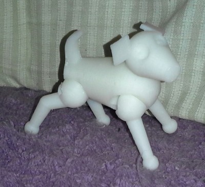

Then going back on the corners. Here's something else I did from a Thingiverse file. The dog's ears while yeah the corners are not 90% angles, it's pretty sharp. I guess that's what I was saying is based on that cube printed, can the corners get more sharper than that? Does the Rostock give within the look of this dog's ears.
