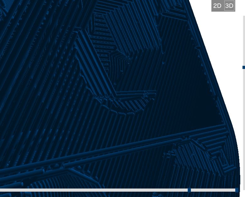

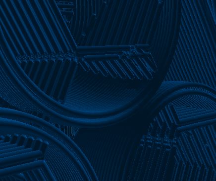

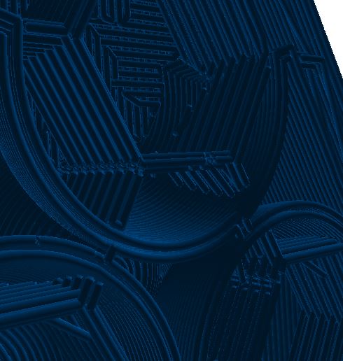

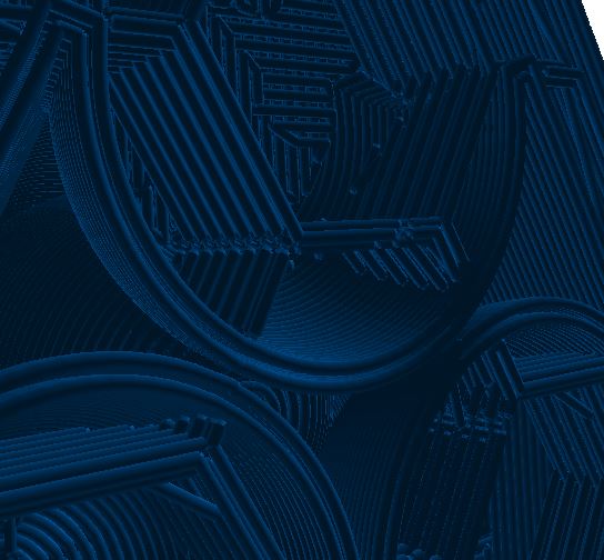

Slicr3 printed from SD fine, really moved along nice and fast with a nice surface finish...but started putting infill into holes that should go through the part.
I had scanned it with the viewer and didn't see that, but probably skipped over there.
Here's the sequence of events, there's ok, a layer later when it starts to join nearby objects (not a problem in itself), later when it stops joining the objects, then one layer later when it's covered almost everything with a floor.
Problem
Problem
Stopped joining, one layer before joining
Starts joining objects
Just before the problem
jdurand
Posts: 397
Re: Funny software/firmware things going on
Post by jdurand »
I got a S3D license and the excellent visualization feature helped me sort out this problem to where it shows it can print this without errors. I've got it running at medium speed and while I started it a couple of hours after the Afinina started one of these same things, it's already well past where the Afinia is. I'm going to like this! :)
