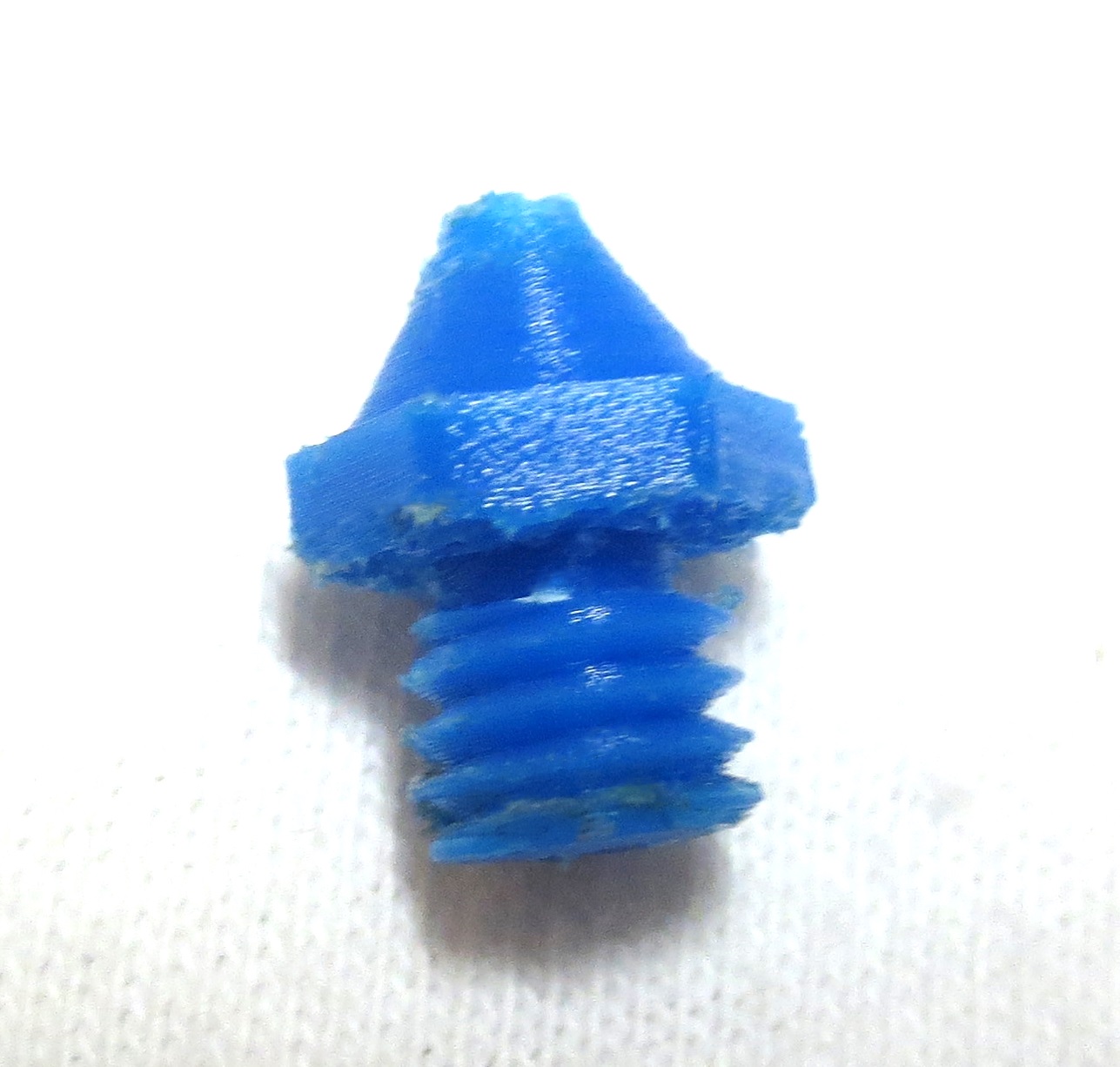

A lot of the stuff I do is cylindrical and threaded. I recommend using a tiny nozzle (0.25mm) for threads, especially if they have high overhang angles, like acme. I've gone as small as M6 6mm threads with a small nozzle. Make sure you go slow, and nylon works the best by far. Under-extruding slightly will help your print quality too.
Here's one I did last August, its a model of a nozzle.
[img]http://forum.seemecnc.com/download/file.php?id=5991[/img]

I figured the nozzle is a little too big for this type of work.  It's nice to know that a smaller nozzle will tighten it up a bit.  It would probably work for larger diameter screws.
I didn't get the machine to do this; I'm just interested to know its limitations.

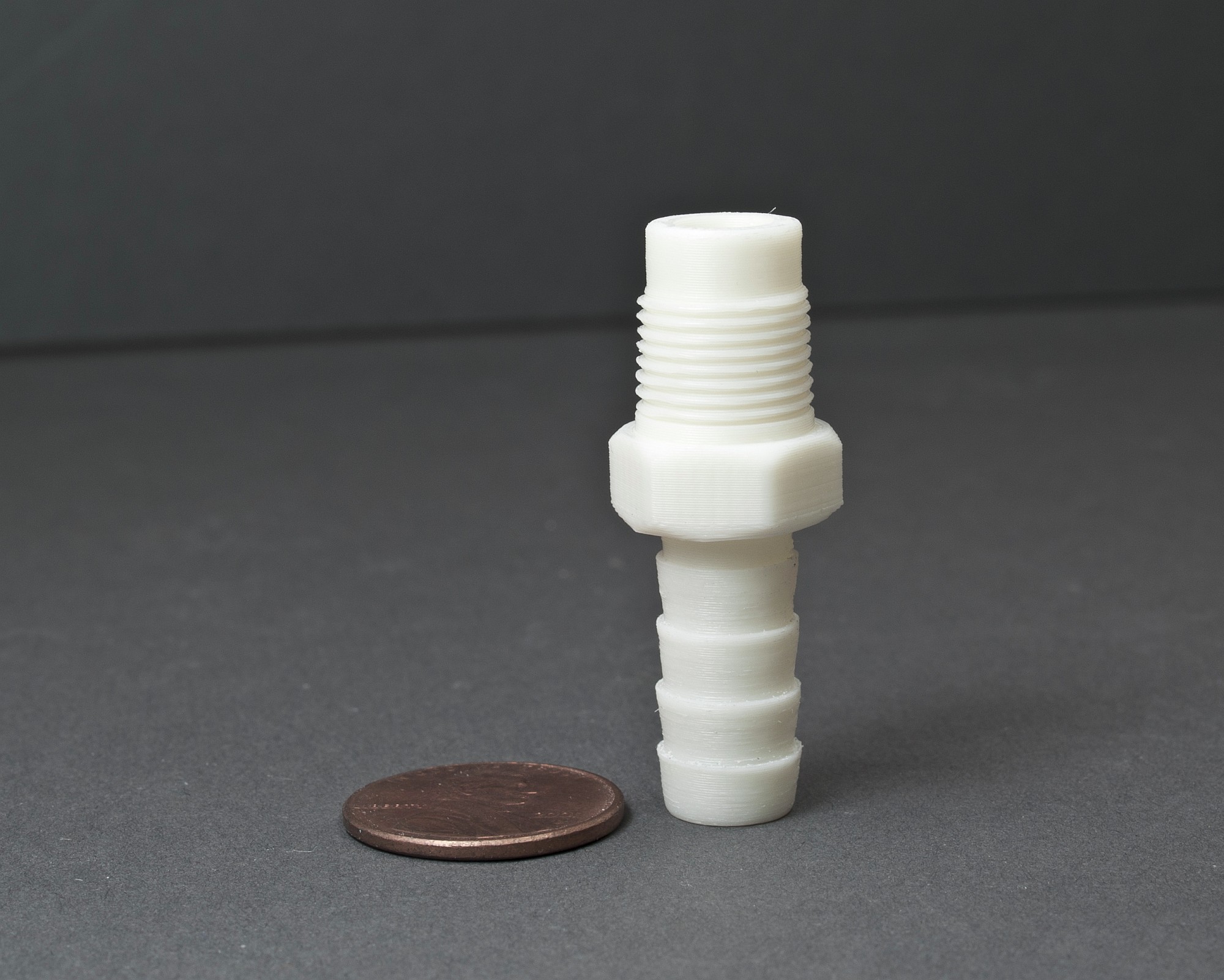

Here's one I just printed this morning. 12mm-1.0 tapered thread x 9.5mm barb. Threads look a little rough in the picture but screwed in perfectly to the metal female thread. ABS and sliced with S3D.
						Re: Is anyone making screws?
Nicely done. What is your layer height? Minimum layer time?heathenx wrote:Here's one I just printed this morning. 12mm-1.0 tapered thread x 9.5mm barb. Threads look a little rough in the picture but screwed in perfectly to the metal female thread. ABS and sliced with S3D.
My layer height on that one was .17mm and printed at 30mm/s with the cooling fan (PLA) set to 50%.

Ha! Yup! Normally I never do that but on small parts like this it's sometimes beneficial to turn the layer fan on. You'll need good bed adhesion of course (I used hairspray on this job). I only had the fan set to 50% and I ran the job at 30mm/s. Nice and slow. An alternative to the layer fan would be to print two or three models instead of one. That would give each layer on each part time to cool before the next bead gets laid down. Keep the part close to minimize any stringing if that's an issue. We all have our tricks, right?dmcmd wrote:That's nice work. Just to clarify: you're printing in ABS, and you're using the layer fan?

I print ABS at 230°C and run by bed at 85-90°C.
