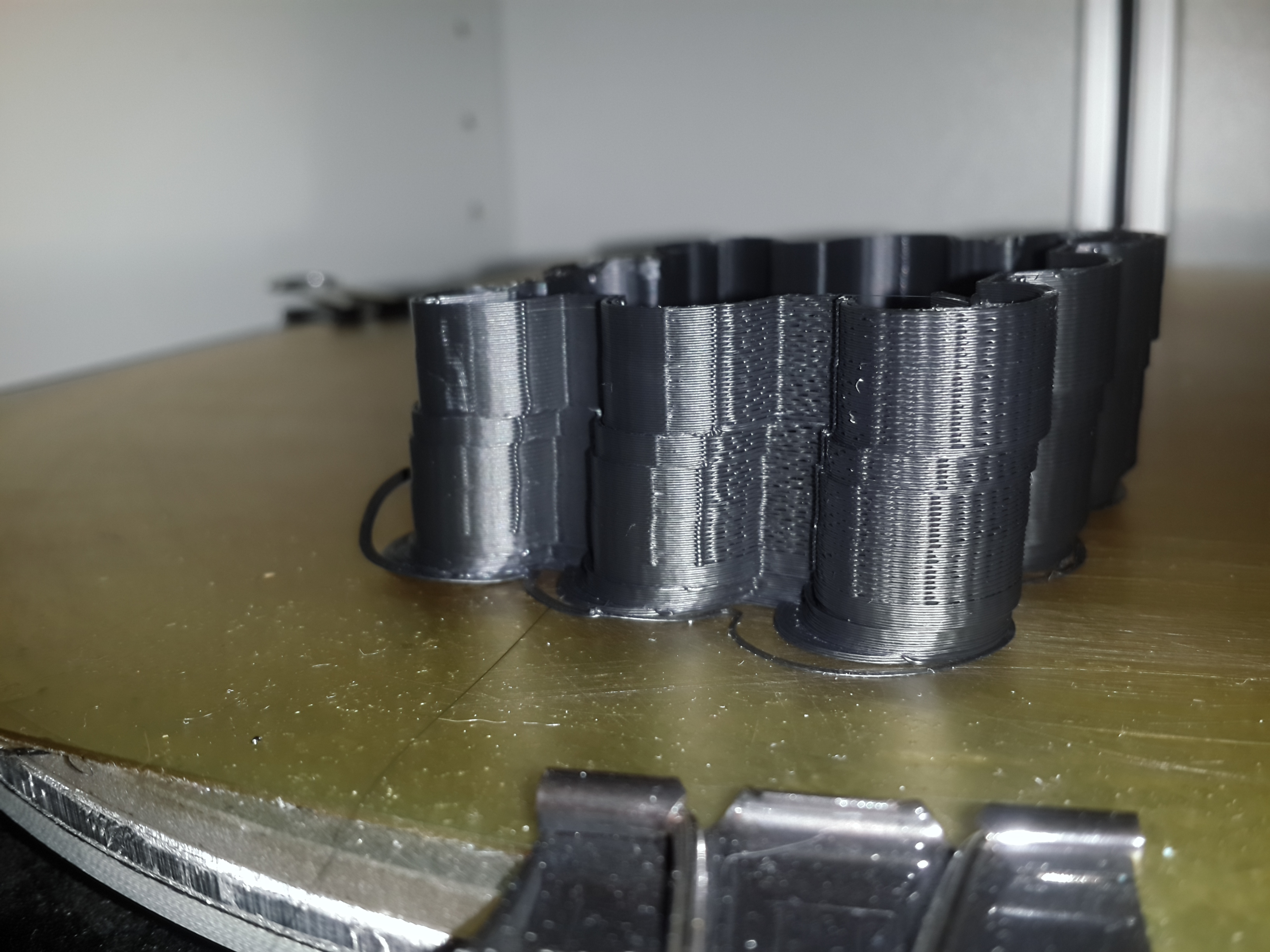

I have been having some trouble printing lately.
I have more or less diagnosed my problem to be my pulleys not holding tight anymore. However i would also like a second opinion.
The print starts off fine. But after the first few layers it shifts and it also seems like the hotend is trying to dig in to the print towards one corner. My Y tower motor seems to be getting a little bit hot aswell. It did not do this before.
I have recently fiddled with the 24V power supply, tightened my carriages (they were very lose), tightened my belts (trying to solve this problem).
Anyone has any opinions before i tear in to the machine to get at the pulleys?

Ok, I need help.
What I have checked:
1) I have examined the belts, there are no flat spots and all the teeth seem to be ok.
2) I checked the pulleys, I had marked them with nail polish and they had not shifted at all, while peeking at the pulley with a flashlight, i quickly moved the carriage up and down and they do not seem to be rotating on the motor shaft.
3) I have extensively fondled the carriages individually up and down and there does not seem to be a rough spot or anything bizzarre. If i move the carriages down very fast then i do get the belt jumping. But there is no way the carriages move so fast or with so much force.
4) I have extensively fondled the end effector and there does not seem to be a travesty.
5) Checked temperature of the motors, they do not seem to be overly hot.
6) Power supplies seem to be functioning normally and the printer keeps its temperatures perfectly.
7) When the big and wide print failed I tried different prints.
8) Tried slowing down to %60 percent speed.
9) Lowering the extrusion multiplier to %90.
While it is printing, the first few layers are as good as before, but then something happens and suddenly the nozzle moves way down, it continues printing and smashes through the part. I tried but could not yet catch the exact moment it happens, my eyes still burn from the LED light attached.
PS: My heatsinks had fallen off, so i will try again now. I shall also try to bundle up the wires on the hotend just in case.

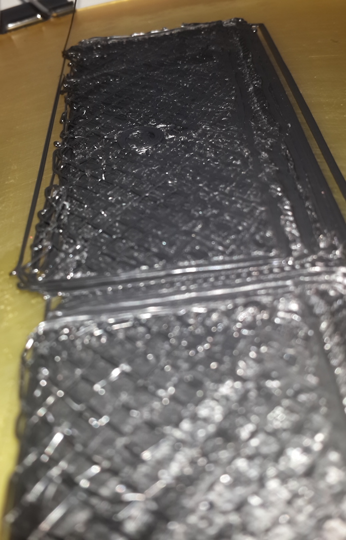

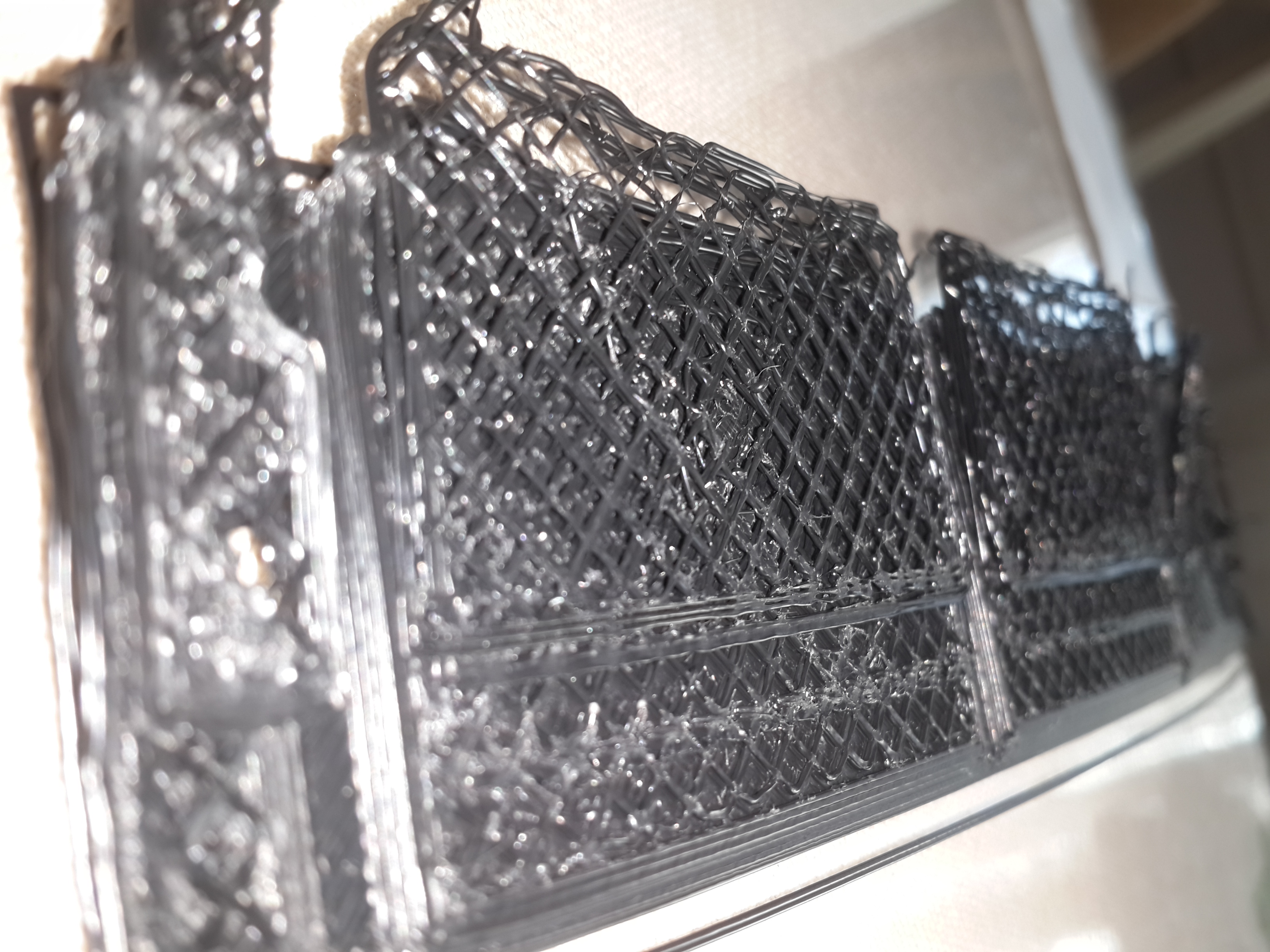

Well i had success with a very small print a couple of times but besides that it just keeps shifting.
Now i have a new symptom. Ater the first few layers it freezes.
The nozzle just stops where it is. The printer is still functionnal. It keeps temperatures regulated. The LCD works. I can home the printer.
I was thining it may be temerature related, but i doubt it is. It usually fails within 15-20 minutes. With the enclosure door open. It has printed for hours before. The fan cooling the rambo is a noctua fan.
I removed the usb cable (i print exclusively from the SD card) and I have tried a different sd card with the same results. I can only print 3 to 15 layers.
Any ideas?
Any ideas?

I still have the shift. Not sure how to get rid of it. I did get a couple of good parts printed. (small matchbox sized parts).
Re: My Steppers are skipping or the pulleys have come lose r
I have fiddled with it a little bit and recently it seems that it is not shifting anymore but it is just freezing. I have not idea what the problem is.
When it freezes the lcd is still operational.
I do have a new symptom, somethimes when i hit home, all the towers start going up, the X carriage stops half way untill the other carriages reach the top and then the X tower moves up very very slowly. It seems like a problem with the end stop signal from the X tower.
I have moved the ssr and the power cable a bit further away from the printer and i am trying again now.
