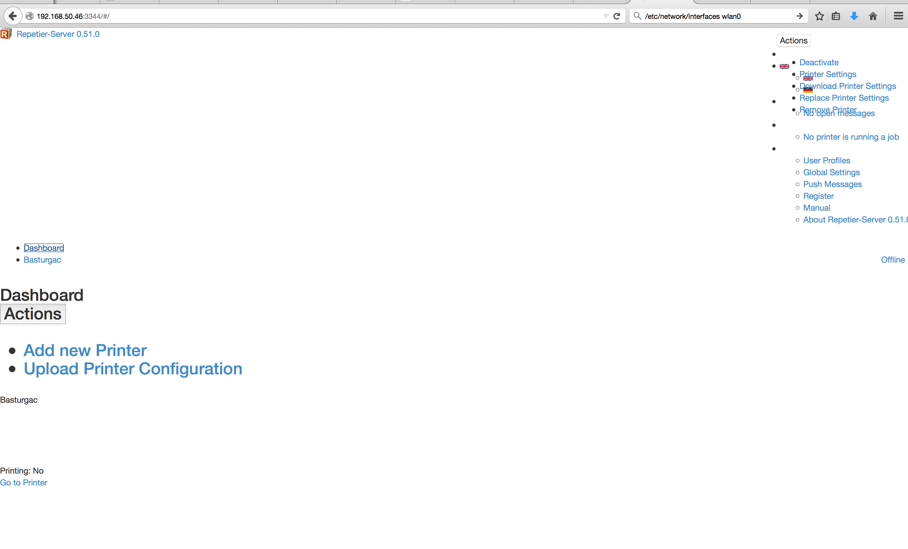

I just installed repetier-server on a banana pro. But for some reason the interface sucks. Not quite sure what is wrong.
I can connect to it on my local network. And it can do some changes but if the interface is going to be like this, I really prefer not to invest any time in it.
Also would you mind sharing your configuration file? Or does seemecnc have an official configuration file?
Thanks in advance.
EDIT: Never mind. I rebooted and it is looking good now. But I would still appreciate a config file.
